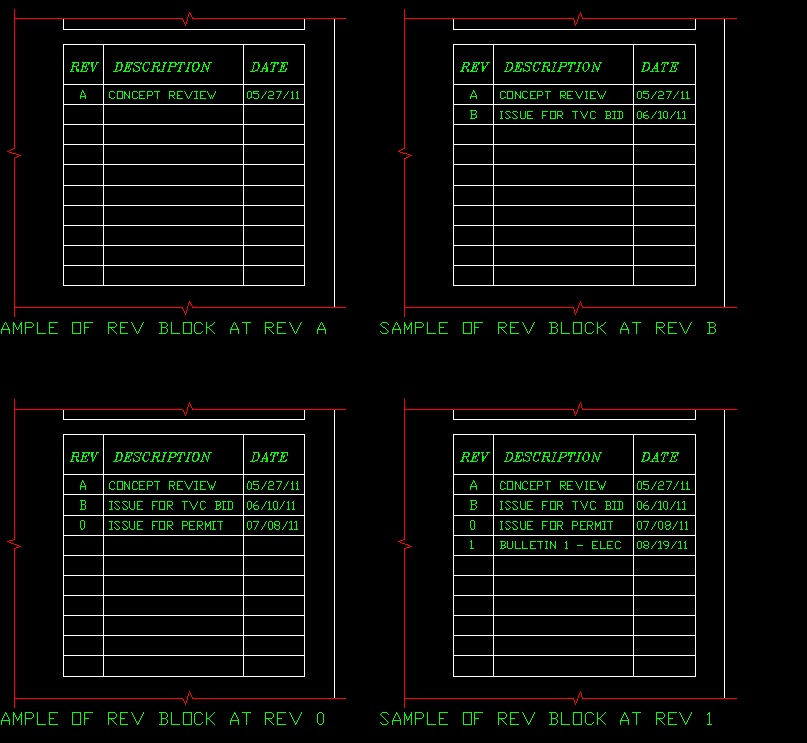

This may not be as easy to do as one may think. Our office is implimenting revit and there are some ways we use AutoCad that we would like to carry over to Revit. On AutoCad, for the revision description block, we use a seperate xref, all plain text.  Every time we issue project we just touch one file to update all our sheets (biggest set I've seen is 120 sheets). When we get addendums or change orders we explode the rev block and edit the text one the individual sheets. Is there a way to emulate this on Revit.  Using Revits sheet issue/revision function we would have to touch every sheet at every issuance, not acceptable. Using shared parameters wouldn't work because you can't "explode"  labels with shared parameters. I've attached a image sample of how it looks on our AutoCad sheets.
How do you project history on your revit drawings?

I don't understand.  You say you "...we explode the rev block and edit the text one the individual sheets."  So you touch every sheet?  yet you say "Using Revits sheet issue/revision function we would have to touch every sheet at every issuance, not acceptable."  That seems to be a contradiction.
If you just want a text based revision box that is the same on every sheet no matter what.... then just do it on your titleblock.

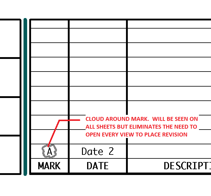

As WWhub said, if you want a revision on every sheet you will need to put a cloud on every sheet.  If you do not want to open every drawing and don't want a cloud on the plans/details you could encorporate it into your MARK on the title block then click on it, ctrl+C to copy, go to the MODIFY tab, click the Paste pulldown and select Align to Selected views and click the sheets that you want to see the revision on and hit OK.  There will be a cloud around your MARK number/letter but nowhere on the sheet so it would be somewhat of a workaround.  See the attached image, hope it helps explain what I mean.

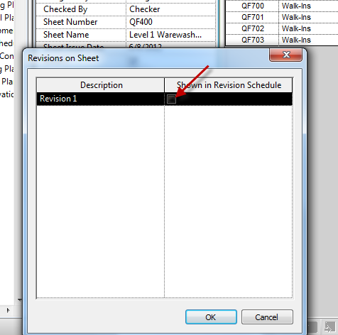

You no longer need a cloud on every sheet to make Revit fill out revision information, there is a button in the sheet properties called "Revisions on sheet" that will let you select which revisions you want shows, even if there is no cloud.

TKennedy- Yes you are correct that you do not NEED a revision cloud on each sheet but in order to  reach the sheet properties and the "Revisions on sheet" selection you would need to open EVERY sheet and switch that property and that is what I believe david125 is trying to avoid.  Unless there is an apply to all option that I am not aware of.

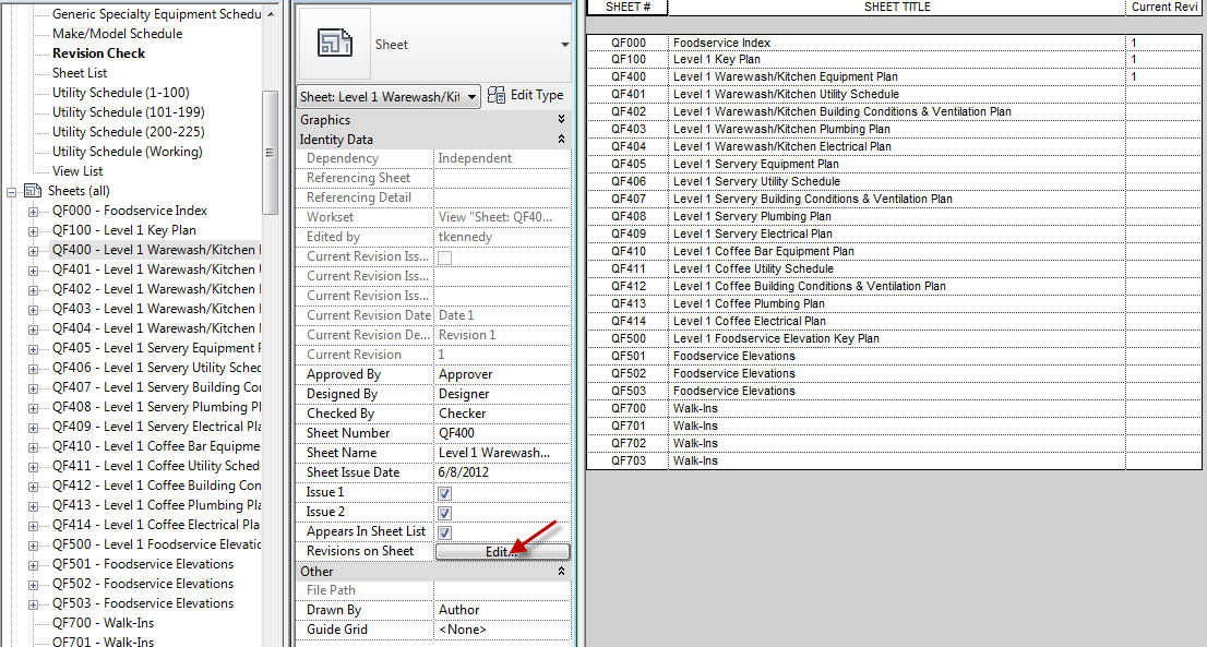

Ok, I see what you're getting at. No, there's no way to do multiple sheets at once that I know of, but you can move through sheets fairly quickly once you get a system down. There is no need to actually open the sheets, you can just select them in the project browser and get to the sheet properties. It's still a sheet-by-sheet process, but I still prefer doing it that way than using rev clouds. It seems neater.

Yes, it is a pain, but as I said you can move through the process fairly quickly. What I do is set up a sheet list with
parameters for Sheet #, sheet name and current revision. The current revision has to be set to numeric or alphabetic
in the revision manager, you can change it temporarily if you don't need it to be none. Just be sure to change it back when you are done. I set my project browser and properties windows side by side so I can quickly cycle between them. When the Revisions on sheet window opens up, I move it so that the check box I need to click is right over the Revs on sheet button, so it's a quick double-click|enter instead of searching for the check box. I keep the sheet list (I name it Rev Check) open so I can see if I missed a sheet. I've attached a couple of screenshots of what my screen looks like when I'm doing this.
Again, WWHub and teafoe5's method of copying rev clouds is faster, but I prefer this method.
