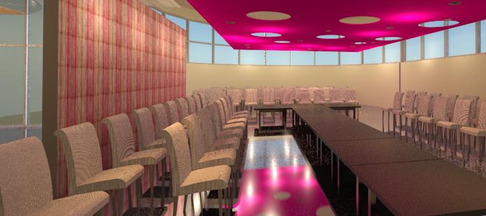

I'm finishing my space and I did the test rendering...looks like there is a reflection of the windows and some wall on the floor. I thought I made the floor shiny by mistake, but i checked the material and it's carpet. Why do I get the reflection?? Too many lighting fixtures?

you mean two different flooring materials? the first rendering i did looks fine. i had concrete flooring in my lobby area and it rendered ok. in the area im showing you i have carpet, now changed to wood. whatever area i render, it showes me the mirror reflection of the upper side (ceiling, windows, walls etc). im attaching the first pic.

Hey--I think it looks awesome like that.  Very 2001 A Space Odyssey.
But check your material settings.  There is a slider bar called "Glossiness".  Make sure it's set to zero.   It's independent from "reflectivity" but does the same thing.  Makes sense, huh?  If you do NOT have a materials option bar like this.... well... make/alter an existing "Miscellaneous" material to be your carpet.  You get more options with miscellaneous materials.

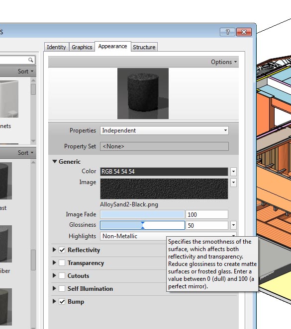

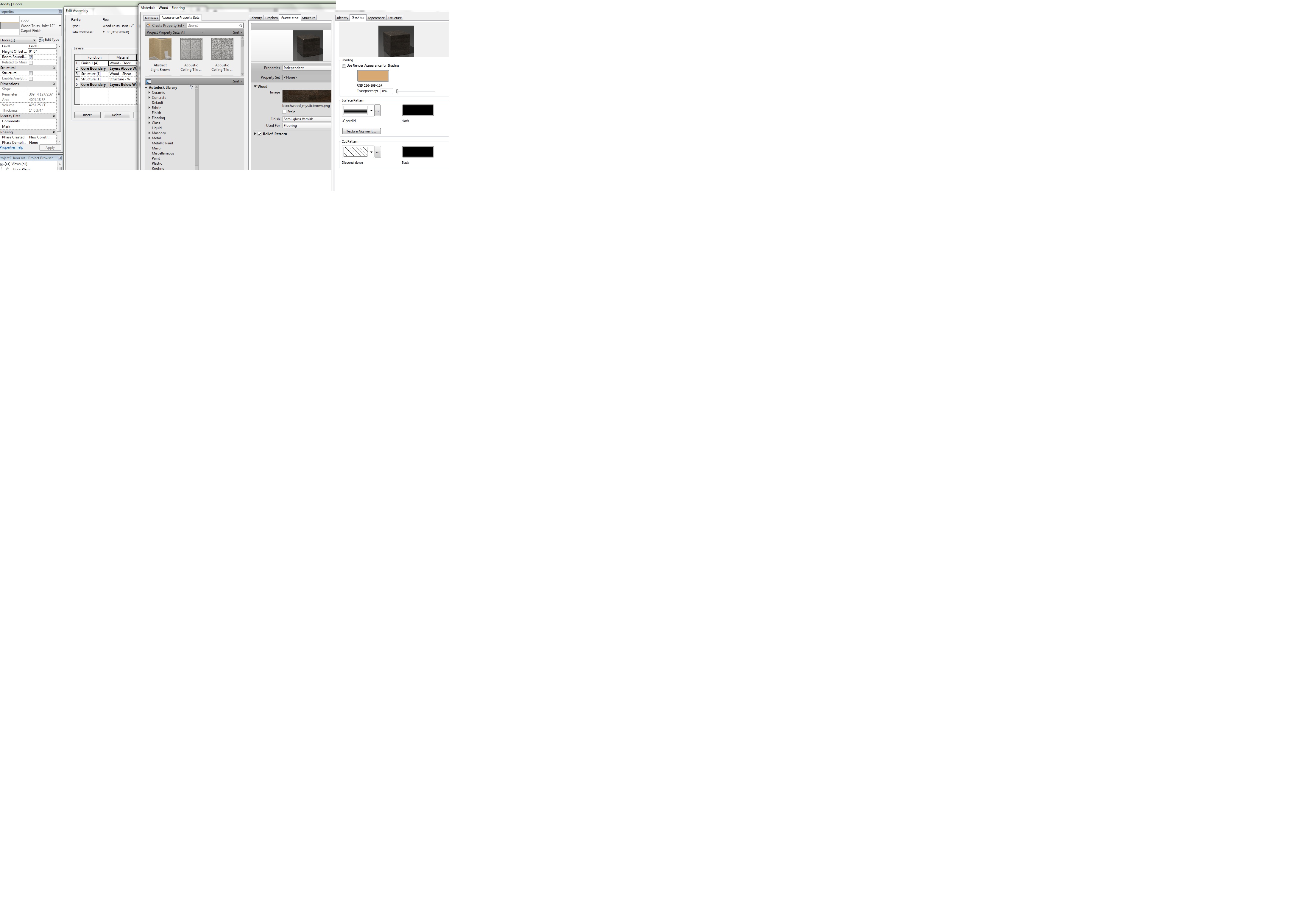

Here is the print screen of the properties of the flooring - i changed it to wood now.
Mon, May 21, 2012 at 3:03:20 PM | Rendereing
#11
That is a semi-gloss so it will be reflective.

so what do i change it to??

"unfinished" should be an option for wood.

unfortunately (or infuriatingly, at least,) everything has an explanation.   I've only written a little handful of things off to bugs.
It'll have to be a process of elimination to figure out what's wrong with your floor I'm afraid.  I would start by changing it to a material you KNOW is not glossy, and go from there.  Best of luck.
