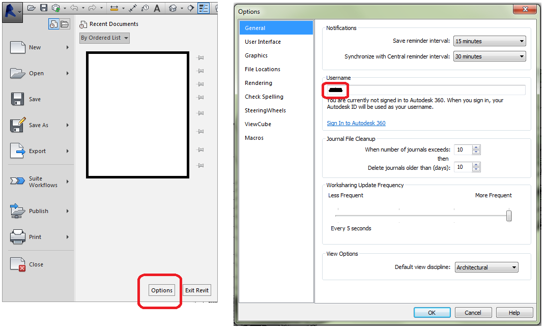

i was working in a file, when there came an issue with IT, and username corruption, our IT engineer formatted PC and changed my username.
it is about 2 months now. i started working by taking new local copy of central file. but now i was trying to delete unnecessary views to reduce file size, it tells not possible until my old username has to save file and to relinquish.
what i can do now?
Tue, Aug 30, 2016 at 6:59:15 AM | What's the difference between Unloading a Linked Revit File and Removing?
#9
The best answer is to open the file detached and create a new central.
But you raise a question that often comes up for different reasons.   Sometimes the above process just can't be done.   Maybe the user was out of the office because of an illness and owned some worksets.  You don't want everyone doing this...only I did it typically in my office.  You can start Revit and change your username to the problem name.   Now you can open the file and save to central with "relinquish all mine."  Next AND YOU MUST DO THIS - you close Revit, open Revit then change your username back to yours and you are ready to go.
ALWAYS make sure the offending user knows what happened so thsy don't try to save to central and possibly mess things up.

marmiketin1
Joined: Wed, Aug 19, 2015
0 Posts
4.5 Stars: 10 Votes
A little tip. You can change your username for revit under options > username. You can change it to anything or another users name and then relinquish anything they might be controlling and then change back to your username and you will be good to go. For this to work correctly you have to do this change before you open your project.
Open revit. change username. open project. relinquish. save and close project. change username back. open project again.
