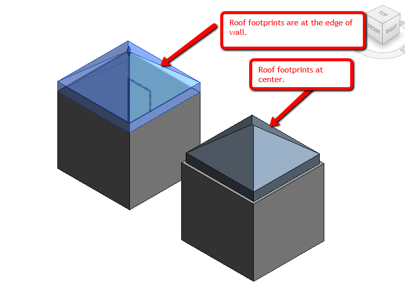

Hey guys been playing around with this for a while now and I'm not sure how to fix it. as you can see from the pictures.
When I choose extend to core (so my roof pitches from the stud wall and not the brick) it works fine for the house but
when I try do extend to core on the garage walls (single / Double brick) there is a problem and either it doesnt cover all the
brick or it puts it at a different level from the house roof. Is it something I change in wall structure?
Thanks.

Bring your your outline to the exterior face of your wall.

This is what I mean. You can create a level and just attached the top of wall to that level if in case your wall does not attached to the roof.

You have to attach the walls to the roof. The one on the right is attached and the one on the left is not.

It wont allow me to attach the walls to roof as it looks like the "right" one in the picture.
If I just draw a line around the edge then it does work fine...but in section it is wrong and will pitch off the brick work
and not the stud wall like it is ment to. Thats why I need to extend to core so the section is correct

The core will extend to the roof if you attach the walls to the roof. I'm not sure if the image I uploaded was visible in my last post.

yeh that worked. I did entend to core then allined the lines with the outside of the walls. But still a problem with the roof
line. As there is a garage with single brick and piers im guessing that is the problem. I will attach some pic links for you
to look at. Also you pic didnt load. I use Jing.
