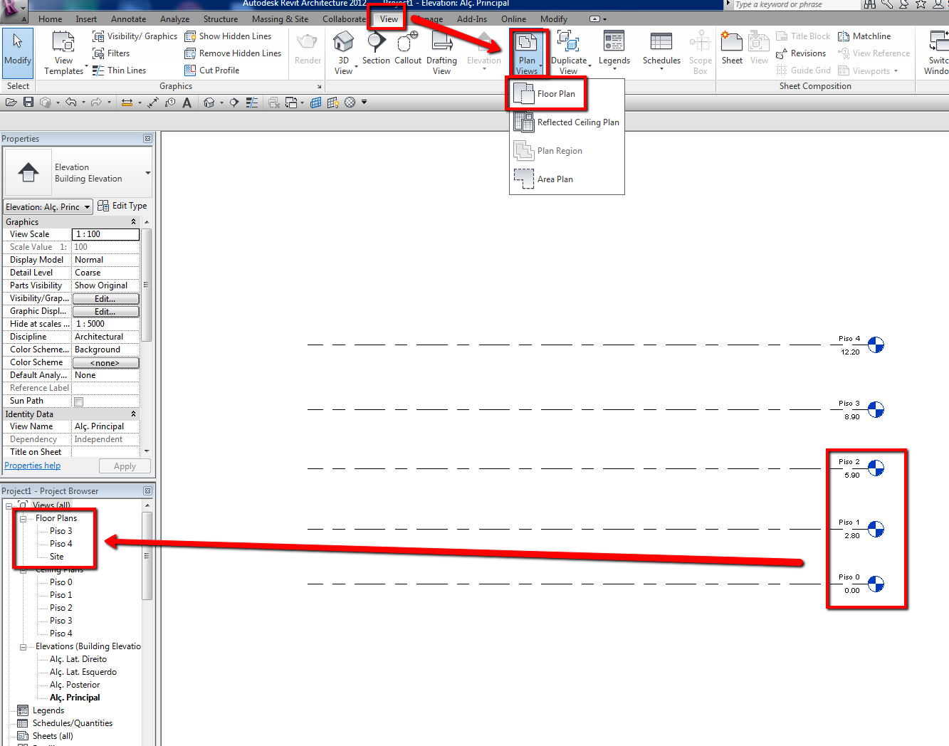

Hello,
My Levels are visually missing from my project.  I have checked each view in the project and verified my crop view extents, my VG settings, revealed hidden elements, and have searched this forum for a solution - but I'm still lost.
In an Elevation view I can insert new levels and they appear, but the existing (4) levels never appear.
Any advice?
Thank you.

You don't have those plan views in your project browser?
Go to View > Plan Views > Floor Plan

I am following up with this post: WWHub's advice to cut a section across the entire model space worked.  The building elements and families must have been moved (by another) from the original position.  I had to cut a series of sections out in "space" on the site plan view once I estimated the original location.  Finally a section revealed my datum lines!  I can now adjust my floor/roof heights - and of course finish the set for permit.

I just had the same problem, and not even propagate extents worked. I did a huge diagonal section until the level reappeared, as WWHub said. Then extended the level line.
Thanks for the post!
