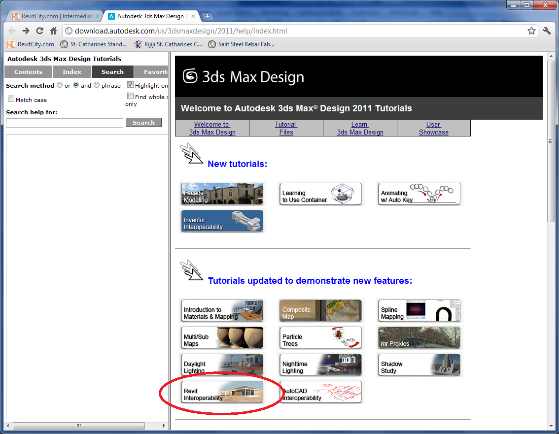

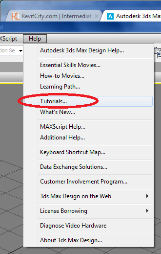

3DS max has some pretty good tutorials which may help

^ Well I'll be
Thanks
