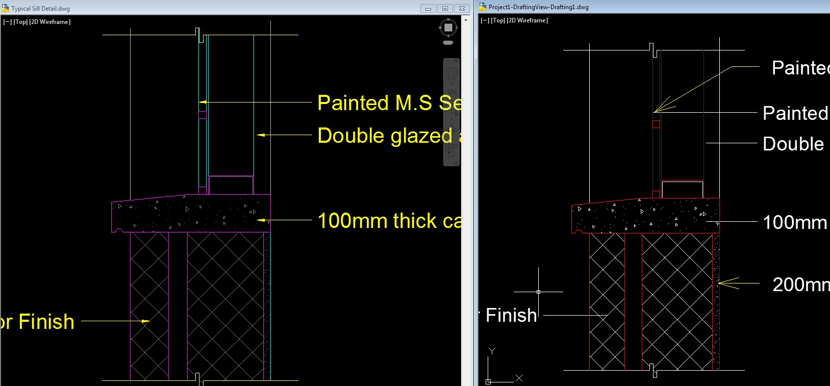

Hi, with a rather long history of this thread i still have confusion. I know how to link cad details to revit and i know how to export and control the colors of exported dwg files from Revit.
What i do not know is that how to control the colors of linked cad details, when exporting back to CAD from REVIT.
On the left is the original cad detail, on the right the exported cad detail from Revit opened in CAD. The dwg/dxf export settings grays out linked cad file's layers so i can not control it from there, there must be some other way of doing it. Any help?
