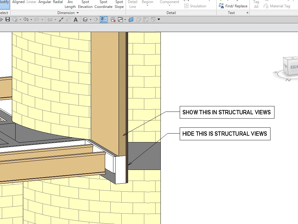

I use Revit 2011 for architectural and structual plans combined in the same Revit file. No linked structurals because I do them all in house.
Is it possible to have architectural wall layers and structural wall layers, and only have the structural wall layers shown in structural views?
please see example attached.

The only way I know to do this is to have seperate wall types where the architectural does not include the structure.

Thanks that was the conclusion I came to as well.
I guess I'll have to do seperate wall type, then join them so the openings are coordinated. Lots of work.

I'm not sure why it isn't already a function. When you build compound walls/roofs/floors you can set the layers to structure, substrate, finish, etc. under the function.
All Autodesk would have to do is associate these layers with the view discipline setting of architectural, structural, etc.
As it is, what are the wall layer function designations used for?
Another clunky fix would be to be able to select wall layers individually and "hide in view" them.

The basic strategy would involve using a single architectural model to generate the structural model.  The structural model would be linked into the architectural model giving you more control over architectural/structural visibilities.
The copy/monitor function, as far as i know, is used to copy elements out of one model and paste them into another.  Each element that is monitored will track changes as the files are updated.  So when the Architectural file is modified, the Strucutral model receives notification (and PLEASE CORRECT ME IF I AM WRONG, the option to accept changes.)  This does not work well if you are adding to the model, since you would have to re-create these elements each time.  An ideal situation would be that the Architectural model is completely finished before copy/monitored to a structural model with only minor modifications to follow.

Not sure if this is mentioned or not, I didn't read all the threads but what about using worksets
put your Arch walls one workset and your Stru walls stuff on different workset and control the visibility via your work sets.

Yesterday I took one of my projects and divided each exterior wall into a two separate walls: a structural core and an architectural fascade. I then joined and locked the two together.

There are other option too, if you are the only one working on this file, you could use phases, filters, workset or design options.
each you can control your visibilty, may not be the standard or desired way for some but if it gets you what you need.  They are only tools to accomplish a task so use them.  In a big firm we have to conform to a standard to keep things well "standard" but if you are a one man show and you are in control of the whole thing, I guess you can do what ever you like, right?
Before diving into worksets, checkout filters, I just created a stru filter and an arch filter, used Type name to filter by and called one wall (Stru_wall name) and the other (Arch_wall name) and I can control each by filters and this does not create a central file.

 On second thought, I don't believe that worksets will allow you to control visibility of layers in the same wall anyways will they?
The thread is about that particular problem: there are structural layers and architectural layers within the same wall. If there are separate walls, then you simply use the view type (structural, architectural, coordination, etc) to control visibility.
Yesterday I tried view filters. I created a parameter that I assigned to the materials themselves & tried to filter "structural materials" from "non-structural materials". But unfortunately it only hid entire wall, not layers of walls.
