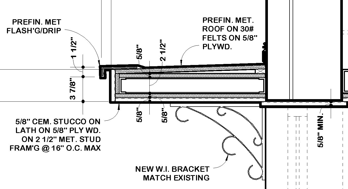

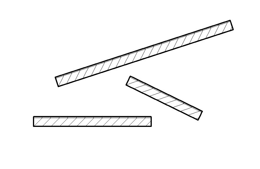

I have been through about every vertical plywood hatch pattern thread here, but my problem still exists.  I need a ply wd. hatch pat. that will stay oriented with my detail component and will show more than just one layer of plywood horizontal lines.  When I change my existing hatch pat. into a model pat it stays aligned with my detail component as needed, but I don't see more than one layer in the ply wd. (see attached image). I want to be able to see at least three layers in the ply wd. @ 3/4" = 1'-0" scale.  I tired importing the .pat file to be smaller, but model patterns will not let me import scale less than 11.  Its always says "too dense."
 Any help on this matter would be much appreciated.

I've looked at the plywood component that comes with Revit and there is something amiss. The fill pattern used to hatch the detail component (Plywood - Align) is supposed to stay aligned with the element. There is a setting for this in the Pattern Properties. The choices are "Orient to view", "Keep readable" and "align with element".
It looks like something isn't working quite right or hasn't been setup properly. I've noticed this before but have never looked into much. There is probably a way to fix this but I'm not sure right now.

What about the align plywood (drafting) fill pattern?  Why doesn't it align with element like it should when the settings for "align with element" are selected?

Drafting patterns do not align with elements. Model patterns do and can also be rotated and dragged to suit their location.
Try this model pattern which is designed to be imported to Revit at scale 1 to 1 :

Revit has placed upper and lower bounds on hatch pattern element sizes which limit the degree that patterns may be scaled. This pattern is fairly intense as it's at the small end but at least it avoids the Revit's somewhat arbitary limitations.
(Use the pattern in the attached file rather than cutting and pasting the above.)

That detail looks great .... except ... the discussion was plywood hatch at 3/4" scale.  I used the pattern that was posted.  Below is a screen shot of what you see on the revit screen (a black mass) and what you get when plotted...an empty rectangle.
As I posted..... This pattern should not be used at 3/4" scale.

When I printed the detail out on a printer (3/4"Winking and looked at the ply wd. detailing it is small, but clear to see.  it adds a certain quality that my advisors must see or they are not happy.  they are very hard to work for... trust me. I feel like i need a expansion pack just for graphic detailing in revit sometimes.
