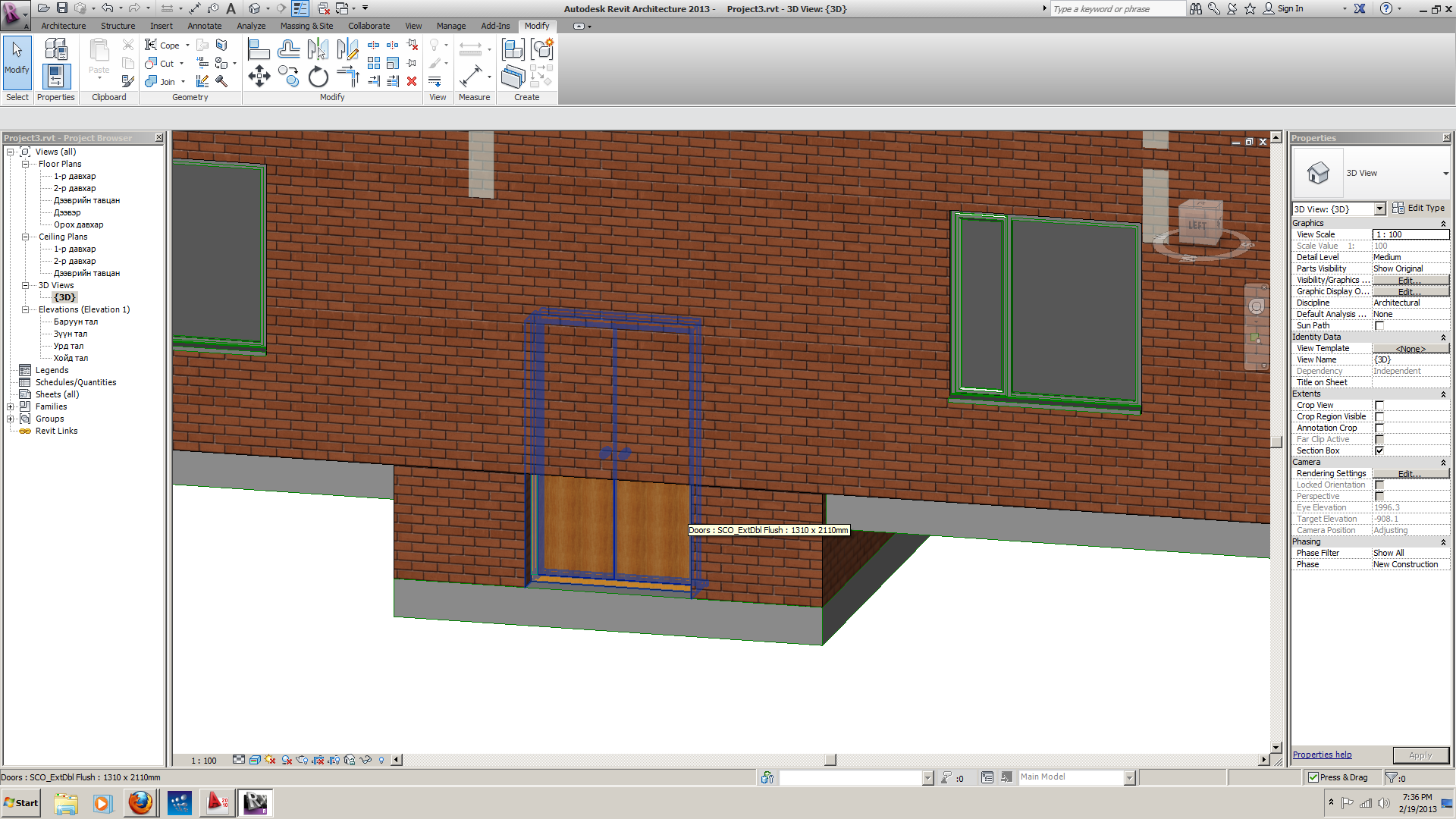

Hello everyone
Im having problem with the door and i couldn see half of it. i think it s because i couldnt join that 2 walls...
Please help me...
/sorry about my english/
Tue, Feb 19, 2013 at 7:27:07 AM | Can you Merge Walls?
#12
Join the lower wall to the upper wall and the door will cut it.
Tue, Feb 19, 2013 at 8:45:02 AM | Can you Merge Walls?
#13
Redg
Joined: Wed, Jul 11, 2012
5 Posts
Im a begginer in revit.
I think join command is not working for some reason, and attach to the top also.
Tue, Feb 19, 2013 at 9:06:30 AM | Can you Merge Walls?
#14
Copy the file, delete everything except those two walls and the door.  Purge all then uploade.  Include which issue of Revit.
Tue, Feb 19, 2013 at 9:16:42 AM | Can you Merge Walls?
#15
Redg
5 Posts
im at home now. will try tommorrow...
thank you for your reply WWHub
