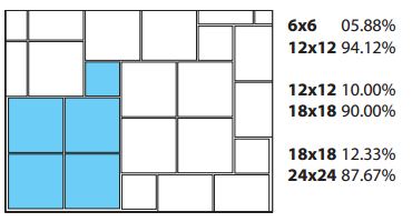

I love your hatch 22 program, but how can I make a hatch that has an overlapping repeat: (see attached) ?
Thu, Mar 22, 2012 at 1:08:27 PM | hatch22 - my revit hatch generator
mertens3d
Joined: Mon, Jul 6, 2009
22 Posts
5 Stars: 2 Votes
you have to figure out where the pattern repeats cleanly in both the x and y direction.
See the attached image. It looks like it's where I have it marked in red. Base your pattern off of that.

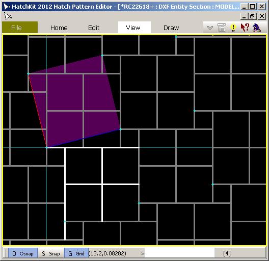

Here's a pattern for the above tile arangement consisting of four lines:
;%VERSION=3.0
;%UNITS=INCH
*RC22618,DXF Entity Section
;%TYPE=MODEL;-------------------------------------------------------------------------------
;        Pattern written by HatchKit v2.7 Hatch Pattern Editor
;        HatchKit v2.7 Hatch Pattern Editor(c) Cadro Pty Ltd 1990-2012.
;        www.cadro.com.au/hatchkit/
0,0,2,4,1,4,-13
90,2,0,4,1,4,-13
-90,0,4,4,1,5,-12
0,-1,4,4,1,5,-12

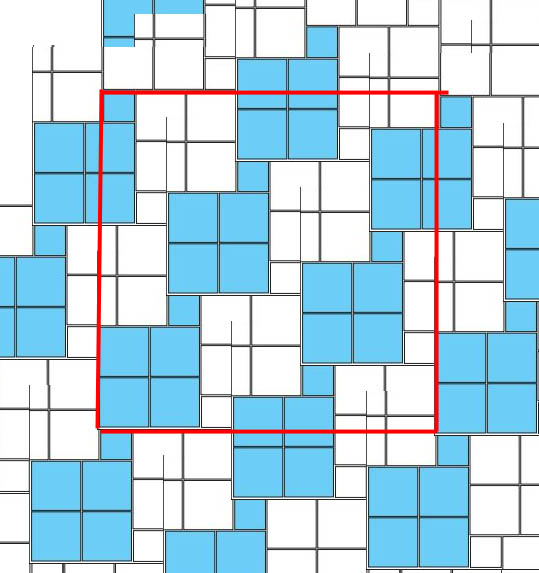

arranged as is shown in the attached picture taken from a forthcoming HatchKit. To use repetitions constrained to the X and Y axes as shown above you would need to define the 100 or so lines in the 9x9 square shown in the second picture.
To arrange the pattern discussed this thread from JLink
http://www.revitcity.com/forums.php?action=viewthread&thread_id=26963
you would need to define about 440 lines in a 29x29 square as shown in the third picture. HatchKit defines the same pattern in 14 lines.
Really big patterns may overburden Revit by their size and recomputation but I've not seen much difference until linecounts reach the absurd. The effort required to set them up in the first place may be an issue.

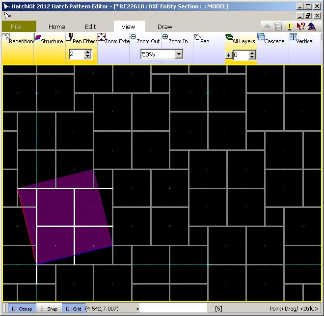

Sat, Jun 2, 2012 at 12:30:47 AM | hatch22 - my revit hatch generator
#10
hugh
Joined: Tue, Jan 27, 2004
80 Posts
3.5 Stars: 4 Votes
The hatch is not rotated.
In HatchKit patterns are formed by arranging the pattern template on a grid. The grid mesh points can be arranged in any two differing directions at any spacing. In the attached picture the red and blue lines indicate the directions and sizes of the arranging grid and the highlighted lines show the pattern template.

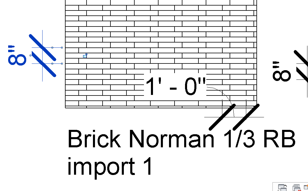

GUYS I NEED A NORMAN BRICK HATCH WITH THE EXACT DIMENSIONS BELOW. CAN SOMEONE HELP ME OUT I SPENT HOURS ON HATCH 22 AND CANT GET IT TO WORK!!
THANK YOU!
Fri, Nov 8, 2013 at 1:02:52 PM | hatch22 - my revit hatch generator
#12
Do you really want mortar joints?  Typically that is too intense for most views.
Fri, Nov 8, 2013 at 2:03:30 PM | hatch22 - my revit hatch generator
#13
mertens3d
22 Posts
5 Stars: 2 Votes
sshneyer,
What problems were you having with hatch22? Can you be specific?
Did you look at the samples file? That will probably help as it has some brick patterns in it.
http://mertens3d.com/tools/revit/2012/hatch22-2012/hatch22-2012-examples.php

Here you go:
;        Written by HatchKit 2013 Hatch Pattern Editor
;        HatchKit 2013 Hatch Pattern Editor(c) Cadro Pty Ltd 1990-2013
;        www.hatchkit.com.au/
;%UNITS=INCH
;%VERSION=3.0
*NormanBrick1-3RunningBond,horizontal 11.375"x2.375" bond=1/3
;%TYPE=MODEL
90,0,0,2.75,-3.91666666667,2.375,-5.875
0,0,2.375,-3.91666666667,-2.75,11.375,-0.375
-90,11.375,2.375,2.75,-3.91666666667,2.375,-5.875
180,11.375,0,3.91666666667,2.75,11.375,-0.375
Hope this helps.

Whoops, had hair in my eyes, this is the actual bond pattern requested
;%VERSION=3.0
;%UNITS=INCH
*NORMANBRICK1-3RUNNINGBOND,horizontal 11.375"x2.375" bond=1/3
;%TYPE=MODEL
;        Pattern written by HatchKit 2013 Hatch Pattern Editor
;        HatchKit v2.7 Hatch Pattern Editor(c) Cadro Pty Ltd 1990-2013.
-90,15.295,5.123,0,11.75,2.375,-3.125
90,3.9199,2.748,0,11.75,2.375,-3.125
0,3.9199,5.123,0,5.5,11.375,-0.375
180,15.295,2.748,0,5.5,11.375,-0.375
-90,11.375,2.375,0,11.75,2.375,-3.125
90,0,0,0,11.75,2.375,-3.125
0,0,2.375,0,5.5,11.375,-0.375
180,11.375,0,0,5.5,11.375,-0.375
