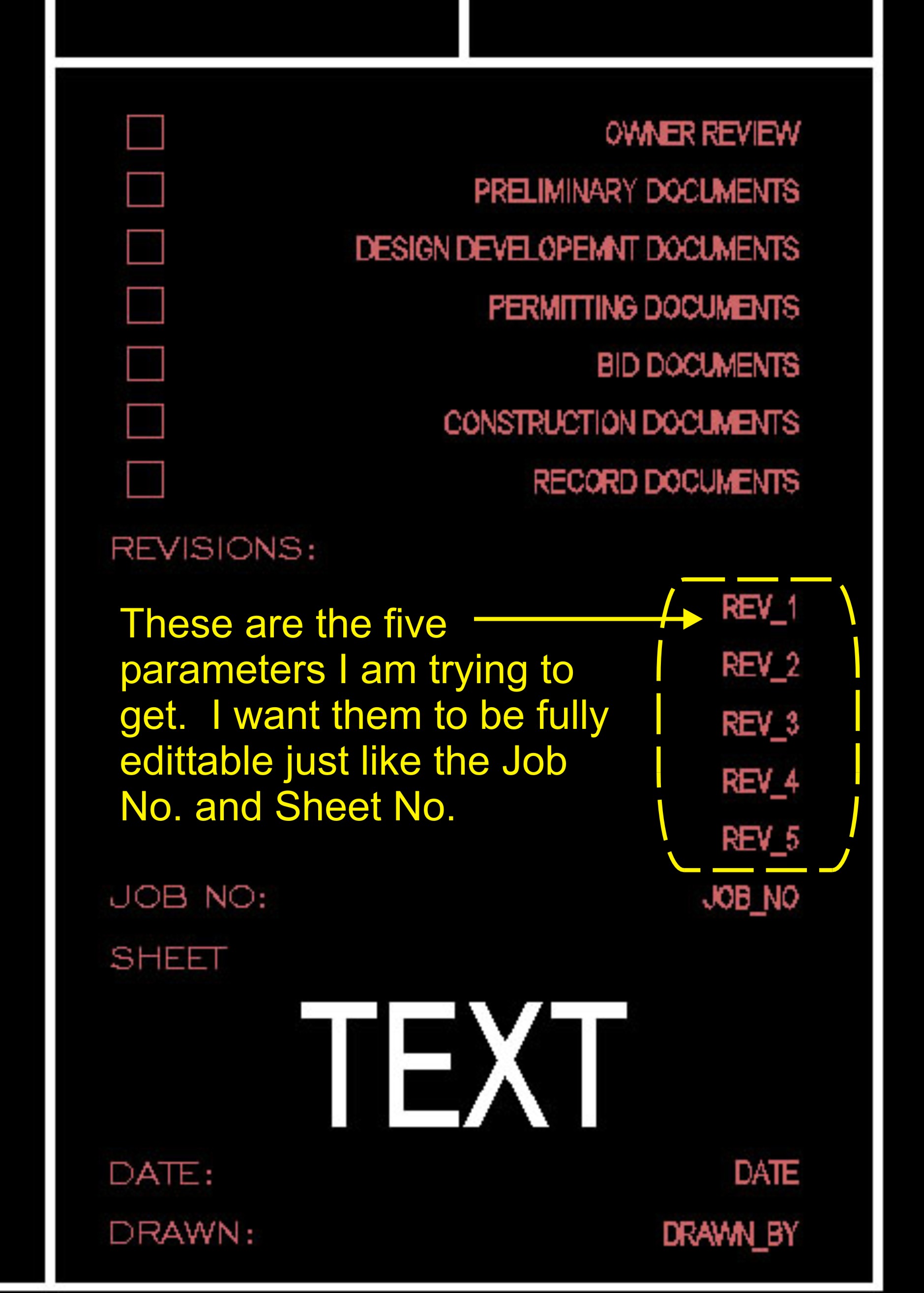

I have all of my titleblock setup except I can not figure out how create additional label parameters other than the standard ones. I went under "Shared Parameters" and created 5 new ones but when I place a label on my titleblock with those parameters, bring into my project, it will not allow me to edit the parameters I added. It will only allow me to change the parameters that were from the standard list. We have 5 places to enter "Revision Descriptions" on our titleblocks. These are the ones I am trying to create. I wanted it to appear like the attached image. This is our AutoCAD sheet but I am trying to match it in Revit. Any ideas would be greatly appreciated.

You need to load the shared parameters into your template and project in order to make use of them... Settings--Project Parameters--Add--Shared Parameter--Select parameter (can only do one at a time)--Select whether you want an instance or type (assuming instance...)--Then select what families you wish to apply to, you can either use project information or drawing sheets... HTH.

When you imported the parameter did you select drawing sheets catogery? This is the only ohter thing that I can think of that you could be missing.
Mon, Oct 22, 2007 at 3:18:02 PM | Titleblock Parameters
#12
rickdputo
Joined: Thu, Sep 27, 2007
6 Posts
drawing sheets catogery - that's was it!  thanks for your help
