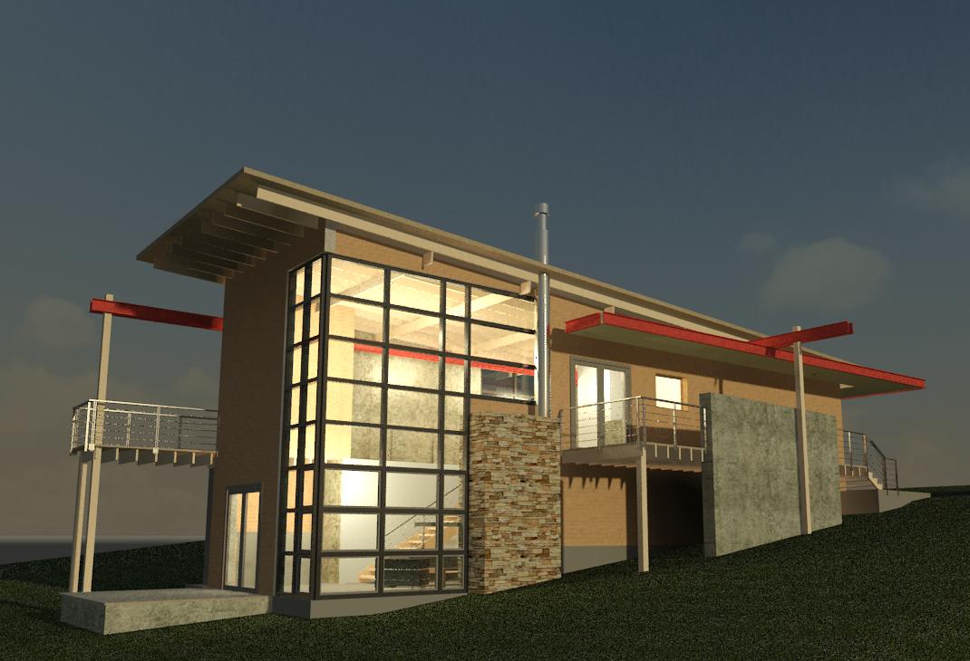

i am new to Revit, and am using Revit 2011.
i am having trouble getting interior artificial lighting to show up through windows for an exterior render.
I have checked the box that turns on the lighting family ( Table Lamp - Hemisheric 60W-120V) and have set lighting scheme for exterior sun and artificial lights.
 what steps am i missing, or what settings do i need to hunt down?

maybe the glass of your windows has the problem try lowering the reflectance of your glass. another maybe the light of your component is off

As in the real world, if the sun is shining it's usually difficult to see interior lighting (dpending, of course, on sun angle, time of day, etc.). A 60 W lamp is no match for the lumen power of the sun. Try changing your sun/time of day settings and also try increasing the lumen output of your lamp. Maybe that will help.

I have found that I have to increase a 60w light up to 1000w or more to get the interior lighting to appear. Also, I have to set the time of day to dawn or dusk, so there is some exterior daylight but not enough to drown out the interior lights. I'm looking at the interior lighitng topics in the forum because I am curious why do I have to increase the interior lighting to 1000w / more in order to the correct look. Does this tell me that I don't have enough lights in the design and when the project is built I will have issue of not enough lights?????

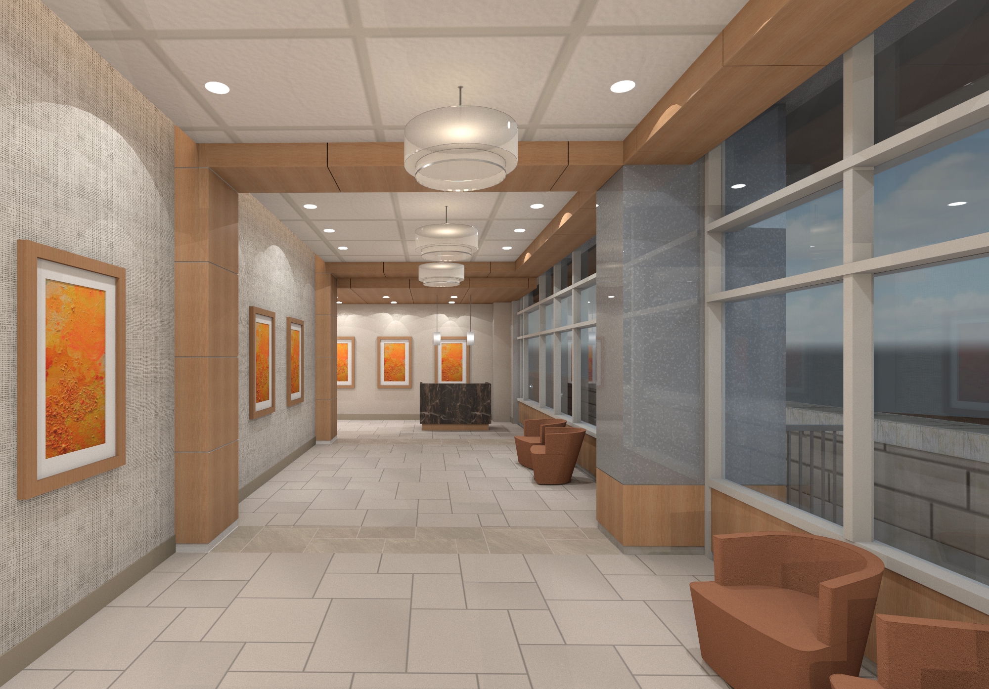

Thanks Jlights. It was my assumption that with Revit, the idea was to have everything as real as possible including the rendering (which includes how the lights render). But you are correct, I will have to use a different tool to understand the light levels in the space. I am far from a lighting designer or consultant, so I probably couldn't begin to understand the complex lighting tools available.
You can see in the rendering I've produced using Revit. The daylight is set a dawn to reduce the amount of sunlight coming through the windows. I've increased the wattage on the lights to such a high level (1000 -1500w) to get the interior space to be lit.

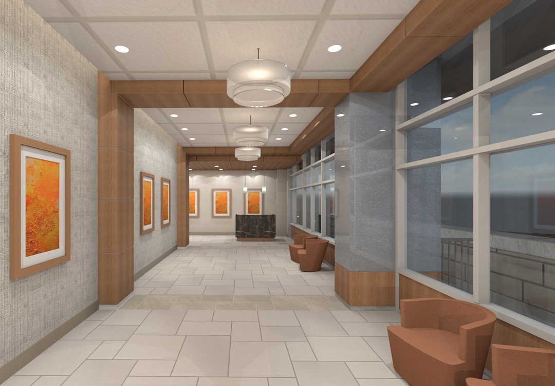

Nice. I'm actually a lighting designer myself- if you don't mind a suggestion, I'd move those downlights on the right a bit farther away from the windows so you don't get that light scallop on the wood beam, which distracts from the attractive design of the space.
I'm guessing you did this rendering at Medium (though I could be wrong); if you do it at High or Best the edges of the light beams should soften and you won't have such hard edges on your beams of light.  These also create a distracting pattern in the rendering. If you can soften them, your eye will be drawn right to the end of the hall where the light is brightest and you'll have a terrific rendering.

Thanks jlights - those are great suggestions. I'll move the recessed away from the wood beam.  I'll do another render at best to see if the light beams are softer. but yes, that will make the rendering look nicer.
@alabaster2512 - i like the idea of your tricks. how do you set the studio lights to 100,000 FC (footcandles?) and what do you mean by creating light group of studio lights emitted from a 8'x8' rectangle shape uniform. do you place the studio lights in a 8'x8' spacing within the interior space to get the interior to glow?

I didn't do anything really special to the settings. For Exposure Control, these were the following settings:Exposure vlue: 9
Highlights: 0.25
Mid tones: 1
Shadows: 0.2
White Point: 6500
Saturation: 1
Rendered with Scheme: Interior: Sun and Artificial
Sky: No Clouds
