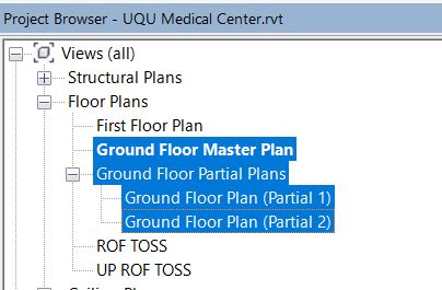

@rkitect; I duplicated a view (Ground floor plan) two times to divide it into two partial plan views. When I changed the scale of the created partial views the scale of the original master view changed as well. I overcame this issue by making an independent duplication of the master view first, then duplicate it dependently two times to get the two partial views.
Thus, I have 2 master views; one in a 1:100 scale (the original ground floor view) and the other is in 1:50 scale (independent - parent of the partials), in addition to two partial view in 1:50 scale (dependent). The problem now is that any details I need to add to the ground floor view, I have to add it to the duplicated view as well, which is the parent of the partials, to avoid conflict. This is confusing and could cause problems if I forget to add any future details twice. How to control this? Or any other solution?
I have attached an image of the concerned views captured from the project browser for clarification.
I hope I have clearly explained the issue and I get reply from the participants here.

Thu, Jul 4, 2019 at 7:27:54 AM | Overall Plans and Partial Plans ... looking for Best Practice
#9
Dependent views are just that .... dependent.
You only need to create two views.
  1. Create an overall plan at the correct scale (can be duplicate but not dependent).   This will have all annotations and will be 1/2 your building eventually.
  2. Place your MATCH-LINE
  3. Set up the crop region for this first plan.
  4. Create a dependent view of this first plan and set the crop region for the second half. (Make sure the crops overlap.)
  5. Now place these views on seperate sheets.
  6. Add a view reference at the matchline to point to each sheet.
Here is a tutorial: http://www.revitzone.com/presentation-and-graphics/168-matchlines

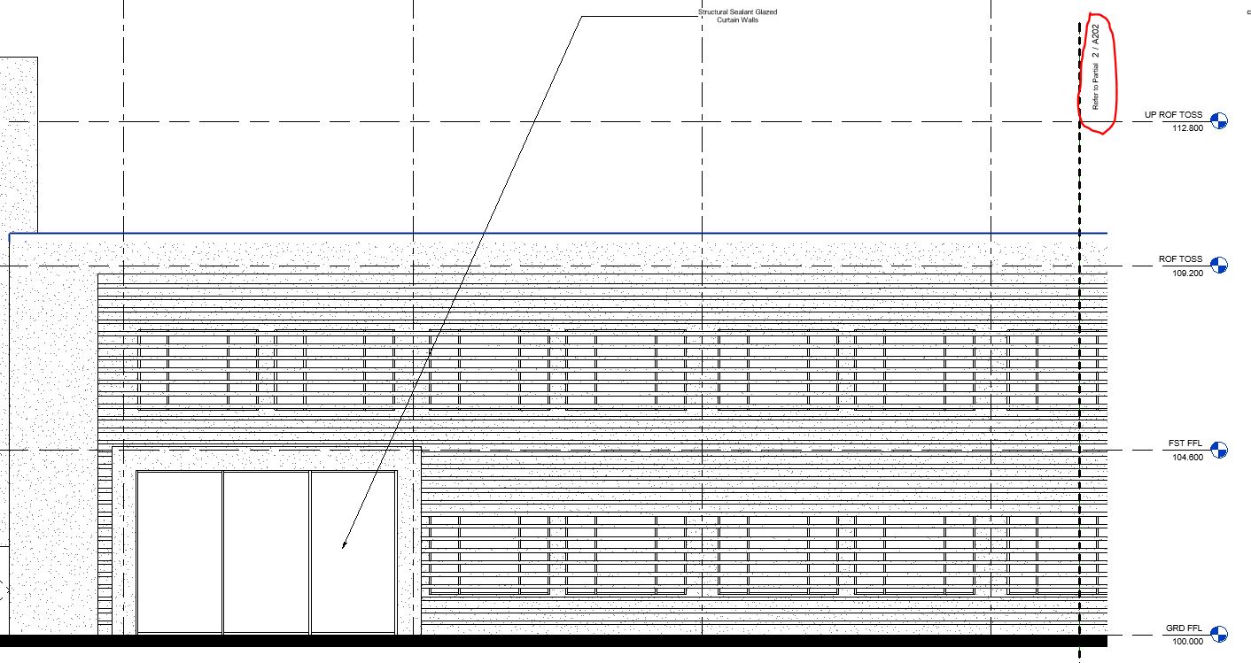

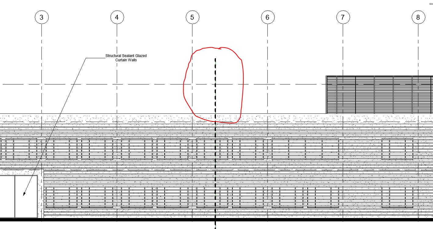

Coming to the practical application of what we discussed 2 weeks ago, I need to place a view reference for the big scale partial views on the small scale master view. I have two partial views, one to the left side and one to the right. The view reference of each side is shown correctly on the view of the other one. However, I am not able to place the correct references on the master view (the small scale drawing) which is supposed to be the key that show the references that guide reviewers to the sheet numbers of both partial views. Please see the attachments.
How to show the references in the master drawing?

I have realized that while placing a view reference for the partials on the original view shows nothing since they are not dependent to it, I am able to copy the view references placed on the partials to the original view and they are linked to them and working well.
Sun, Jul 21, 2019 at 7:18:15 AM | Overall Plans and Partial Plans ... looking for Best Practice
#15
You should be using "Reference Other View"
http://help.autodesk.com/view/RVT/2016/ENU/?caas=caas%2Fscreencast%2FMain%2FDetails%2F31b698a1-0b25-4877-9f86-9884f8ea66e8.html
