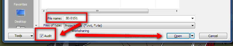

Did you try to "Audit" that file? Also, create a backup file, then open that backup and delete/detach those CAD files, then "Purge", save and try it again...
