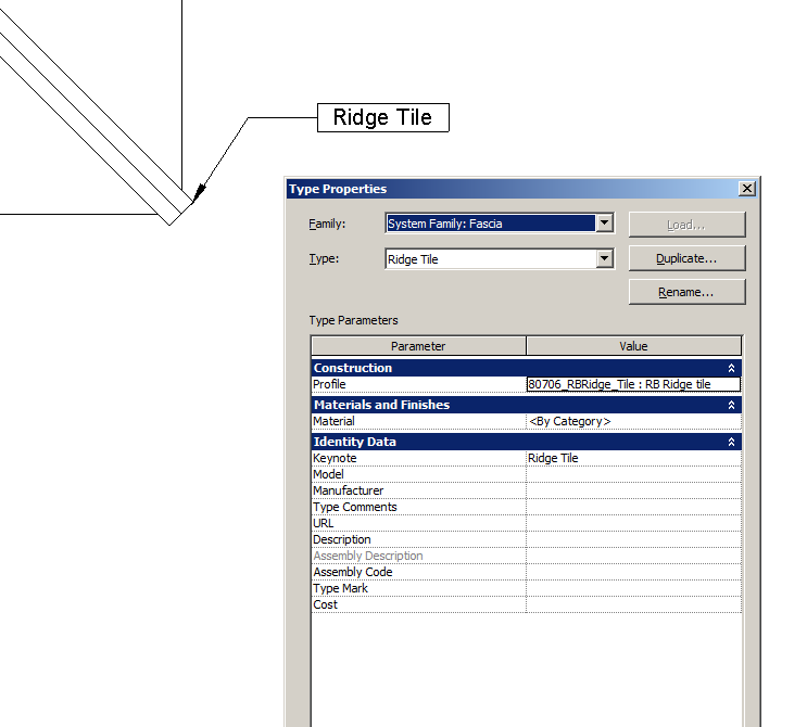

My first instinks were as WW indicated and I tried using a shared parameter but cannot seem to get that shared parameter to propegate through the ridge tile profile family to the fascia / ridge tile in the project.
So I just added a Keynote Value as a Type property to the Fascia family (which uses the ridge tile profile) and then used a regular 'Keynote tag' and it worked. See attachment.

dgcad
It worked as you suggest but I wish I could use the description parameter instead of the keynote.

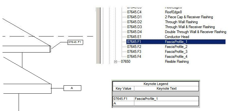

here is something you might try:
1. a generic annotation with a label..
2. enter the designation of the fascia type and in the keynote parameter
then use annotate > keynote > element..
3. use keynote > user > select one designation from the list..
 See image..
