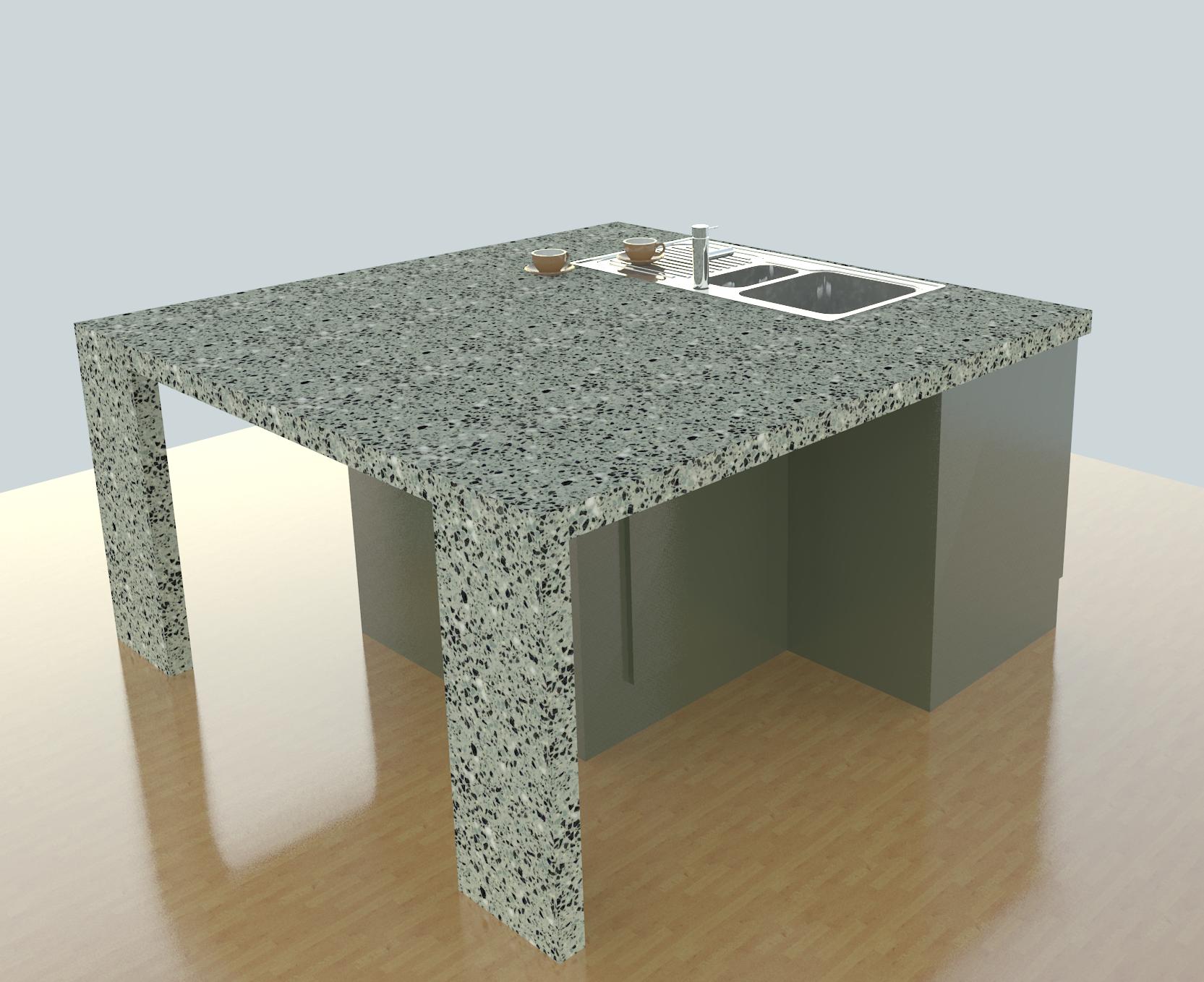

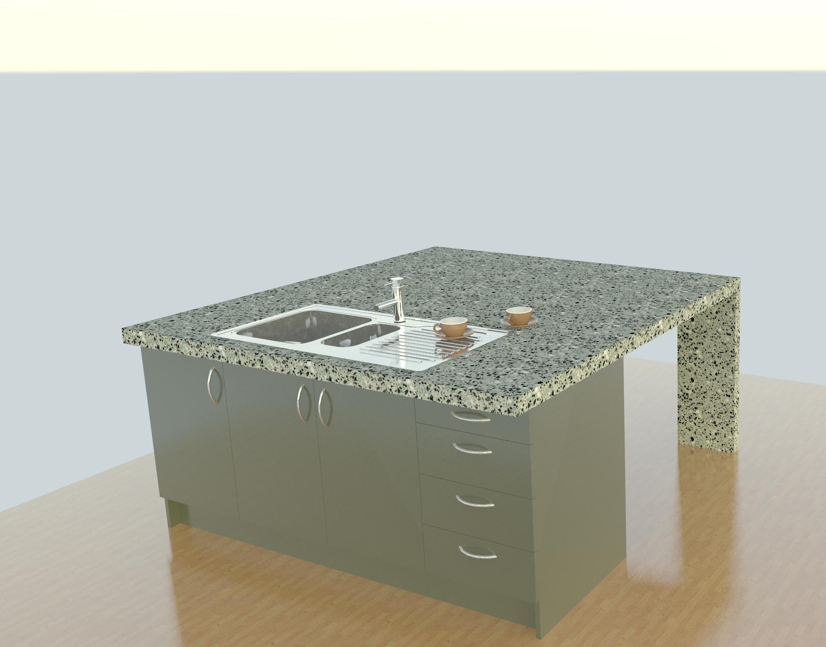

73128_island_bench_3front-300_dpi3am.jpg73128_island_bench_3front300_dpi3am_long_exposure.jpg

By using the 2am method, whilst still using a sky background, the sky appears yellow no matter what time of the night you set it. I've overcome this by making the background black.With no extra lighting, this method doesn't really look too great. I guess adding lighting would help it.

COV = Cone of Vision sometimes also noted as FOV for Field of Vision.
Its related to the human eye and the natural range of the eye described as a cone.:
go here to see this set of useful diagrams:
http://books.google.co.nz/books?id=Am7FPeFo1ycC&pg=PA18&lpg=PA18&dq=perspective+Cone+Of+vision&source=bl&ots=CPkPRgI0Zi&sig=desg--BosCJJ9TlShoa5JoAwNqc&hl=en&ei=2x2HS6_zBJXk7APJue2zDQ&sa=X&oi=book_result&ct=result&resnum=10&ved=0CCcQ6AEwCQ#v=onepage&q=perspective%20Cone%20Of%20vision&f=false
There is reasoanable consistency of information and guidance I guess, on photographers web site, books about perspective drawing,art and  graphics web sites and even some math web sites to get a handle on some sound basics to help with composing perpective drawings using the Revit camera or other  relevant programs and how to fool the eye, or how to best leave something out.
The Revit camera is severerly limited to what controls you have and rather than say here that you have COV controls.
I  think (rightly or wrongly) that the Revit camera has a FOV control more than COVC to make a distinction here,  because that really seems to me to be more of a field control as you can open up the width super easy and very quickly distort the scene content. Example is interior shot where it is often desirable to show the client a lot in one shot but almost always too easy to show too much for other reasons, and particularly where there is a restriction on length from the camera. Distortion follows widening of the camera unless used with great care.
I am finding it more useful to restrict these inteterior shots to the vignette rather than a pan but you will quickly figure out how much angle you should have to avoid distortion and foreshortening etc.
I read somewhere that theatre perspectives are around 60 degrees and assume this is also for when the set builders are designing the sets and working out sight lines for the audience because if they don't try hard, some people will see a quite distorted view of the set while others will see it at a perfect angle of (repose? lol). Its porbably worht having a look at the general approaches for single, 2 point and 3 ppoint perspectives because all of this stuff applies directly to computer perspectives, photography and so on so your knowledge then covers off much more than Revit camera set up.
Lastly, those 2/3 am blast renders and backgrounds,......
depends on what your use is. Don't forget you can export into PNG or TIF out of Revit to get an alpha channel then slip it into Photoshop / Gimp / Core PSP and add backgrounds or,  import the png/tif right back into Revit in a Drafting View and you will still get to be able to have a another layer of say a background sky / photo and get it to work as a single composition within severe bounds of Revit.....its much easier to do it in an image editor though.
