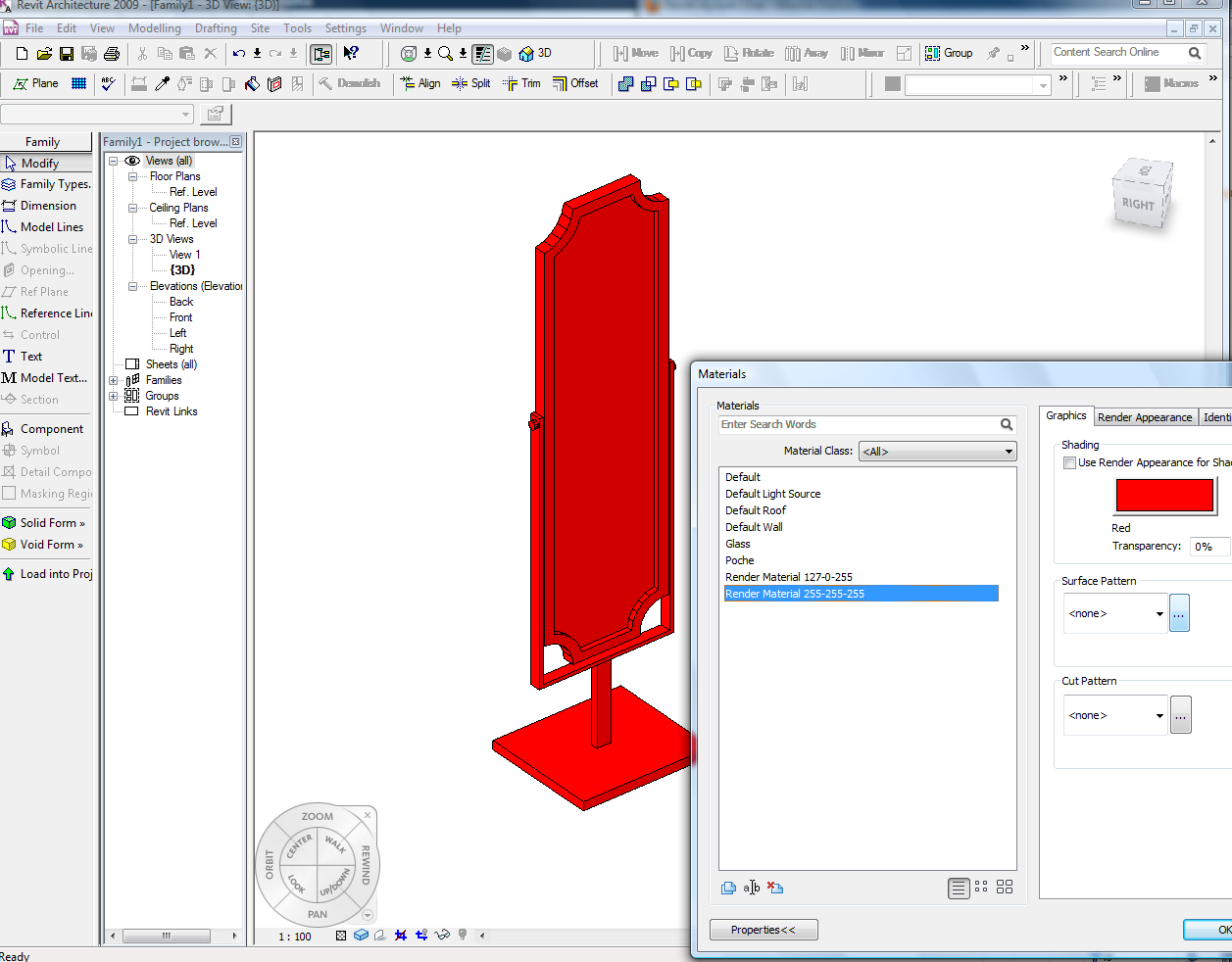

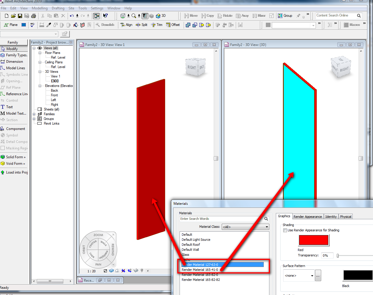

Like you can see, there are two "Render ####" material in that model, so now i can change them...
Also if you search in the forum you will find lots of thread like this one in the past:  http://www.revitcity.com/forums.php?action=viewthread&thread_id=15792

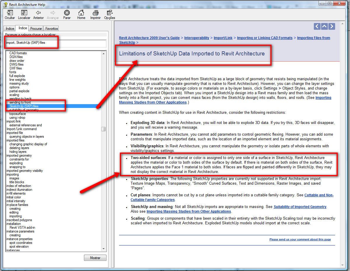

"did you export the file as a dwg before you brough it in to revit?" - YES
 about the second question check the HELP menu, i think this anwser your question... That's why i ALWAYS import the model to CAD to "arrange" the model because i don't know how it is...
