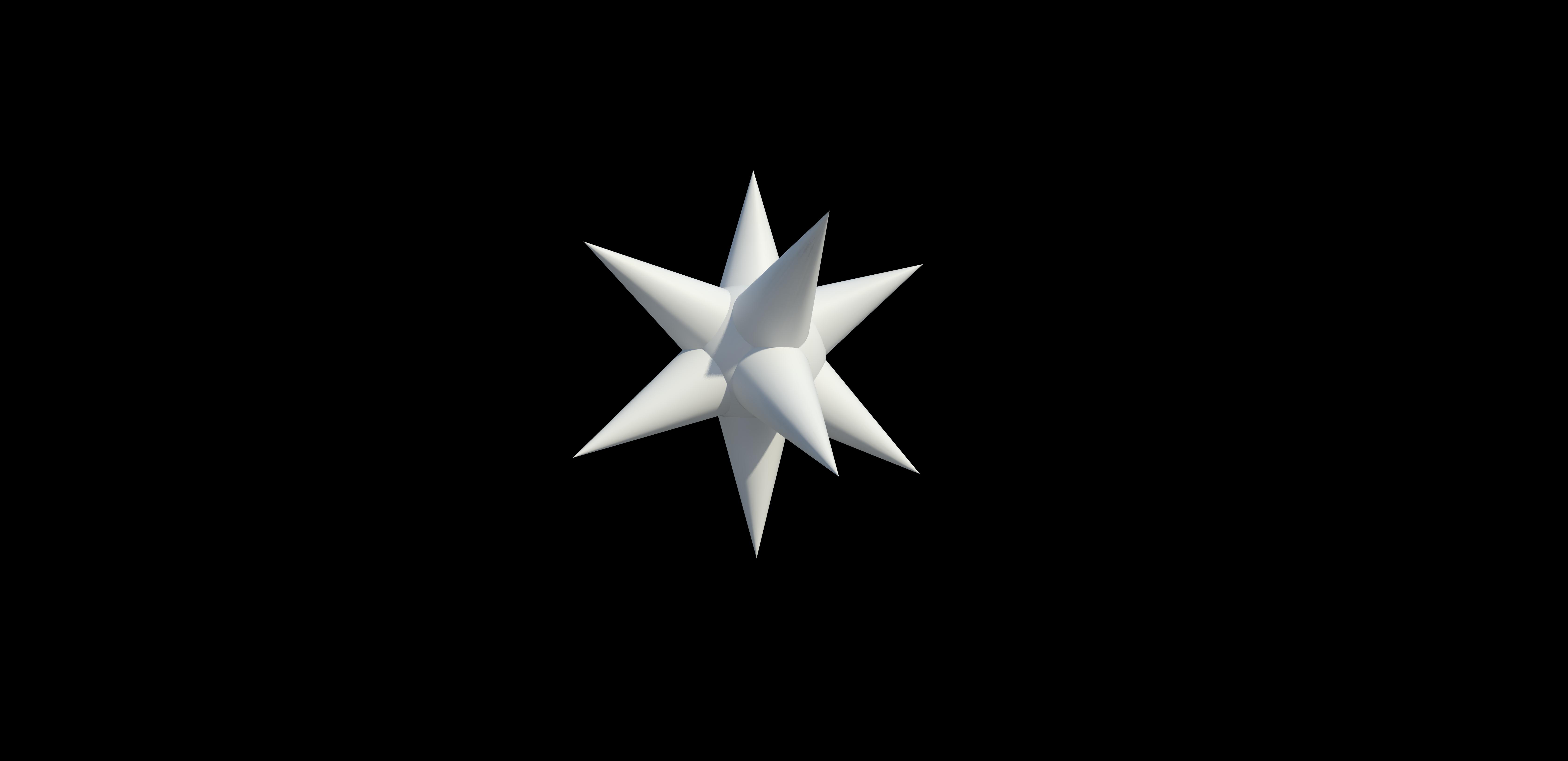

hi..
i'm trying to do this..
do u think revit can create this shape?

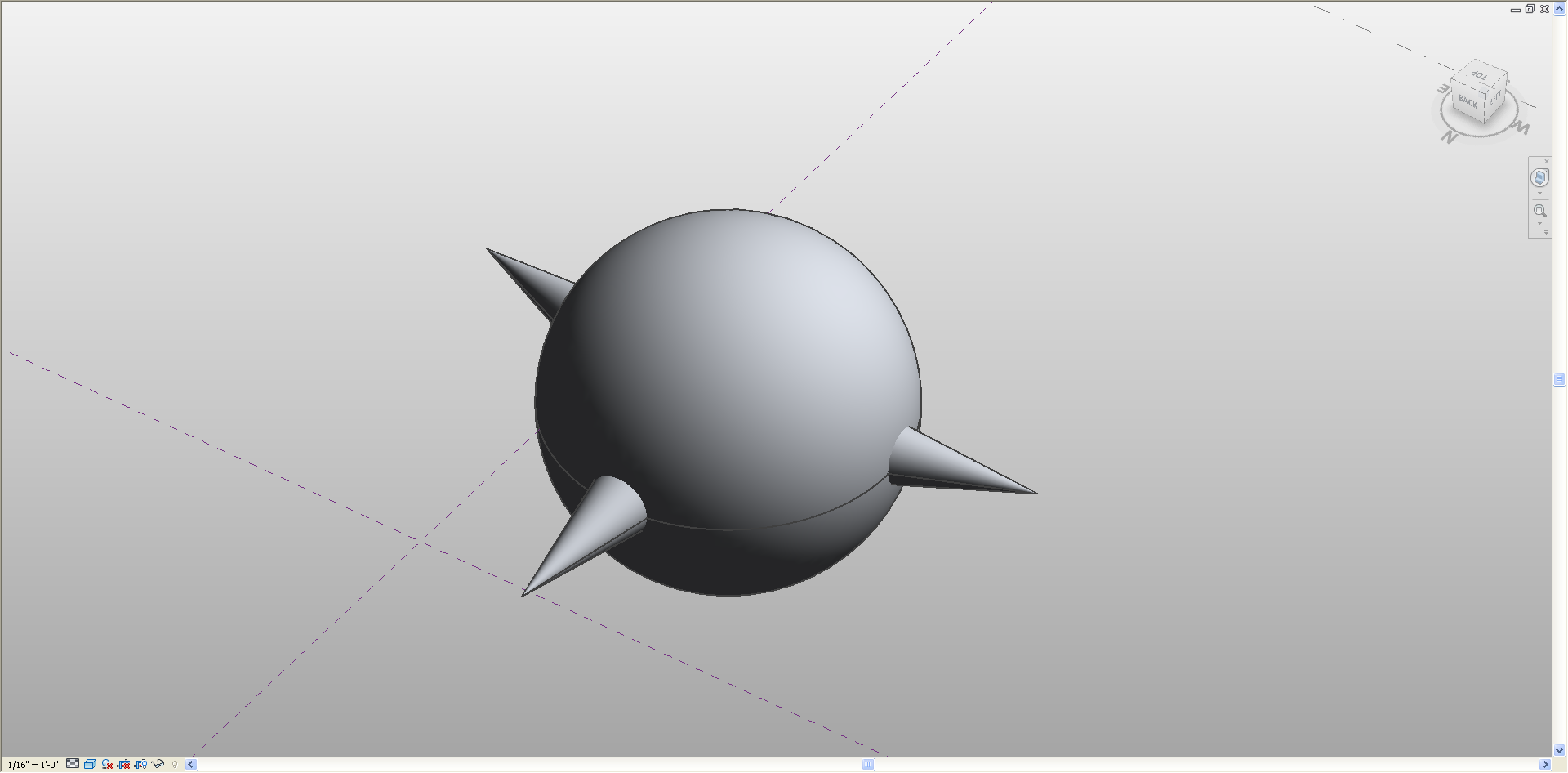

Join a bunch of cones into a sphere,

hi..

how to draw the cone?
I couldnt do it with Solid Revolve..
It just doesnt work T.T

are you using conceptual massing?
Wed, Oct 7, 2009 at 5:12:37 PM | hw to create a 3D star?
annateo301
Joined: Tue, Aug 4, 2009
70 Posts
no..
i was using "Solid Revolve" under Modelling..
which command did u use?

i am in the conceptual mass enviroment. one is a circle revolved around center axis and the other is a triangle revolved on the adjacent axis
are you on revit 2010 or 2009?

i'm using revit 2009..
i know how to create a 3D circle w/ solid revolve but I couldnt get a cone..>.<

revolve a triangle

thanks..but how come i can only draw that in plan not elevation?

is there any way i can rotate it vertically??

As alabaster told you, create the cone with Solid Revolve, but I did it as a Generic Model Face Based family, so you can place them on the sphere....
