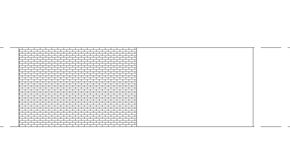

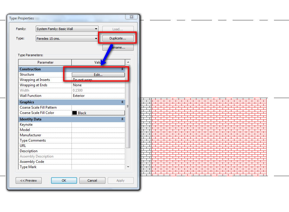

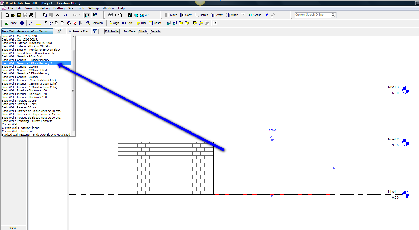

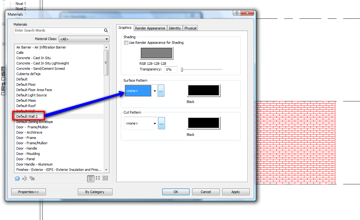

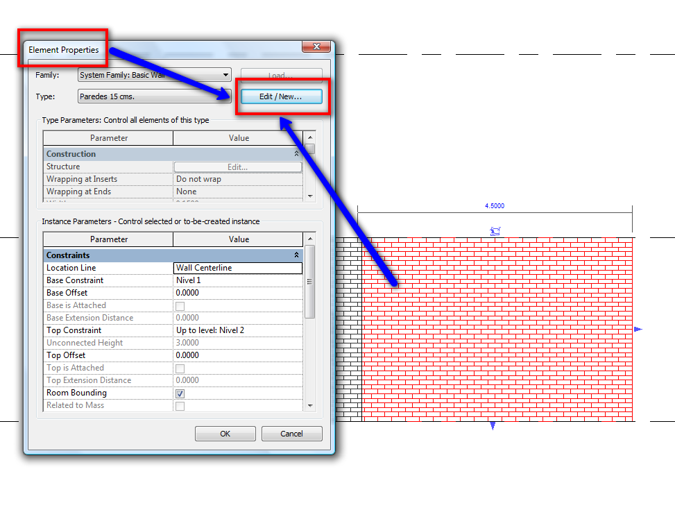

Quoting architimmy from 2009-08-28 15:29:52
I am using Architecture 2009.
I am working on some elevations which vary in depth of view and I would like to show hatch patterns on surfaces in the foreplane of the elevation and hide hatch patterns in the distance. Is there a way to make this change without having to draw a number of masking regions?
One easy way you can do this (if I understand you), is simply duplicate the wall you don't want any hatch and in Settings-->Materials, create a new material without hatch and apply to the duplicated wall......I think qabulin only likes his new signature...LOL

Shiny Just thinking in the easiest way.....if you want your previous wall (with the hatch pattern), just change it in the type selector....anyone got another ideas....Ty or HDD??? Confused

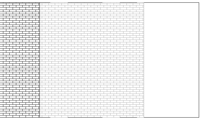

Overide Graphics in view?  Select the walls that are further back and switch off the hatch pattern, or set it o halftone.  One method of achieving this, there are others with more options to create multiple fading of walls as they recede.

Override Graphics in view... that was simple! Puh
