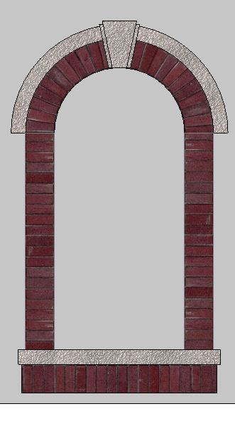

Tue, Jun 7, 2016 at 1:07:05 PM | Surface pattern move/align/adjust problems
pilkington11
Joined: Fri, Oct 10, 2014
0 Posts
Anyone have a solution to this?

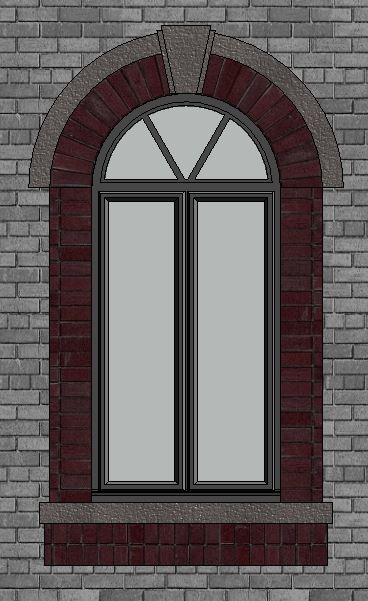

I'm making new families and the surface patterns are moving fine in the family (yes they are model patterns). When I load the family into a project, the surface patterns will not move. I've tried loading in the same material as well as making a new material in the project and still the surface patterns will not move for me.
I cannot paint it, I do not want to have 4 different materials for each frame and I do not want a quick work around.
Best practice solutions anyone??
See images to see the difference of material mapping between the family and the project.

It is a parametric family, not a wall. I cannot split face and paint (nor do I want to).
I want to move the surface pattern to move the x and y coordinates of the render map. Does any one know why it works in the family and not in the project?

Im curious if the positioning of the brick pattern is locked to that position in the project. If you copy the window and move it horizontally does the brick pattern change at all with its positioning. If it does it might be that the pattern is somehow locked globally within the project. No idea how but you might try modelling something else then applying that brick material and using that object to try and shift the pattern on the window (if you change the pattern alignment on another object it may shift it on the windows)

I applied the same material on the exterior wall and was able to move both the surface pattern and the render maping with it, it was a good shot though!
