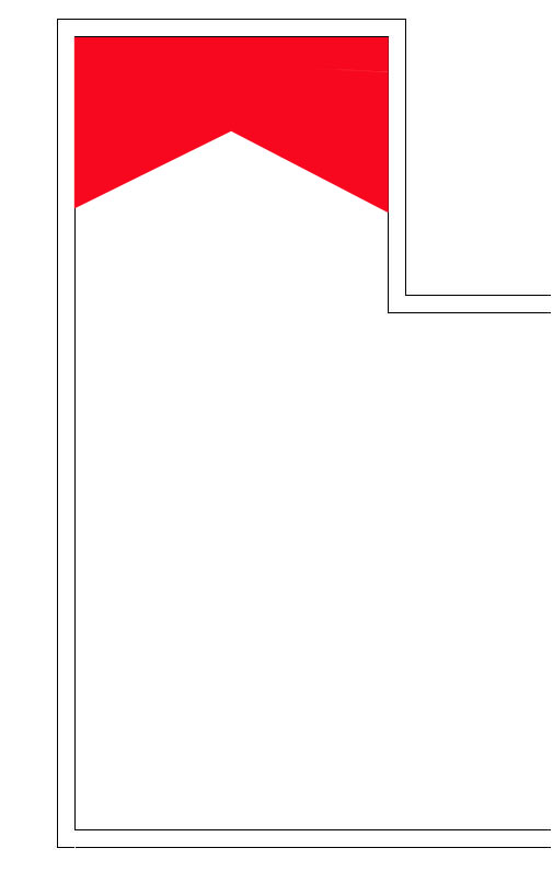

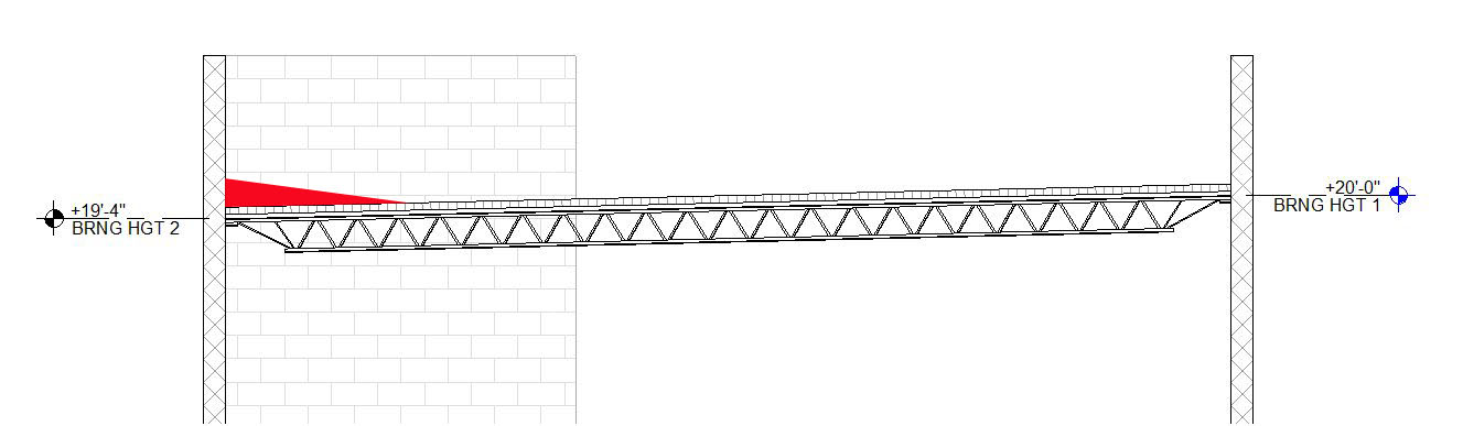

I am having trouble showing the tapered insulation correctly on a sloped roof.  When the roof is sloped using the slope arrow, I am not able to add points and adjust the heights.  I made a sloped reference plane thinking I could make an extruded roof and set it to the sloped plane, but I can not select that plane as an option.  Attached are images of what I'm trying to achieve.
 Any suggestions would be greatly appriciated.
Using RAC 2010

I would like to model it, but I took a different approach and faked it.  On the roof plane, I drew model lines for the crickets and drains.  Then in the section, I drew in a filled region so the roof and joists are sloped correctly and then faked the tapered insulation.
I like to draw things correctly, so modeling it would be ideal, but after some thought, you would never see it unless in a perspective view from above or maybe a section box view.  For what I need, faking it worked out, but if you have modeling suggestions, I'm all ears.

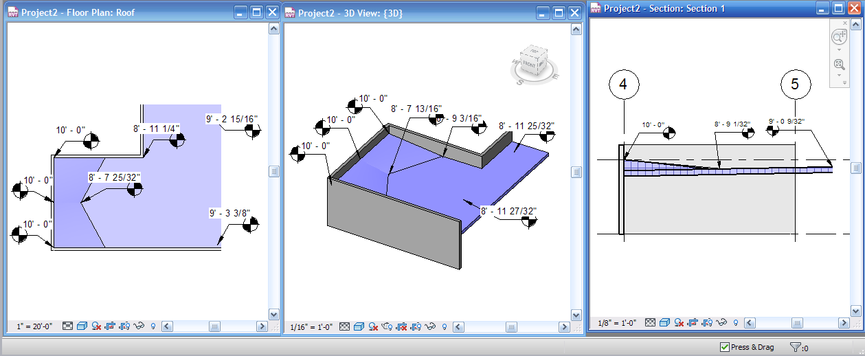

Modeled in under 1 minute. See attachment.
Tell your Archicad buddy any time any place : )

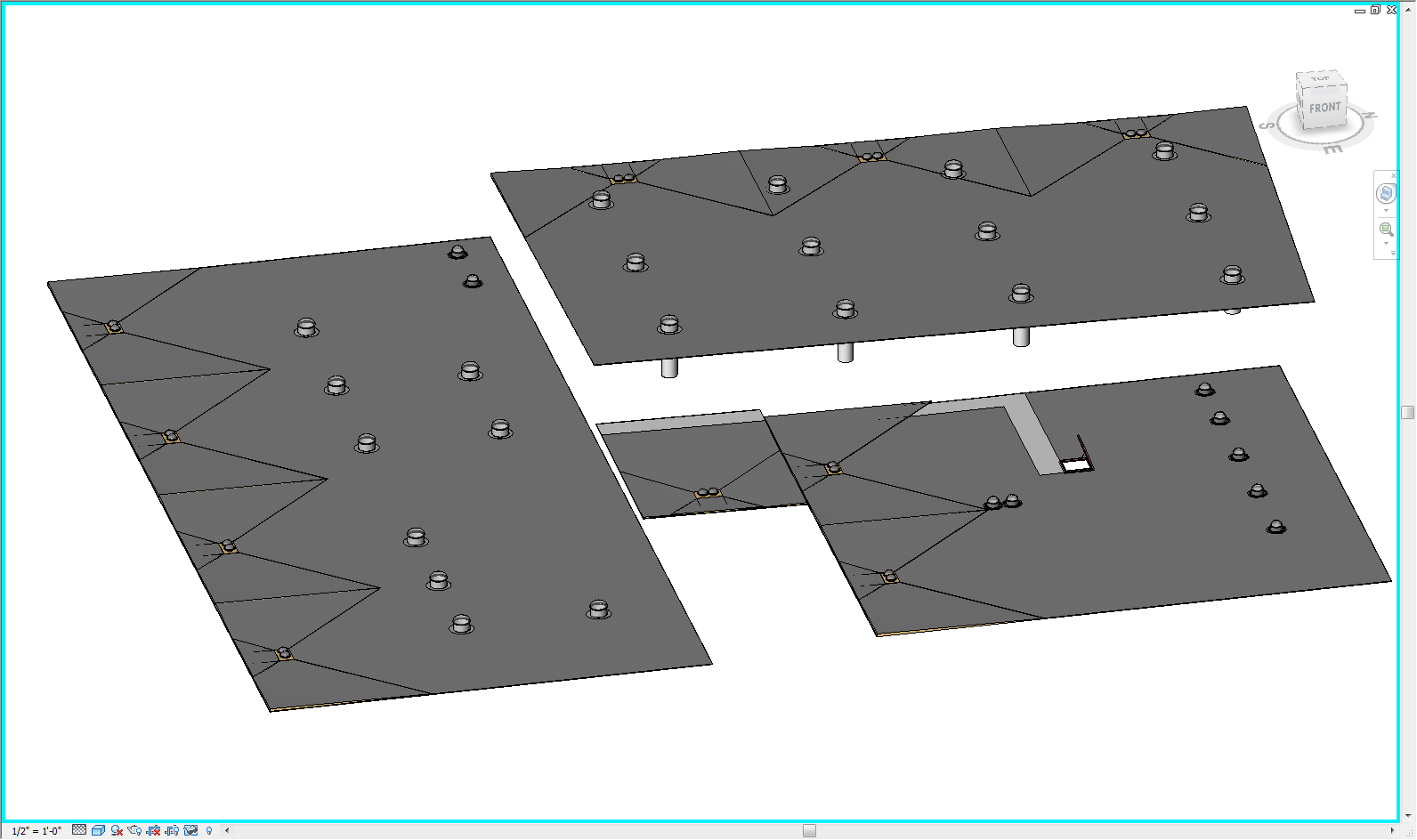

I model all my crickets, roof drains and piping. this is 1/4" slope on all roofs and crickets.

It's actually quite easy.
The main sloping roof is just a flat roof with slope arrow. That's no problemo.
The tapeing part is a single in-place family, roof category, solid 'sweep blend' then mirrored. Then join geometry or use linework tools to get rid of the seam line.
(TIP: When roofs get tricky, break them into smaller more manageable parts)
Hold tight for video link. . . .

Mines a little more tricky but functions quite nicely. I create my main roof deck with a 1/4 slope, then i create my crickets as a flat roof with variable insulation and modify my points to the correct elevation/slope. Lastly I have an inplace family in the roof category that cuts the slope out of the bottom of the crickets. I just keep the inplace family in a workset that is only opened with modifying that element. As a result I get perfect crickets and no of my coworkers are aware of the hidden inplace family.

Ok below is a video explainng how to use a blend sweep to create the tapering roof condition.
Detail video > http://www.CADclips.com/downloads/Tapered-roof-insulation-with-sweep-blend.wmv
Click the link above to play the video online or right click and 'save targetr as..' to down the file.
Youtube version. . . a little slicker production > http://www.youtube.com/watch?v=qnqljpl9QEU
One of the interesting things that hit me as I setup this video is if you start the in-place family 'sweep blend' in a particular view then switch views the 'workplane' does not switch. The workplane from the original view is persistant. I always knew this but never quite demonstarted it before. So you should always 'show' your workplane and confirm it is where you think it is as you model.
The bottom line is the 'workplane' stays from the 'original view' as you change your view from various plan views or 3d views etc. as you model. In regular project modeling when you switch to say 'Level 1 plan view' the workplane follows you. For in-place families it does not.
