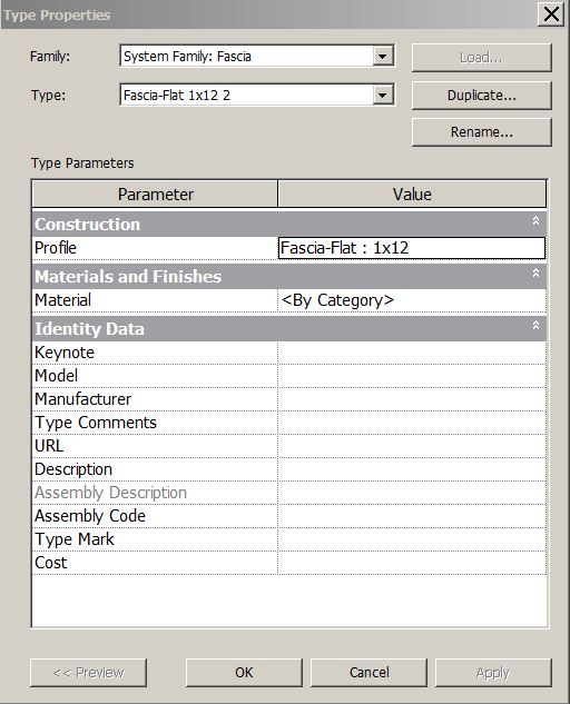

Fri, Jul 24, 2009 at 1:21:02 AM | Fascia
WYS1WYG
WYS1WYG Avatar
Joined: Sun, Jan 4, 2009
356 Posts
3 Stars: 11 Votes
thanks tim and erland-
yes wouldn't i love to go into the properties and change the height and thickness..
only problem is- there ain't not height and thinkness in the properties i know..
see the attachment..

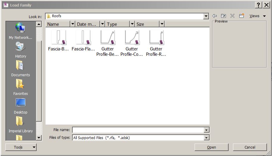

Fri, Jul 24, 2009 at 2:28:50 AM | Fascia
WYS1WYG
WYS1WYG Avatar
356 Posts
3 Stars: 11 Votes
erland-
"Imperial Library--> Profiles--> Roofs--> M_Fascia-Flat and edit your fascia then Load into Project"
see the attachment- i've tried everything and all it does is load into the project-
i see no way to "edit you fascia and then load into project".. please explain..

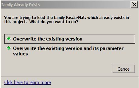

Sat, Jul 25, 2009 at 1:07:02 PM | Fascia
WYS1WYG
WYS1WYG Avatar
356 Posts
3 Stars: 11 Votes
that's what i'm trying to say- i cannot do anything with it but
click on it for it to load in the project.. please look at my
attachments..

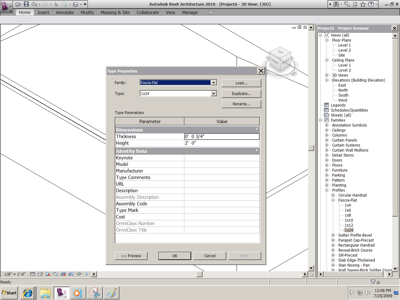

Sat, Jul 25, 2009 at 1:34:26 PM | Fascia
#9
dgcad
dgcad Avatar
Joined: Thu, Mar 17, 2005
1231 Posts
3.5 Stars: 36 Votes
Profiles are nested families in the fascia family.
Go to the project browser > profiles > right click 'fascia flat' > New Type > Rename 1 x 24 in the rename box as provided.
Then, Right clcik the new 1 x 24 type > Properties > Change Height and Thickness > OK.
Go back to your Fascia family profile drop down list > Bob's your uncle !
You could also open the profile family rfa file itself in the family editor and them make a new 'type' and in this case change the Thickness and Height parameters. Then load that profile back into the project at hand.

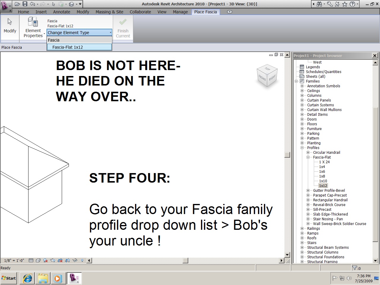

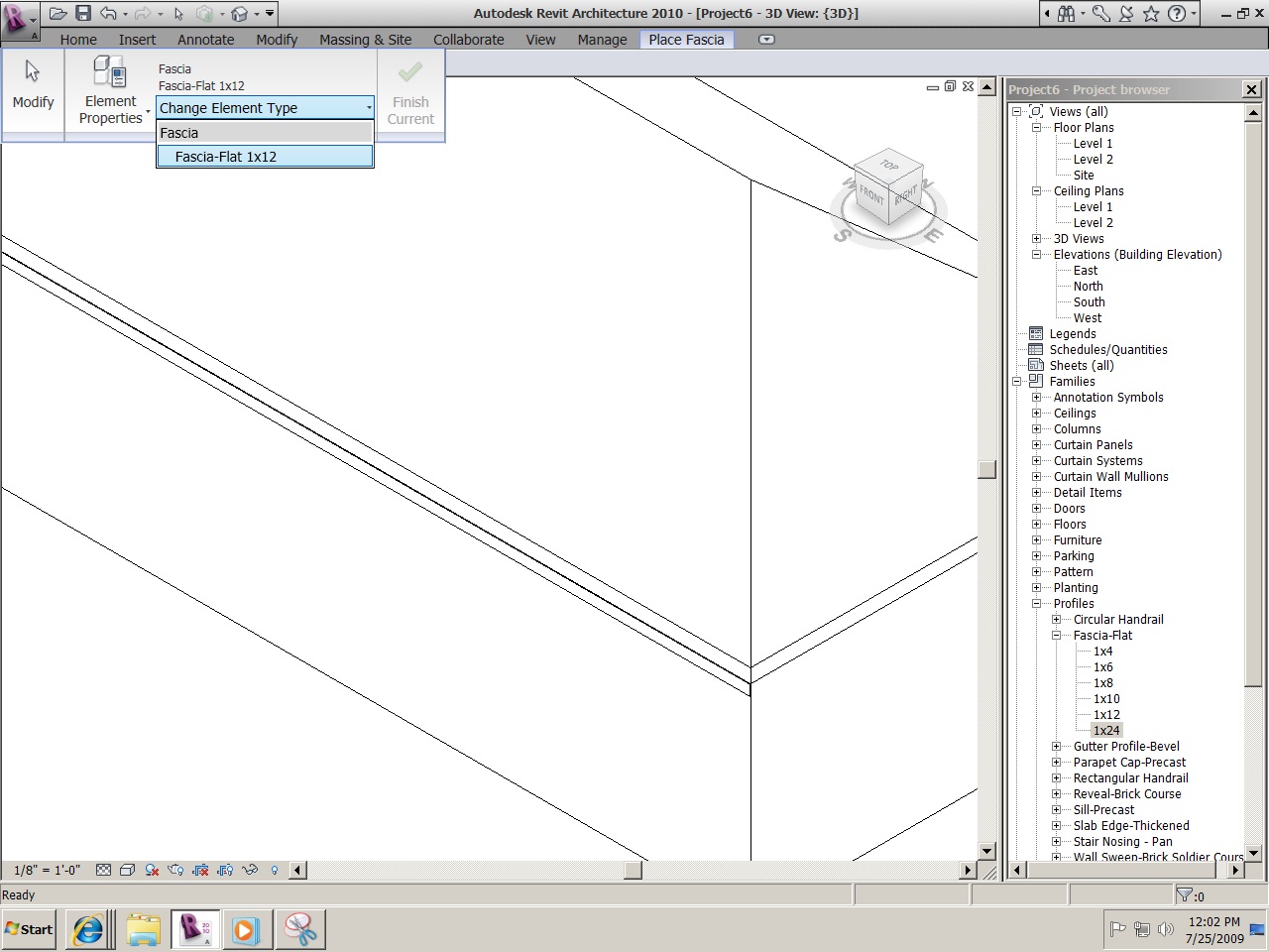

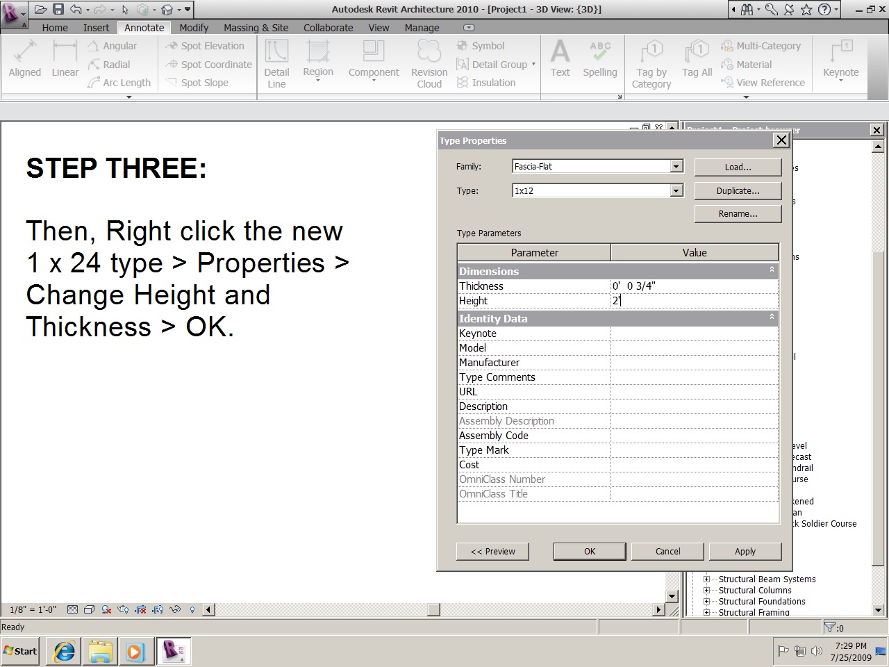

Sat, Jul 25, 2009 at 2:15:08 PM | Fascia
#10
WYS1WYG
WYS1WYG Avatar
356 Posts
3 Stars: 11 Votes
OMG- i think i'm gonna drown..
see attachment 1..
notice how it SEEMS like i did exactly infinitely as instructed..
"Go to the project browser > profiles > right click 'fascia flat' > New Type > Rename 1 x 24 in the rename box as provided.
Then, Right clcik the new 1 x 24 type > Properties > Change Height and Thickness > OK."  see attachment 1..
now i'm on my way back to the ribbon (the beast)- expecting to see "bob".. but guess what? bob's not there..
see attachment 2..
Sat, Jul 25, 2009 at 2:36:44 PM | Fascia
#11
tim123
Joined: Tue, Apr 12, 2005
1310 Posts
4 Stars: 19 Votes
Now duplicate the fascia and load in the new profile that you've created.

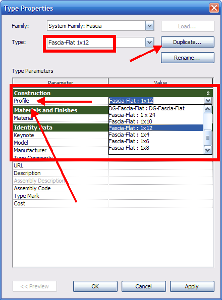

Sat, Jul 25, 2009 at 3:17:38 PM | Fascia
#12
dgcad
dgcad Avatar
1231 Posts
3.5 Stars: 36 Votes
Lord thunder'n Jesus man !
The profile is a 'nested' family in the type properties of the fascia family.
Go into the fascia 'type' properties dialog box , there is a pull down titled 'Profile'. Bob's having lunch and ready to go home.
See attached dialog.
Sat, Jul 25, 2009 at 6:49:50 PM | Fascia
#13
WYS1WYG
WYS1WYG Avatar
356 Posts
3 Stars: 11 Votes
the type properties dialog you posted is showing how
to duplicate the profile..
if you look at the same dialog i posted you will see
that i have already made a duplicate for the new
1 x 24..  then you say just close that dialog and go
make the the new fascia.. but look at my second
screenshot and see what i find when i do go to make
the new fascia- it's not there..

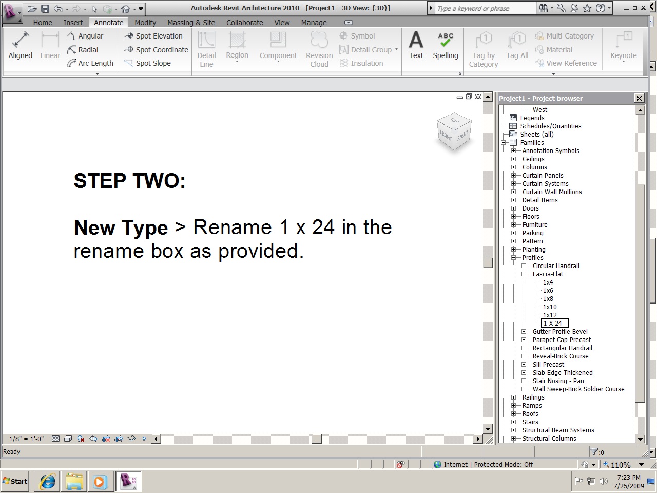

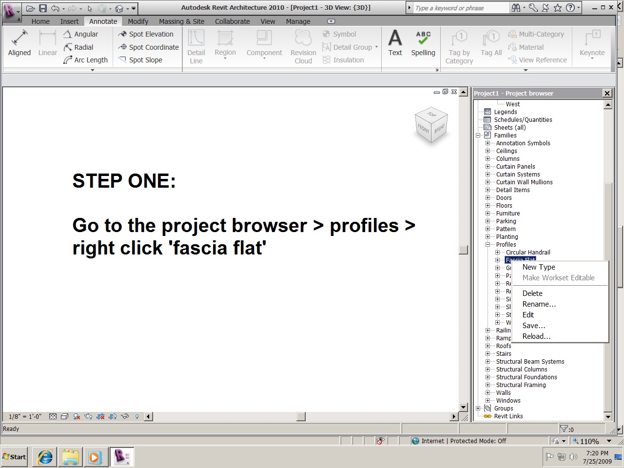

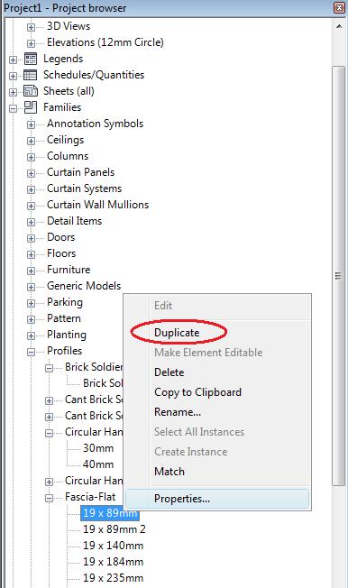

Sat, Jul 25, 2009 at 9:44:19 PM | Fascia
#14
WYS1WYG
WYS1WYG Avatar
356 Posts
3 Stars: 11 Votes
let's follow these instruction together- exactly as they are written
to get a new fascia size..
1. Go to the project browser > profiles > right click 'fascia flat'
2.  New Type > Rename 1 x 24 in the rename box as provided.
3. Then, Right clcik the new 1 x 24 type > Properties > Change Height and Thickness > OK.
4. Go back to your Fascia family profile drop down list > Bob's your uncle !
see all four attachments for proof bob died on the way to the hotel..
Sun, Jul 26, 2009 at 1:38:14 AM | Fascia
#15
tim123
1310 Posts
4 Stars: 19 Votes
You have successfully created a new profile for your fascia.  Note that this is a profile, not a fascia.  Now, go to the facia drop down and in the properties of the fascia change the profile of the fascia to the new one that you have created, or duplicate the fascia family if you need more than one type.  This is mentioned in post 9 and 11 of this thread and there is an image in post 12.
This method is used for other things in Revit, such as wall sweeps and reveals, gutters and most things with profiles in the family.
