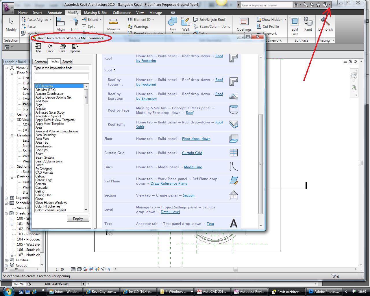

hi All, In2010 revit Architecture ........is it possible like in autocad to turn to classic screen from ribbons...it's too big change from 2009 to 2010.....and it's not easy to get on it right away...any tutorial to get it correctly and to understand how and where to start (in 2010)...help...thanx

No, not possible, but this may help you on your way (little down arrow next to the help icon).

it is technically possible to use the old ui in 2010.  i'm not sure how to do it, but it can be done.  you do not however have access to the new tools because the buttons required to opperate them will not exist.
it really does not take too long to get a feel for the new interface.  the Alt key is a good start and if you get really stuck, "where is my command" in the help menu (upper right) is handy.

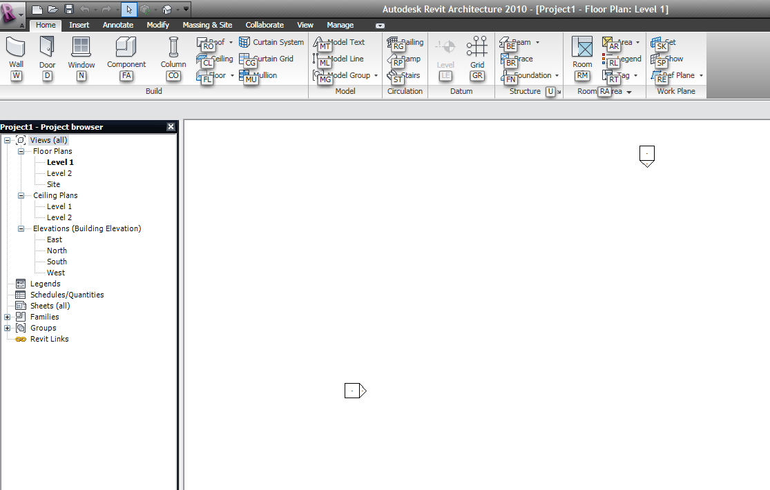

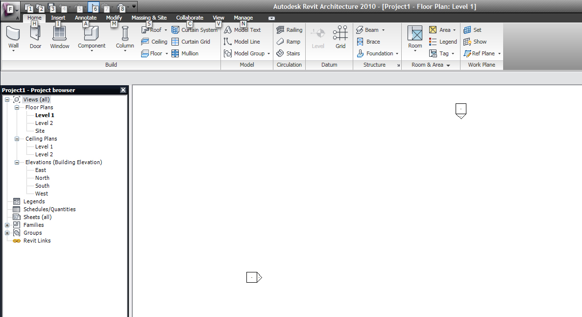

wys1wyg: the alt key is your friend; pressing it will display keystrokes to move through the ribbon, thereby bringing up the next keystroke.
i know this is blasphemy, but it does behave a bit more like autocad, in that you use a combination of mouse and keyboard commands, versus the old ui, which was much more mouse-based.  yes there is that extra keystroke to select the proper ribbon, but i think the superior organization and consolidation of tasks makes up for it.
