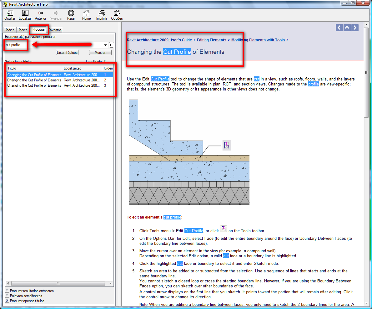

Thu, Jul 16, 2009 at 3:48:34 PM | Question re: Model Performance vs modeling habits
NO - I mean Edit Cut Profie!
Look in your HELP - Search "edit cut" - and read Changing the Cut Profile of Elements

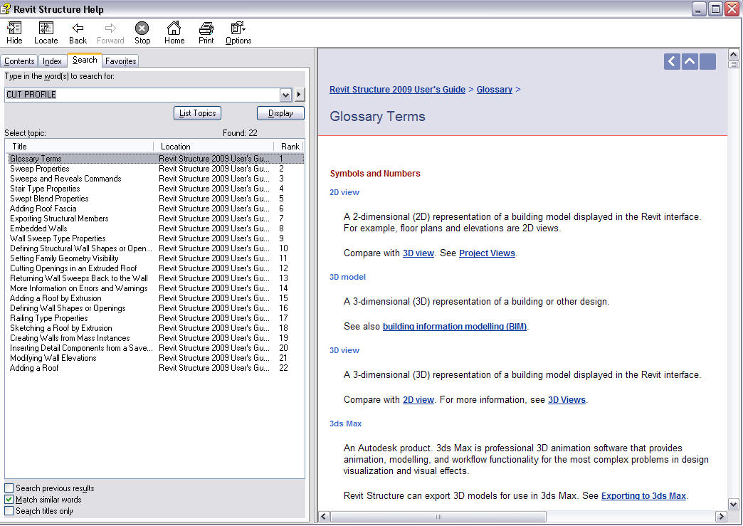

Well, I tried searching for "edit cut" and "edit cut profile" and neither came up with the page you mention.  Is this something new for 2010?  I am using structure 2009.  Thanks.

Edit cut profiles been around since I think the beginning and it is in your HELP.

Quoting WWHub from 2009-07-16 16:32:31
"Edit cut profiles been around since I think the beginning and it is in your HELP."
While I appreciate you repeatedly telling me that it is in the help file, i can assure you that it is not.  I have the entire help file in PDF format, all 1600+ pages.  A search of the words "cut profile" results in no section describing the tool or its use at all.  It would have been much more helpful if you had just told me where to find the tool instead.
After searching through all the pull down menus, I did find it in the Tools pull down in RS2009, and it was called Edit Cut Profile.

"A search of the words "cut profile" results in no section describing the tool or its use at all." - i don't know in Struct. but in Arch. it does....

In Revit 2009 Structure, the help files don't look anything like what you just posted Typhoon. I attached a pic of what ours looks like and we certainly don't see what you do.
