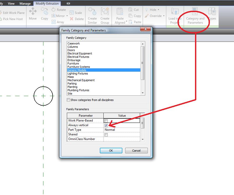

Did you uncheck this in the Family categories and parameters?

Third ... in the family, under category and parameters, there is an "always vertical" switch.  I think you want to turn that off for this item.

Unchecking the always vertical works...unless you locked something to the host surface....

If all you want is to rotate a family in any direct one at a time, please do the following:
1. Get a family (either create/copy a family)
2.double click the family ( to enter family edit screen)
3. Go to Modify (Modify| Extrusion)-> Propoerties ->Family Category and Parameters
4. Uncheak "Always vertical" (and click ok)
5. Go to Create ->Work Plane -> Set
6. Specify a new Work Plane to "Name" and either of the axis you want to the right (then click ok)
7. double click the family ( to enter family edit screen, modify tab)
8. Go to Modlify (Modify| Extrusion) -> Modlify -> rotate
9. click and rotate (accuracy based on angle degree)
((tested in Revit 2013))
sidenote: with 4yr.. no 4 days of revit experiences, I hope it is the solution you guys wanted.

Ok i finally figured it, the guy above was on the right track but forgot one vital piece of info
family editor: > Modify > Family Category and Parameters > check "Work plane based" as well as unchecking the always vertical box !
5. Check Work Plane-Based
6. Go to Create ->Work Plane -> Set
7. Specify a new Work Plane to "Name" and either of the axis you want to the right (then click ok)
8. double click the family ( to enter family edit screen, modify tab)
9. Go to Modlify (Modify| Extrusion) -> Modlify -> rotate
10. click and rotate (accuracy based on angle degree)
Im not being funny or anything but, thats a ridiculous ammount of operations and things to remember....After 8yrs experence in solidworks. It makes revit look like a crayola version of a 3d package for kidsPuh maybe afew more years down the line it will be better but now its a pain
