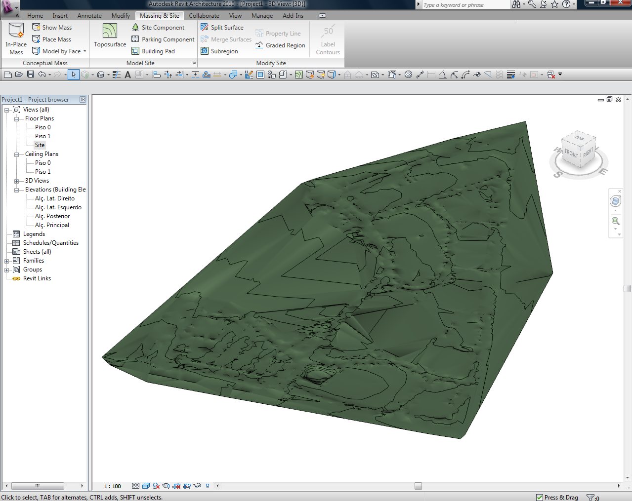

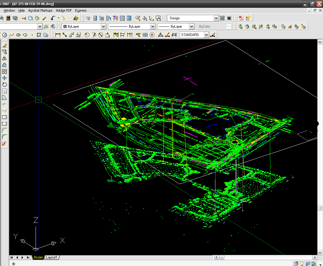

1. The survey as it appears in ACAD, in 2d
2. ...and in 3D..

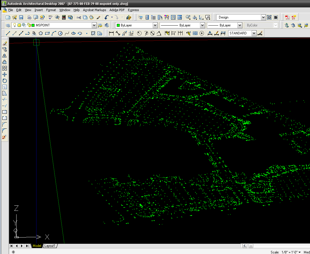

3. ..and that layer mspoints, in 3d
As you can see in no.2 above the dwg was never intended/cleaned up for making a full 3d topo map.

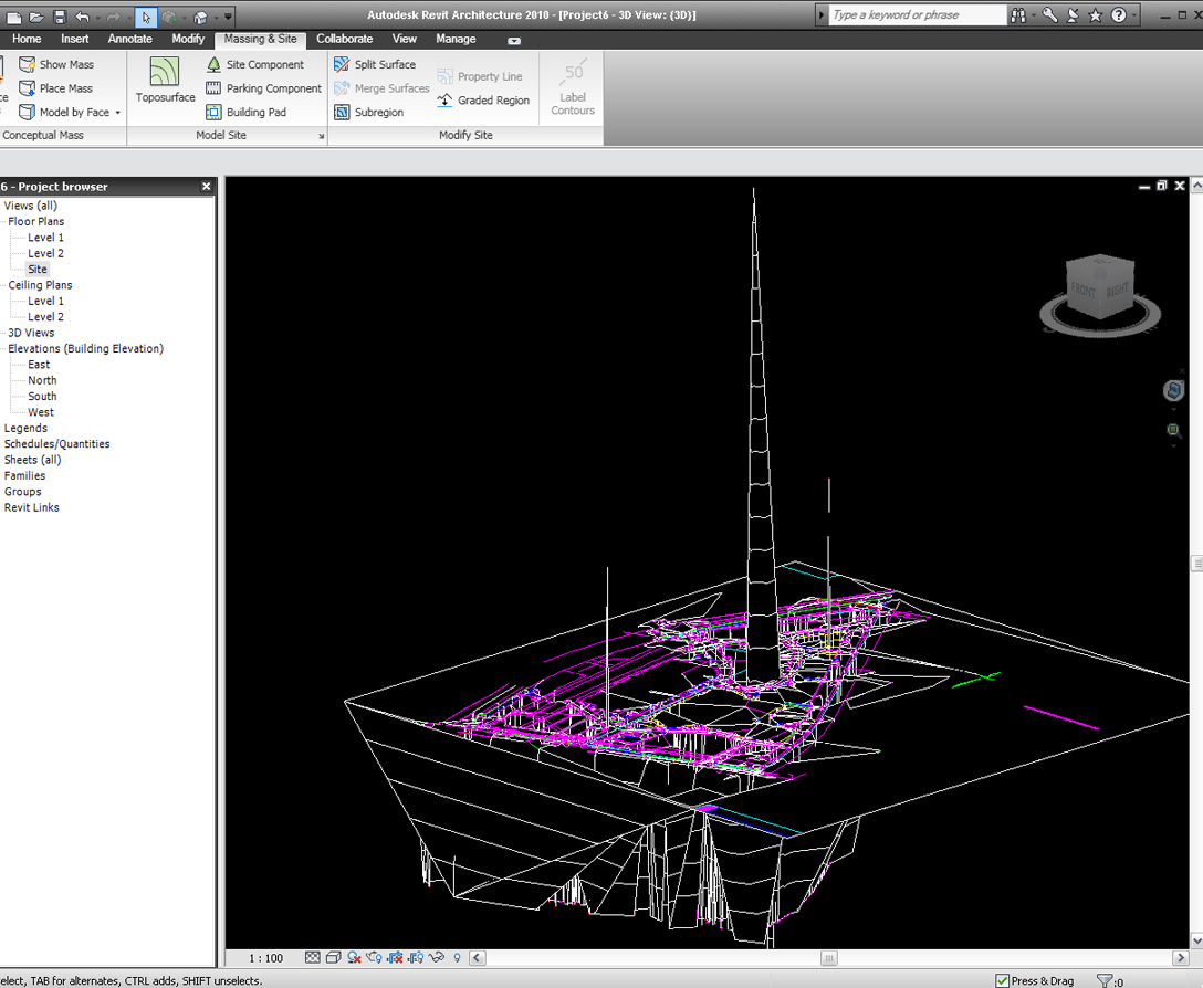

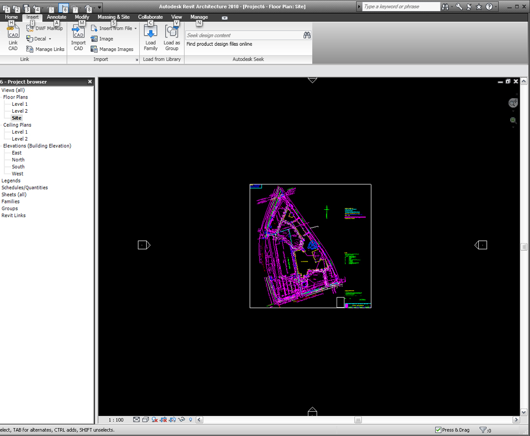

Now, this is how things appear in Revit ; I 'm on the "Site" view, I do the "import cad file", auto-centre,  current view UNchecked, and all looks ok...
5. Cad file imported to Revit
....but its not:
6. MSpoints layer is missing but every other useless layer isnt; when i go to create a topo map, Revit seems to not see the mspoints themselves, and just generates something fairly messed up...
Even attempting to specify the mspoints layer only when im porting doesnt work - revit doesn't see them :/

Perhaps you could upload the CAD file if it's not to large.  I would suspect that the actual points are on a different layer and that you could create the site using all the layers - let Revit decide which layers to use.
Mon, Jun 1, 2009 at 7:18:05 AM | Tricky one- Importing Site Survey: Not the usual issues...
It sure does look like you have a mess.  Have you fully read the HELP file - Creating a Toposurface from Imported 3D Data ?
By the looks of the first few images, the CAD file is not correct and needs to be cleaned up.  You need to make sure that the 3D data you want to use is all isolated on their own layers.  There also appears to be points that are way out of wack elevation wise.

The third image actually does show the 3d-points layr (mspoints) in an isolated drawing. In ACAD i can view it in 3d and everything looks fine, no daft tall spike or anything.
But, when i insert this drawing nothing shows up.
Im attaching that particular file now; if you can get it to work in Revit I'd love to know!
