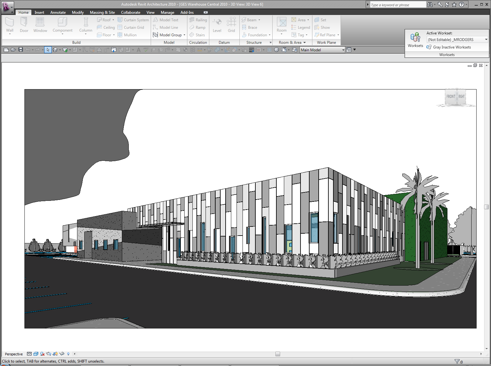

As I posted in another thread....  Because knowing what workset you are in is important and is no longer always shown, I ripped the current workset off the ribbon and pasted it to the right of the ribbon amd almost off the work area.  If you try to go too high, it just re-attaches to the ribbon.

Coule you please explain how it is you customized your ribbon tool bar?  I read you're post and it's nice that you can do that, but for those like myself who don't know how; can you please explain what you did to customize it in that way?
I like to read into these forums first thing in the morning to start my day.  I like to gleam bits of knowledge when I can to implement into my daily use of Revit.  This seems like a pretty interesting concept.
No doubt I'll be checking back in on this thread.
Thanks!
Fri, May 8, 2009 at 8:03:29 AM | 2010 Ribbon Customization...What are you doing?
Sure !
  1. Click on the manage tab on the ribbon
  2. Left click & hold on the bottom bar of the Design Options section and drag that down into your drawing window.
  3. Now you can experiment with how far you can drag that back up before it jumps back onto the ribbon.
  4. Once you have this placed, it will remain there no matter what you are doing and it will be in the same place the next time you start Revit.
