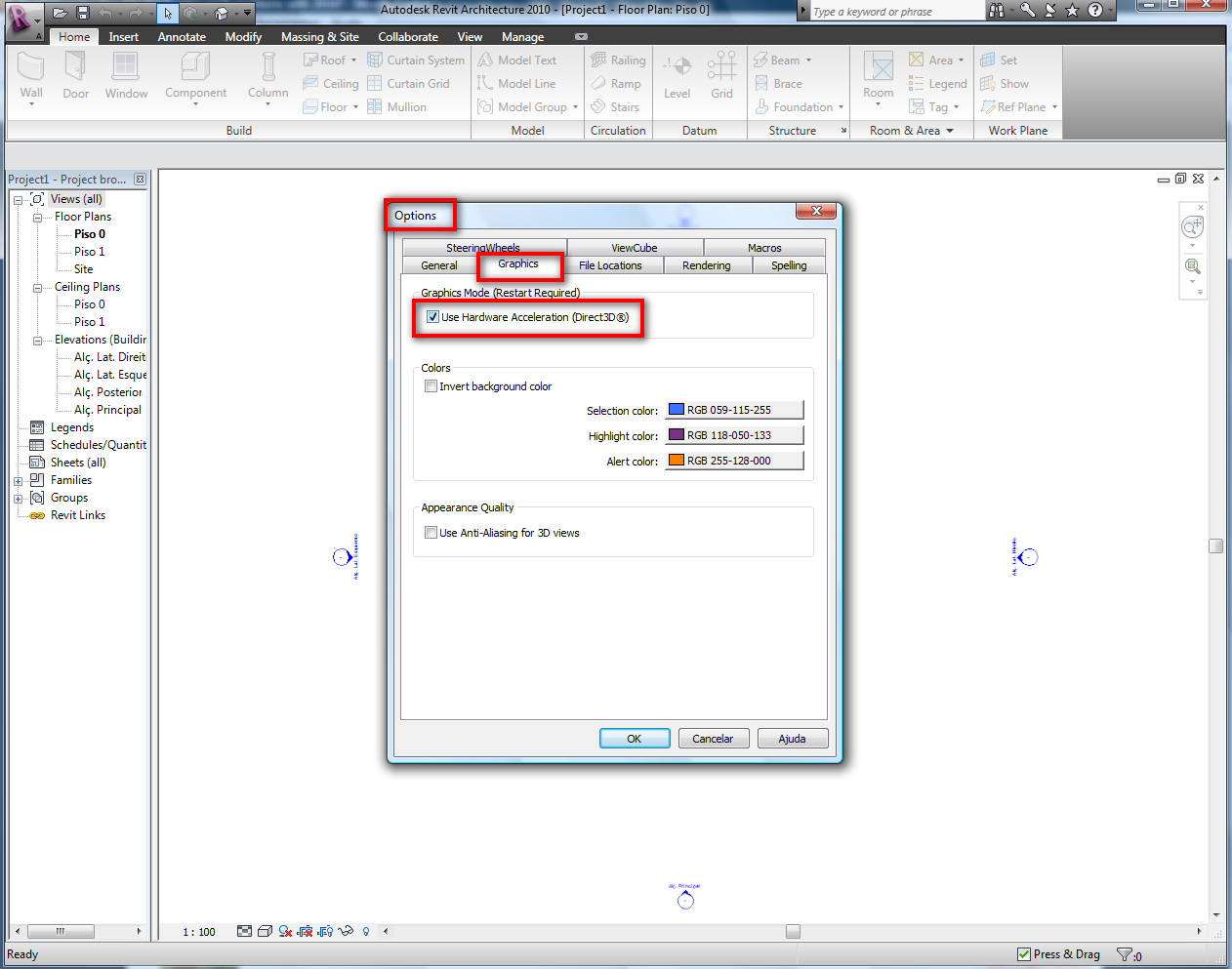

Hi, did you have your graphics card driver updated??? Are you working with "Use hardware acceleration (Direct3D)" ON????
Try to UPDATE your drivers and turn OFF the Direct3D....

Yep, did all of that and still having problems

5. Disable hardware acceleration within Revit options
a. In our own trials, we found this to reduce performance.
