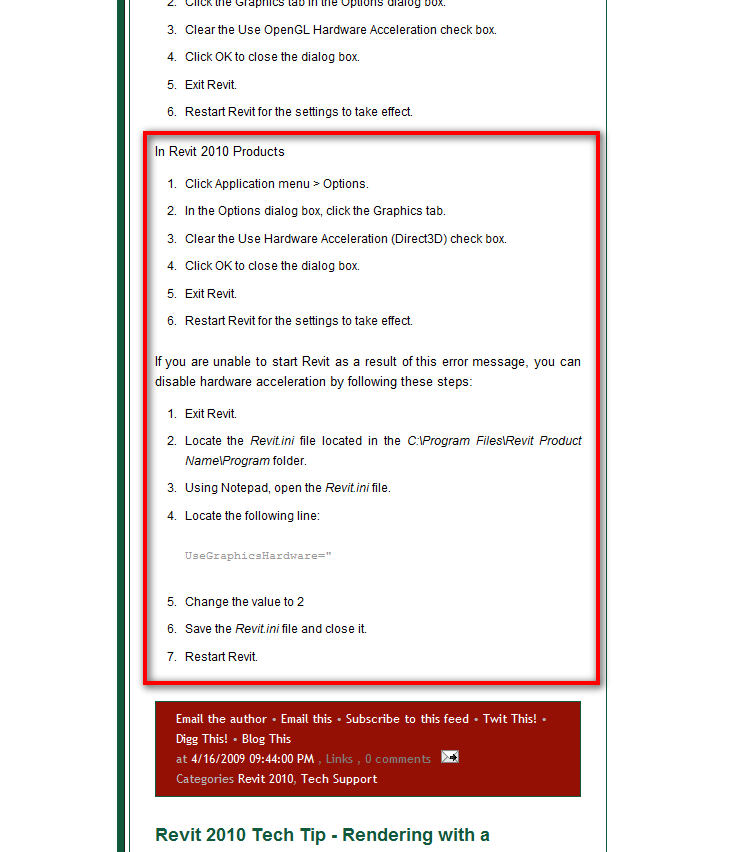

Sat, Apr 18, 2009 at 11:25:05 AM | Revit 2010
Joined: Tue, May 22, 2007
5921 Posts
4 Stars: 205 Votes
Hi, I don't know if this solve the problem but look this from other blog:

In Revit 2010, it is very important to ensure you have the absolutely latest drivers for your video card...

Teh crashing is most probially caused by old drivers.  Revit 2010 now uses direct X hardware accelaration, ensure you have the latest drivers for your graphics card. Revit 2010 actually runs faster that 2009 on my PC.

I had many issues at first with 2010 and performance but now that I am using the latest nvidia drivers I am having better performance than any previous version using openGL. When I have Direct3D enabled I can pan, zoom, and rotate faster than ever even with shadows on. Much much faster.

Checked my driver for the latest updates on the nvidia website and they were up to date (Intel(R) G965 Express Chipset). The check box for Direct3D was not checked, although I have no idea what that does anyway. Anybody have any more ideas?
