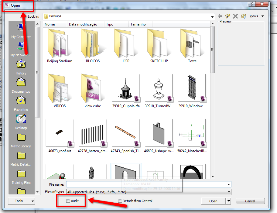

Did you try to "Audit" the file????

I actual don't know how to audit it, but I did purge. I sent in an error report and CAD sent me back an update that I needed. Luckily after hours of trying to figure it out on my own, this fixed it. Thanks for your response.

FYI... Audit

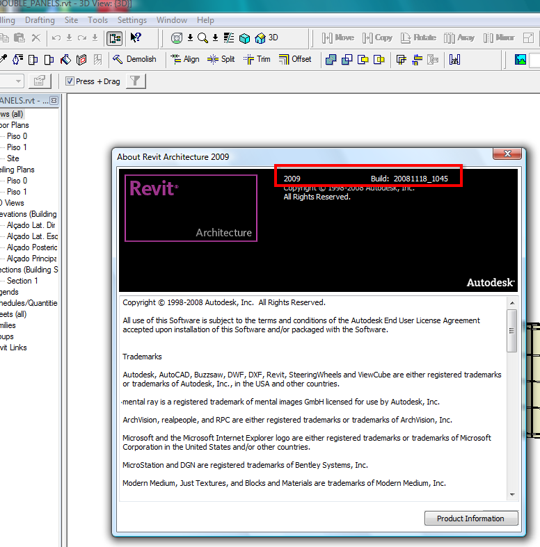

Specifications of your machine please (Ram, processor, O.S., etc)???? did you have the last Web Update 3 ???

ok well i have 3G of ram and I am running on Windows XP. I am using an HP Pavillion and I have an Intel Core Duo Processor. I do have the latest update and I have tried downloading 1 & 2, but i get an error saying that it cant find the specified program. thank you so much for your time.
