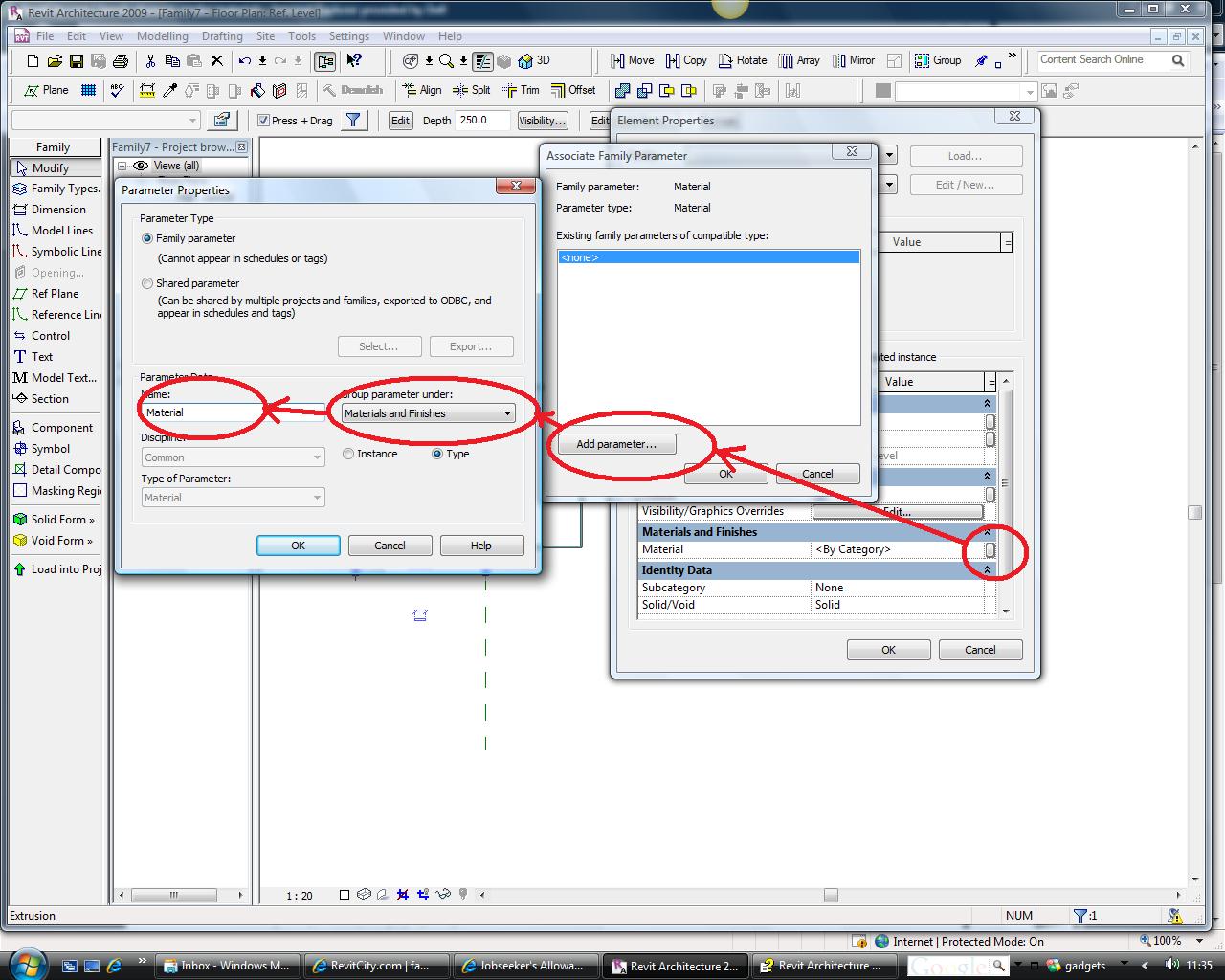

would someone please list for me the steps for changing
the render material on a family element?
it would go something like:
1. highlight the family element..
2. click edit family on the options bar..
3. click open for editing..
4. click family types?
5. materials and finishes?
6.?  7.?  8.?  ?  ?  ?  ?
spank you all..

6. Click the button on the right.
7. Add a parameter.
8. Select a group under which to list it.
9. Give it a name.
10.  Select whether it would be an instance or type property.
11.  Close the dialogue boxes.

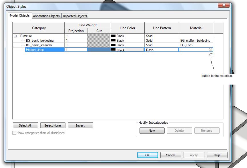

i don't think this is the way to go.
 1 make a new object style in the family.
2 give this object style a material
3 go to the elements of the family and give them the correct object style.
 When you're in a project now, you can change every material you want just bij selecting object style's en change the material.
 This way you always keep the correct material names. and can change things easily.

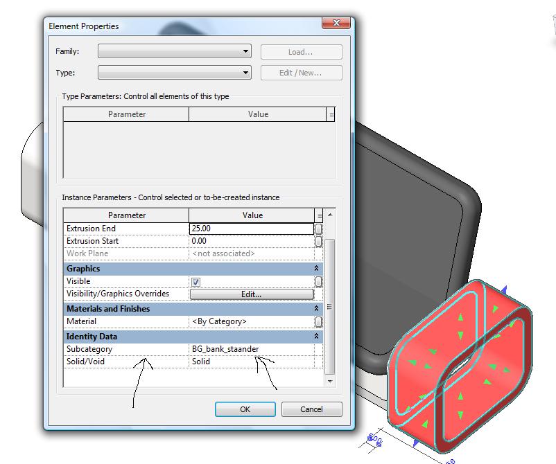

WY,
 Go to "Settings" Then "Object styles" and make a new object style. (give this a distinctive name)
When you created a new object style go to the last horizontal box. (click in the most right corner of the box) (see pic)
Now you are in the material window. duplicate a material and give it a recognisable name.
Now select the part of the family you wanna give a material. Go to the elements properties.
and change the subcategory. (this is linked to the objectstyle you made.) (see pic)
When you are in a project now you can go to settings-> object style's again select the kind of family you made, select the good subcategory and change the material.

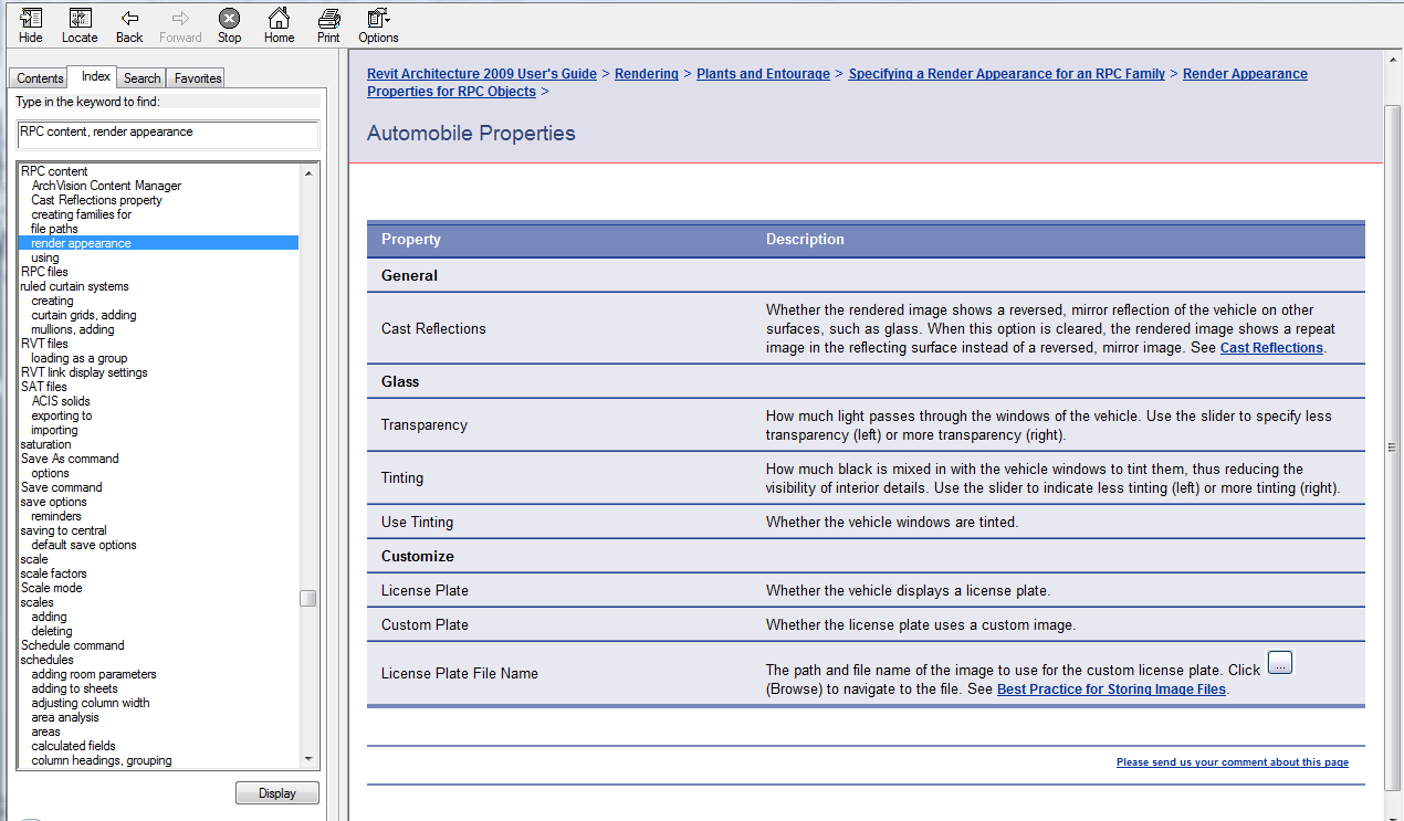

Hi WYS1WYG, I think that nobody has explained to you, what is a RPC file.....ArchVision realpeople, cars, trees, etc, are pictures of actual people and/or objects from multiple angles that display using a technique called image-based rendering. They are part of ArchVision's RPC (Rich Photorealistic Content) product family. This means that you can't change the main part of the models (materials, clothes,etc.), only certain properties (see image taken from the help menu related with your car's properties), there's nothing about changing its color, isn't it?. If you want cars with materials that can be changed by you in anytime, why don't you check in the Download section of this site, there are lots of them and better than the yellow one that you have right now....
