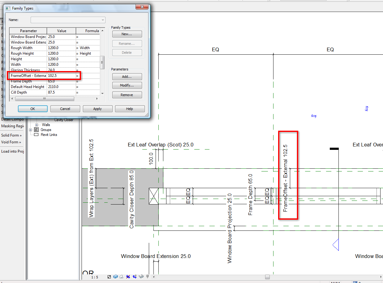

When you pick in the window and go to properties, don't you have a "FrameOffset External" parameter to "Push" the window to inside/outside?

I am a bit unclear on the proposed solution.   Are you proposing that 2 walls are built and then joined to achieve this?  I also do not see a "Frame Offset External Parameter" in the window settings.

There's no FrameOffset in the properties of this window family.  I do have a "Wall Closure" option in the parameters, but that doesn't solve the problem.
I'm really at a loss.  Leaving the window as drawn will get some strange looks from the guys in the field.  I want everything to be as accurate as possible.
Do you have a family with the parameter that you described?

There it is.... with this you can control the position of your window in the wall...

Thanks for posting that.  It's not quite working for my current project.  I'm trying to figure out how to modify the existing double hung window family so that the window is tied to the exterior face of the stud wall sheathing.  That is how it will be built on site, and showing it as such on the drawings would be most accurate.  I'd be taking a big step forward if I could figure out how to create the correct parameters to control this.
There has to be a way to make it work properly.
