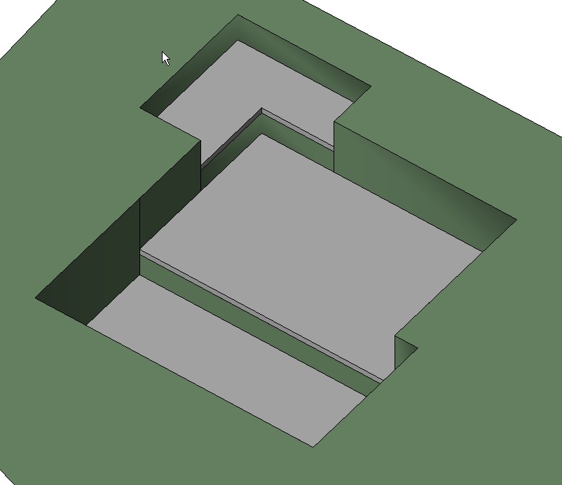

I really don't know what your problems are.  Here is a simple little test with three pads at different elevations.  Each pad is defined with part of an edge at the same location as another pad.   NOTE: They do not overlap but the do have a common edge.Edited on: Fri, Feb 27, 2009 at 2:50:34 PM

I understand how pads work, and i think that they're a great concept, but i, as well as others that i've spoken to, have the consistent problem of them "ovelapping."  what's so strange is that 1, they do not overlap, 2, there is only ONE pad in this particular drawing i'm working on, so for it to be overlapping another pad is impossible, and 3, by deleting this erroneous pad i end up deleting a generic model that's completely unrelated.  it makes NO sense.  But, I know i'm not the only one who has had this problem.  Several other people I've spoken to have had the same problem and similarly refuse to use pads.

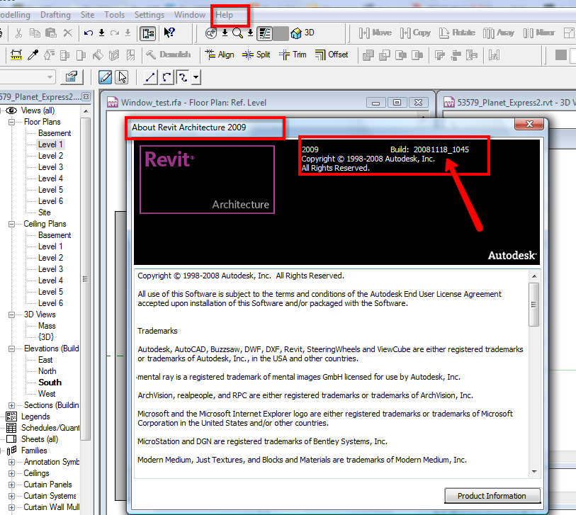

I know what are you talking about, i have another guy who post the same problem a few months ago, you are using RAC 2009 right??? and the "Web Update"????

I'm not sure what you're referring to with the "Web Update", and i'm using Revit Architecture 2009.  I've never heard it called RAC 2009.  Is that something different?

Well RAC 2009 is Revit Architectural 2009, the web update it's like Service Pack for Revit, like you can see in the image attached you can go to Help and in "About Revit..." you can see the LAST service pack, you have the same???

okay, i checked and no, i don't have the same version.  I just spoke with my IT personnel who suggested that I can either update it now, or get 2010 in a little over a month... i think i can wait for 2010.
