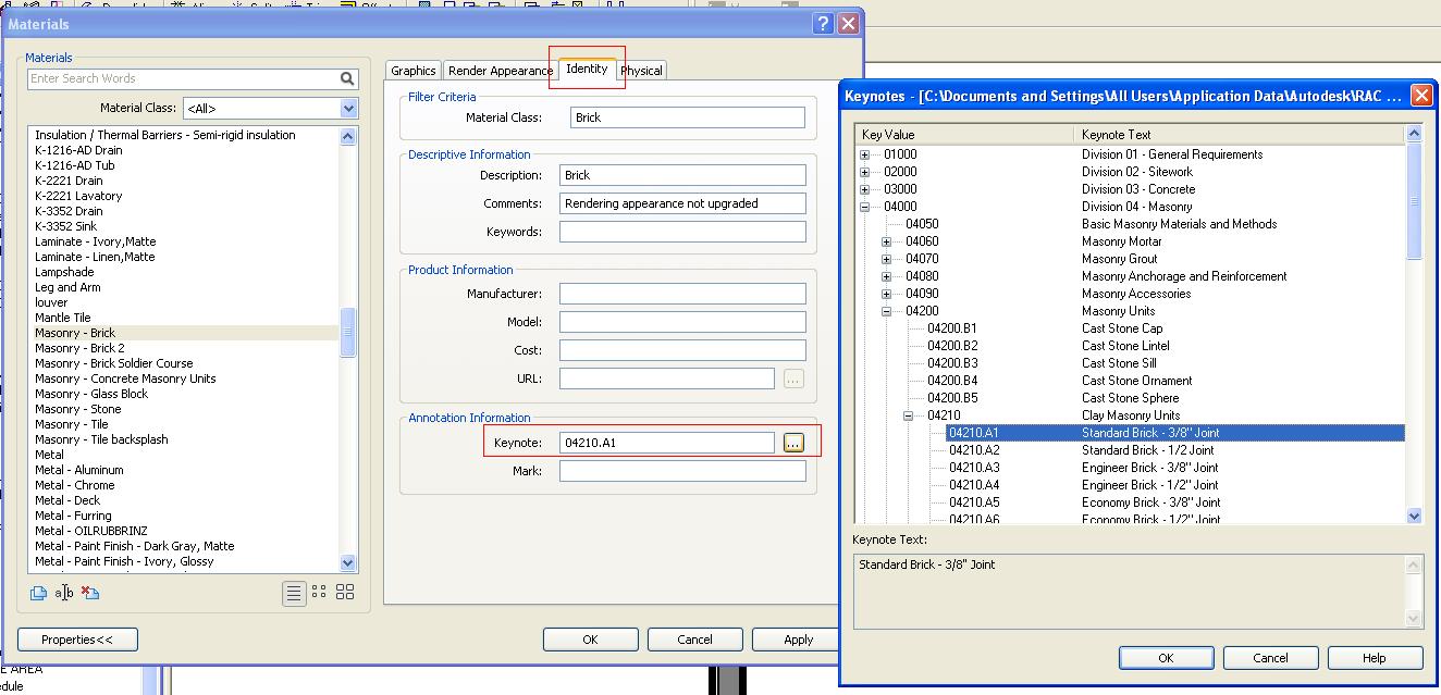

I understand what you are looking for. I don't use a Keynote schedule. I will just use Keynote Material. By using the material keynote you can assign the keynote as part of your material library.  See image. If you make it a "standard" to use the Material Tag then any time a material changes you will see it everywhere. Now if you want a schedule or "legend" of the keynotes that will be harder. The issue is how to number the notes. "By Sheet" or "By Keynote". It really depends on what you are looking for. I don't use the keynote legend because I use the Keynote Tag:Keynote Text. Hope that helps.

did look like the image attached..

image was too large.. Smile

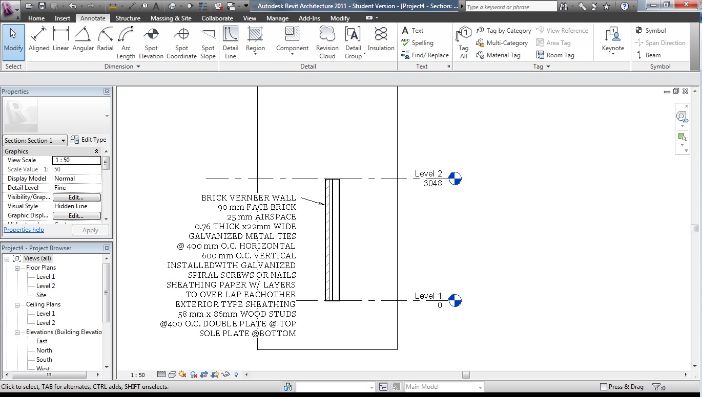

Is there some way to tag or keynote an entire wall type at once?  I want to be able to have a muli-line block of text on my wall sections for each wall type instead of each material having its own note and arrow.  The closest I have come is making text a group.....however the leader is grouped as well and doesn't work at the same position in every wall section.  I'm tired of spendin an hour changing one word in 100 different places.  Any help is much appreciated!

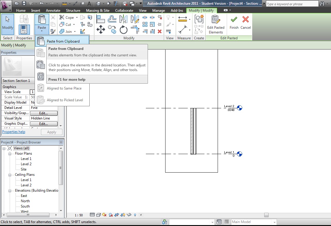

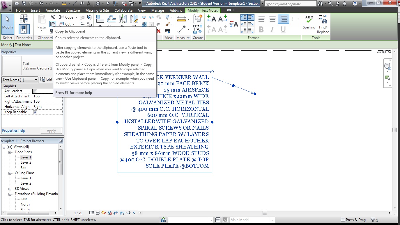

I have been trying to acomplish the same thing as yourself and the best solution I've found when creating a full wall description with is to create a seperate revit file with all your descriptions and construction notes ect. done with the text tool; than with that rvt file open you can copy the txt to clip board and and paste your canned descriptions or whatever in to your drawing from the modify tab.
Thu, Mar 17, 2011 at 8:58:13 AM | Annotating Building Sections/Wall Sections/Details
#14
100569147
Joined: Sun, Oct 10, 2010
2 Posts
As per my previous post i just discovered that one cannot copy from say an elevation view of one project to a sheet of another.
the bottom line: sheet to sheet
          or           everying else to anything else
