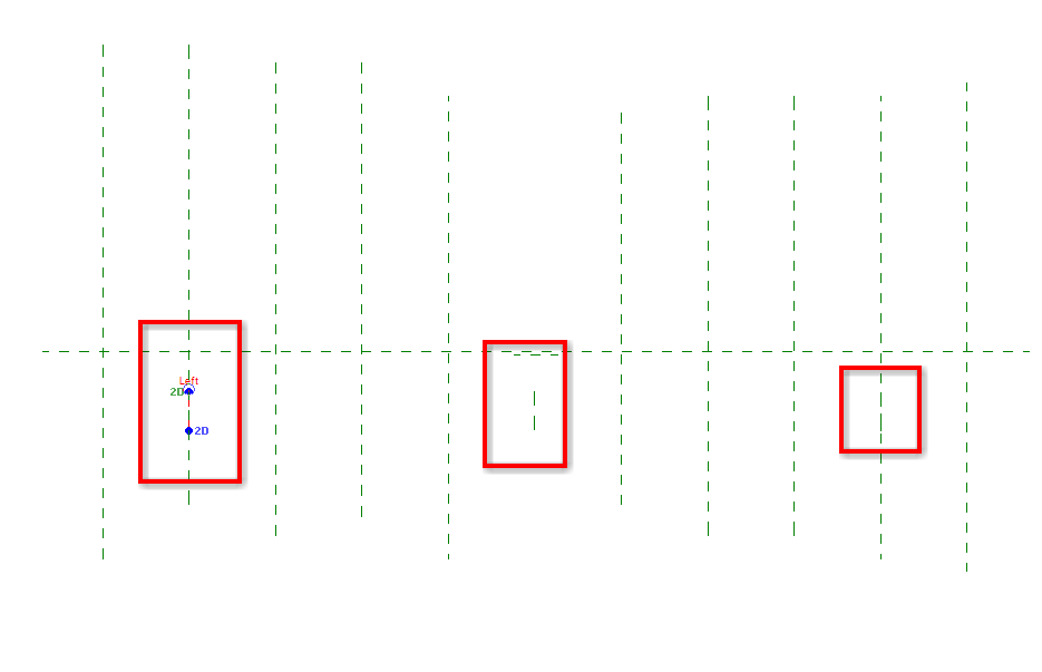

OK I figured out how to do this for a 8 panel parametric family. With the help of a friend and now a month later I'm trying to make this a 6 panel parametric family but I keep getting errors. Can one of you take a look at the file and tell me how to get rid of just one panel in this door family.  Everything is attached to ref lines or planes.  my problem is a ref line that make the door tracks a specific length each time I remove one of the panels the door tracks get screwed up.
I attached the door family.

Hi, this is the door, you must change the "Rails", you have "Ref. Planes" (Left, Center and Right) but you create another ref. planes over this "Principal" ref. planes, and in plan view you dimension (left, center and right planes) but you "Constrain" the elements to the others ref planes, don't do that, use them...

OK I see the ref plane that is over the left and right planes. I removed the unnamed planes then removed a panel from each side and its ref plane so I now have 4 planes on each side.  Then I'm trying to EQ each side of the door but it will not allow me because of the width constraint. Do I remove that constraint?

Sincerelly "DANPOOLER"? i delete almost of your dimensions and create new ones because i don't know if those dimensions are "locking" what??? so, when i'm not sure I "Play" for security and create all new...
