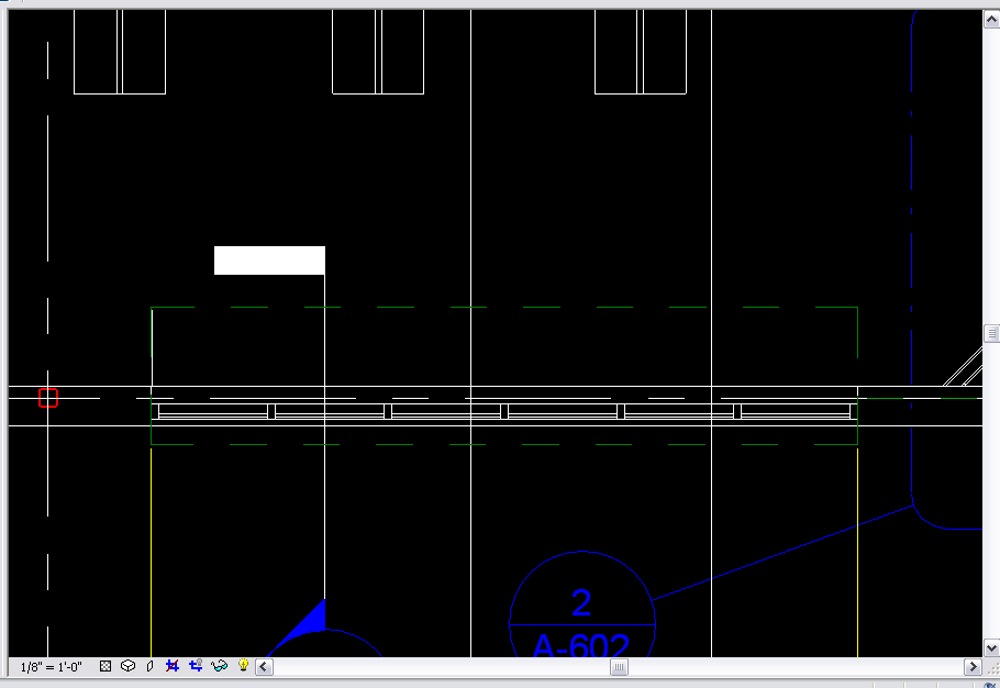

Simply put I want to be able to show a high window above the typical cutting plane of the first floor plan.
So of course I went about making a plan region.  Well that works showing the window but also removes any detail in the the rest of the exact wall.  The detail is seen in the plan region as it should be. Just not outside the plan region. It effects only the wall being "regioned".

heres a picture
The wall being cut with a plan region is becoming.... invisbile outside the plan region.

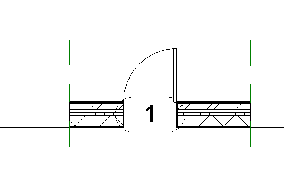

Yeah, i put that image to you see what i did, i just change the "View Range" of that "View Level" and change the the "View Range" in this "Plan Region"...

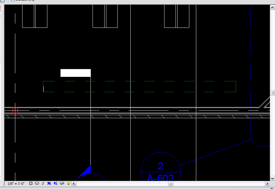

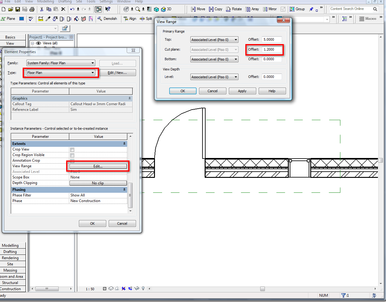

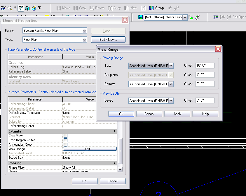

I tried lowering the top of the floor plan view range as you said.. and didnt get any results.
Here are four picutres.
First two picture show the same... wall same view ranges... one without the plan region on the wall and one with the plan region on the wall.
Last two are showing my view range settings. Which by them selves work as intended.
It is when the plan region cuts into that wall and only that wall that it removes the outside detail of the wall.

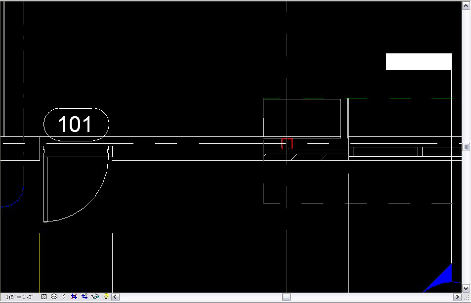

Hi, problem solved, see the video: http://screencast.com/t/TVK7CeT4lfL
i also attached the file changed so you can see the values in the view range of the plan view and the plan region...
