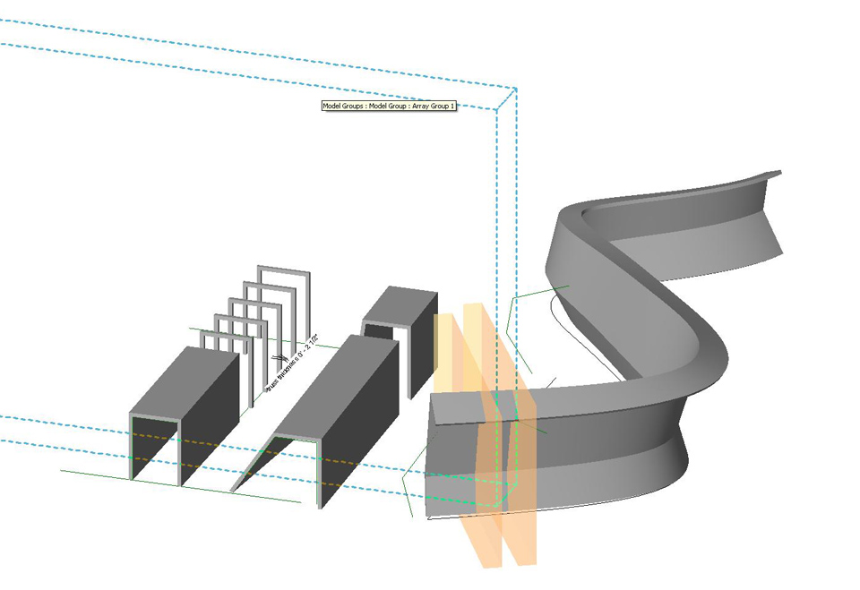

Hello everyone,I have created a swept blend along a spline curve. Now I want to cut it up into many individual truss-like segments. I want to use an array of voids to do this, but how can I get the array to follow the geometry of the path of the blend? This is easy in rhino. Seems in Revit there is only straight array and arc. Any ideas?

I am designing a bike rack that is to be installed in various places on a large corporate campus. The bike rack will consist of series of looped bars coming out of the ground (like upsidedown "U" shapes, but they will actually be made from straight sections probably). I will call them rungs. I want the rungs to array along a curved path and I also want them to each change their profile incrementally along the length so that it represents a gradient shift of profiles from one shape on one end, like a low fat U to another shape on the other end, like a tall skinny U. The way I have attempted to model this so far is to create a swept blend from one shape to the other. Then I array a series of voids along that same distance. When the voids cut the blend, what is left over is a series of bike racks, each changing shape a little bit over the distance from one profile to the other. Furthermore, I set up reference lines and locked the geometry of the sketch to them so that I can drag the reference line's position and each element's profile of the whole blend updates instantly. The problem is that the bike rack in the project does not follow a staight line. So while it is possible to create the Swept blend along any curve, I then cannot array the voids along that same curve to cut it leaving the individual rungs.Something like a railing family will flow along any path I know, but then how would I get the change in each element without something like a blend between two shapes?Another problem that I am having is that the changing of the reference lines driving the geometry of the blend only works when the reference lines are at random non-90 degree angles. If I try to set up the reference lines to vertical and horizontal starting positions, then after I have made the blend, it won't let me change the reference lines out of their orthogonal position. I get "constraints are not satisfied." It will let me change height or lateral position of reference lines, but I cannot grab an endpoint and pivot the line out of perpendicular/parallel. (also if The blend starts on ref lines that are non orthogonal, then when I pivot the ref lines to an orthogonal position, I get the same error)Whew! If you can help I would really appreciate it. I am somewhat new to Revit, but am an accomplished digital designer in other software. I look forward to contributing advice when my Revit skills get up to snuff.Thanks!

I am able to do what you did in the video no problem, but instead of just one bar locked to one reference line that is being extruded along the blend, I have three segments attached to an "arm" of three reference lines.  (see middle form in attached photo) So after I finish the sketch, I can grab a point of the reference arm and pivote one of the reference lines and the whole blend updates.  The problem is  that this free-form changing of the reference lines driving the geometry of the blend only works when the reference lines are at random non-90 degree angles. If I try to set up the reference lines to vertical and horizontal starting positions, then after I have finished the sketch, it won't let me change the reference lines out of their orthogonal position. I get "constraints are not satisfied." It will let me change height or lateral position of reference lines, but I cannot rotate the reference lines about their endpoints.  I cannot grab an endpoint and pivot the line out of perpendicular/parallel. (also if The blend starts on ref lines that are non orthogonal, then when I pivot the ref lines to an orthogonal position, I get the same error)"

But no I do not think this is the problem.  I am in fact only rotating the reference lines on the same plane on which they were created.  The weird thing is that I can rotate them to many different random angles, but not vertical or horizontal.  When I rotate them near to vertical or horizontal, revit helps me snap to exactly horizontal or vertical.  But then right away the blend turns yellow and I get error message that constraints are not satisfied.  Also, if the original reference lines are created in a vertical or horizontal position and then I lock the blend's geometry to them in that condition, then when I try to rotate them out of the orthogonal, I get the same error message.  Here, you try it, I am uploading the file.  Just tab to select the reference line, then grab the endpoint and rotate down until it snaps to vertical.  See what happens?

Hi, see the video, i think the problem is you don't "lock" every lines between them and in front view you don't "Align" the object in the left and right to the ref. lines, i attached the model changed....

It works!!!  Thank you SOOOO much!  I see the problem.  I really appreciate your help.  I promise I will contribute to the forum as I get better with Revit.
