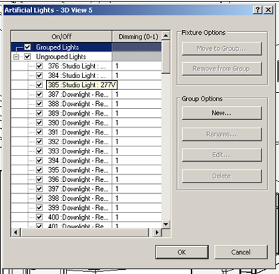

Hi everyone, I am having some problems with an interior rendering I am working on.  When I go to render the interior scene and select interior sun only, my rendered image appears to have sun only.  When I render the interior scene and select interior artificial only, I get a scene with artificail light only.  Here's my problem, when I select interior sun and artificial, the rendered scene appears to be sun only and no lights are rendered.  Last week I rendered a interior scene of a kitchen using interior sun and artificial setting and the rendered image came out great.  I can not figure out what is wrong or what I might have done to cause this.  I am stumped.  Can anyone identify what I might be doing wrong or what might be causing this to happen?

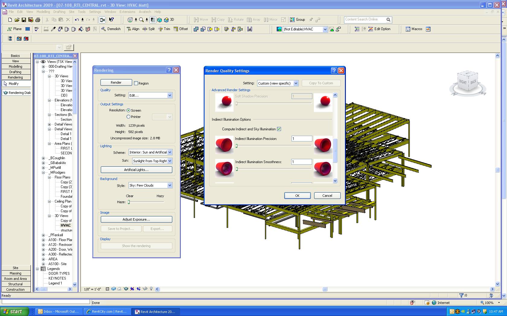

Attached are the rendering window settings plus other snap shots of settings within the rendering window.
44033_Rendering_window.bmp44033_Artificial_Lights_window.bmp44033_Exposure_Control_window.bmp
Wed, Sep 3, 2008 at 1:05:18 PM | Revit 2009 interior rendering isue
Kwotect
Joined: Mon, Sep 17, 2007
14 Posts
Additional settings

That is hard to see, but I doubt it's a sun setting anyways. When you render does the render dialogue box locate the artificial lights? Are they all checked in the lights dialogue? What happens when you set the sun settings to a night time setting?

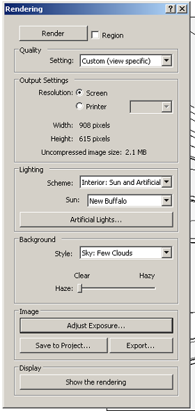

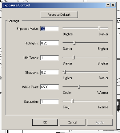

Attached are larger images of the setting windows.

When I render the scene with interior artifical only the dialogue box locates 75 artificial lights.
When I render the scene with interior sun only...no lights.
When I render the scene with interior sun and artficial the dialogue box locates 36 artificial lights and 605 portals.
Yes the lights are all checked.
I have not tried rendering the scene at night.
