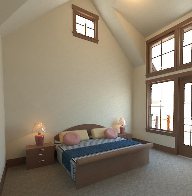

I am runing some test renderings for a project I'm working on and I am having some problems with the sun intensity on interior renderings I'm running. I have uploaded one medium+ quality rendering with window portals enabled. The image (attached) comes out almost a wash around windows with the sun being overly powerful. Is there any way to lower the intensity of the suns output. The sun is essentially powerful enough to white out any window completely making them look very messy and washing out all colors outside and anywhere the sun hits directly inside.
Right now I have the settings running Interior renderings with artificial lights enabled. I have the exposure set to about 9 in this shot with the saturation set at 1.1. I'm hoping that maybe there is a way to tone it down a few notches that I'm just missing. This would seem like a simple fix but I'm just not finding it, any suggestions would be appreciated.

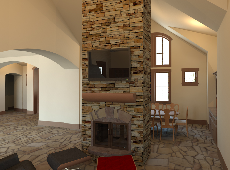

I am trying to show in most of the renderings what the sun will be doing at certain times of the day. The first image is in the morning @ approx. 10am and this second rendering is showing an afternoon sun @ approx. 2pm. I dont really have much freedom to change the time, but I have tried a few just because you suggested it. The only way I can get the light intensity down is by dropping the sun past the horizon and basically making it night or near dawn. This kindof changes the colors for the worse though and I just dont think its going to fly. Looks like its back to the drawing board for me...

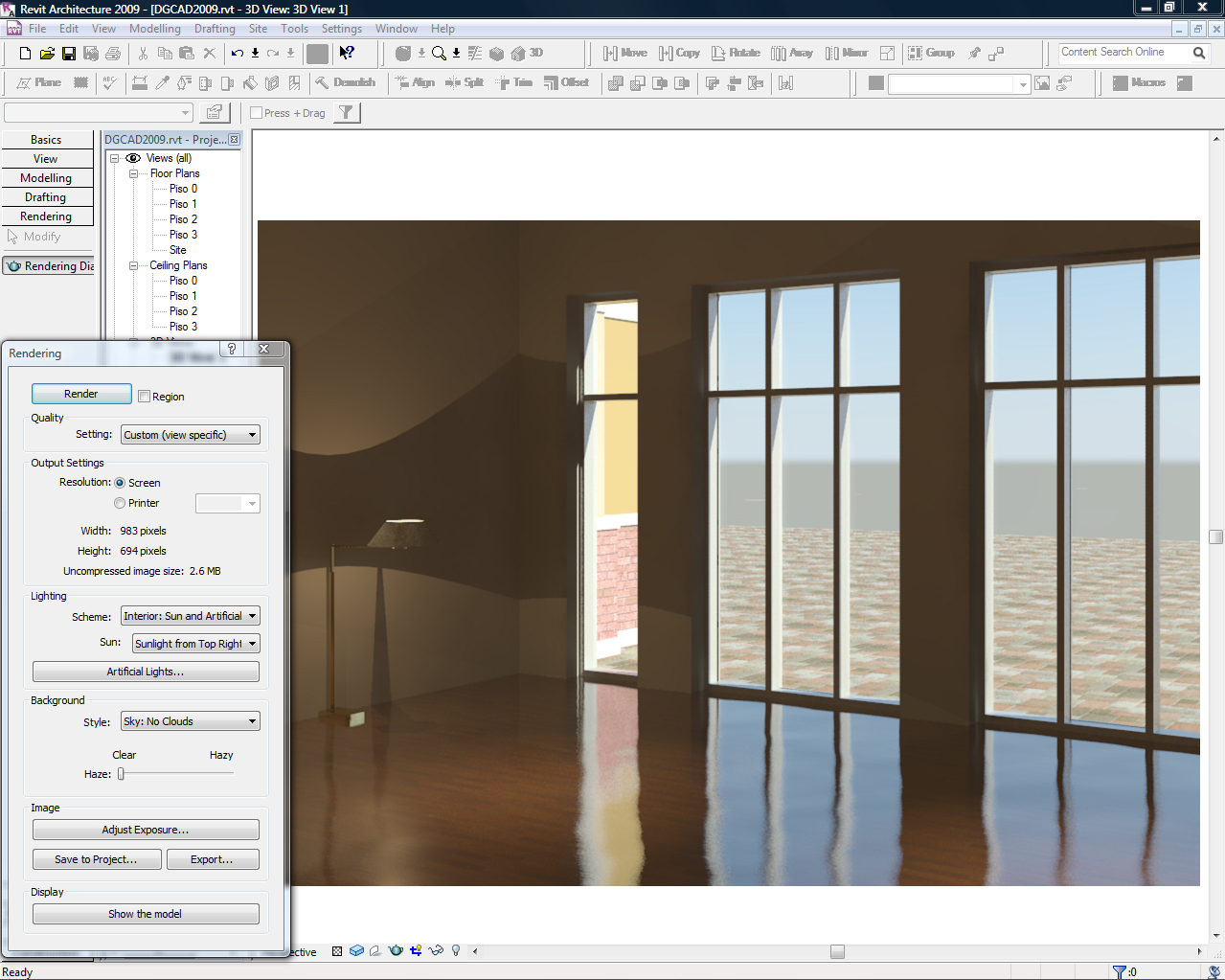

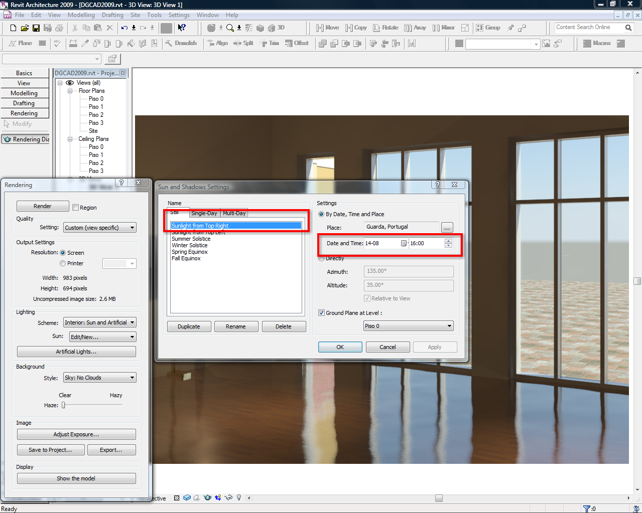

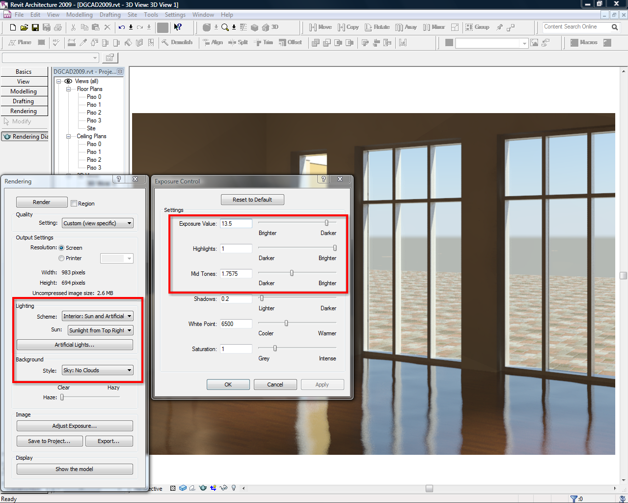

Hi, what i do are, first create a render in "draft" mode to don't waste much time, then i go to the "Adjust Expose" and "play" with these parameters like you can see in the second image, then create a new render with only "Medium" resolution, like you can see in the images attached, you also, after render can change and play with these values until you have the "Perfect Image"...

I basically think that I'm getting the gist of it now. It still seems like a pretty odd way to have to expose the picture but I've just been making the interior light far more powerful (light intensity), as Lizard has suggested. Seems that having a Sun intensity setting would fix this a heck of a lot easier, but I know how the guys making revit work for the most part, backwards. At any rate, I have one running now that looks like it will be turning out a bit better, can finally see the ground outside and everything inside is still lit well enough. Thanks for the suggestion Lizard, might just save me from having to use 3ds max!

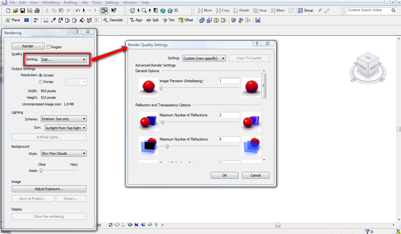

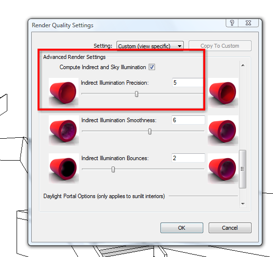

How do I get to the "Render Quality Settings"  as mentioned by Typhoon. Thanks in Advance - Thom
Sun, Feb 8, 2009 at 4:40:01 AM | Interior rendering sun intensity
#14
tim123
Joined: Tue, Apr 12, 2005
1310 Posts
4 Stars: 19 Votes
In the render dialogue box go to settings and edit.
Sun, Feb 8, 2009 at 12:30:16 PM | Interior rendering sun intensity
#15
erland73
erland73 Avatar
Joined: Fri, Sep 7, 2007
738 Posts
4.5 Stars: 85 Votes
Here Thom....(see the image)
