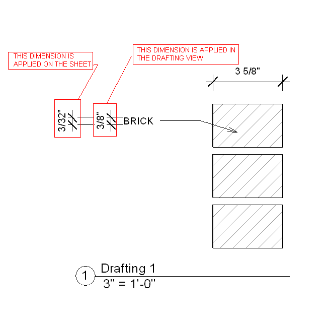

When you say 3/32" you are talking about the size on a printed sheet. In order to get that size you would have to apply a scale factor when you are looking at the view. Keep in mind that the view is set to a scale and the sheet is 1:1, so therefore if you had to manually draw something that you wanted to be a scale of 3"=1'-0" you would have to draw every thing 1/4" the size that it is in real life. Sorry that you don't understand basic principles of drafting.

poplivon ... it does sound like you are an old acad user.  You have to change your thought process.  Text in REVIT is an annotation and all annotations are paper space size NOT VIEW!
This is really a great thing.  You newer have to figure your text size.  Our office standard is that our printed text is 3/32" minimum so that it is always readable.  If we set our text to 3/32 it will always be 3/32 - no matter what scale the drawing is.  You never have to figure out how large or small to make your text in order to meet our office standard.
Now if you want model text .... that will scale with the drawing.

Maybe this will help. I created a drafting view at 3"=1'-0" scale and placed a 3/32" text note on the the view. I then dimensioned the height of the note. Next I placed that view on a sheet and placed another dimension on the sheet view. Notice the difference in the dimensions. Check out the attached image.
