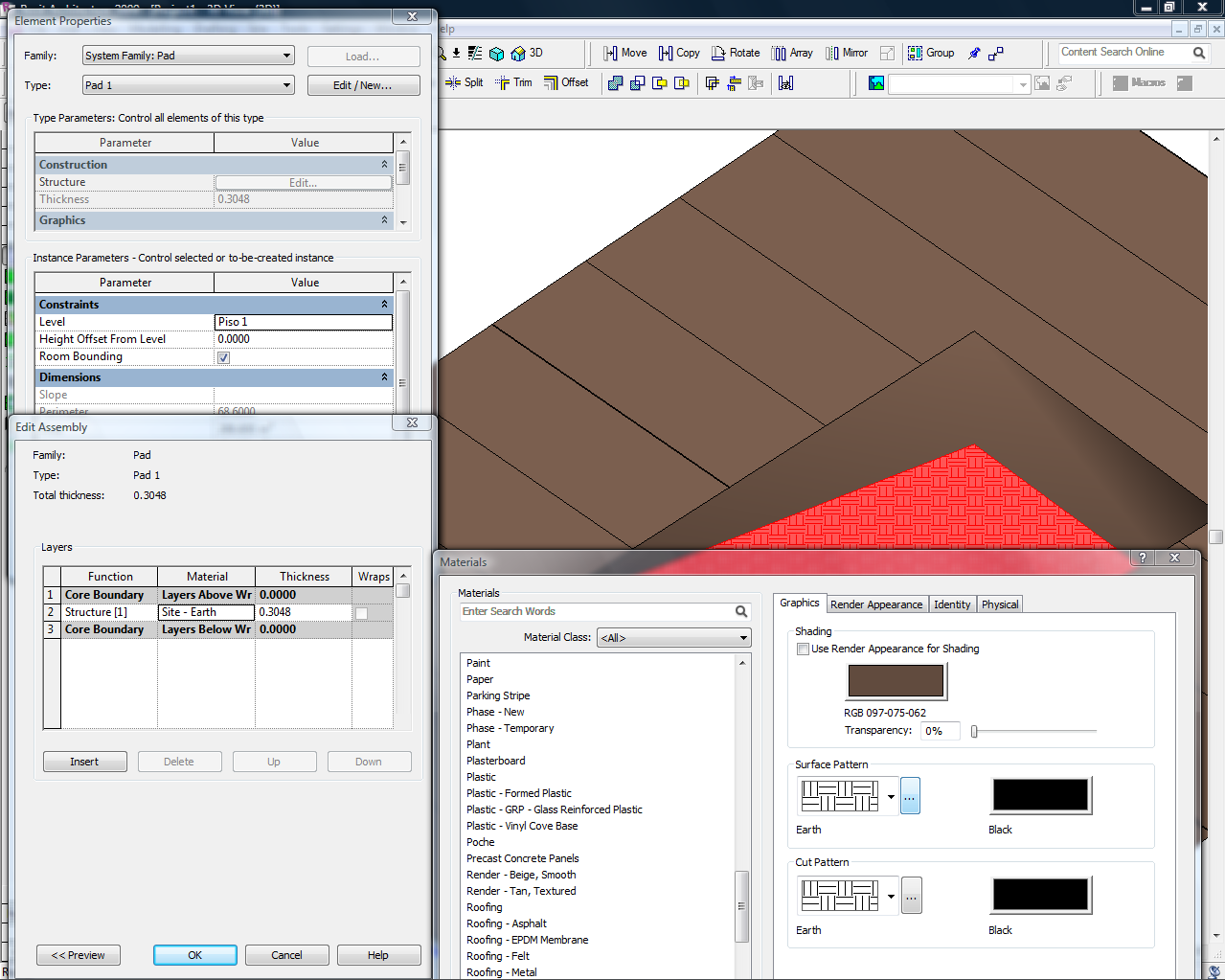

See the attached image. When My plan is cut at or below where a slab intersects with teh topo surface, the plan view does not poche. If I cut through the face created by a pad object the poche will show, but if you cut at or below the line that I have highlighted as "intersection", I do not get a poche of the earth in plan.

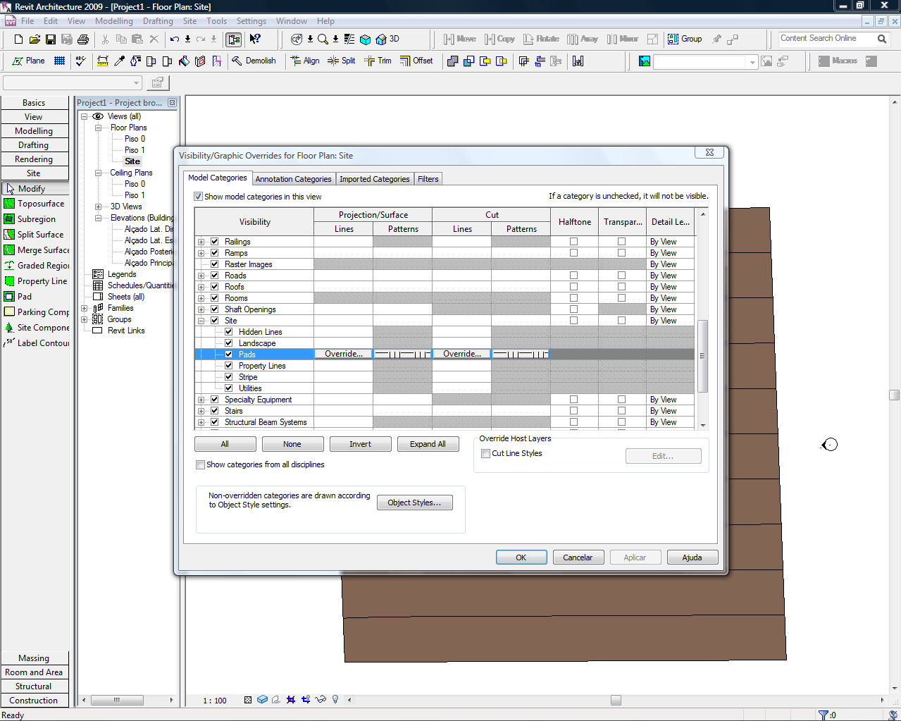

can you put the right image with shade? do you see the pattern in SITE plan?

I don't see the pattern in the SITE plan. See attached. Everything shown as white in the plan to the left beyond the buildings at the right should have an earth poche.

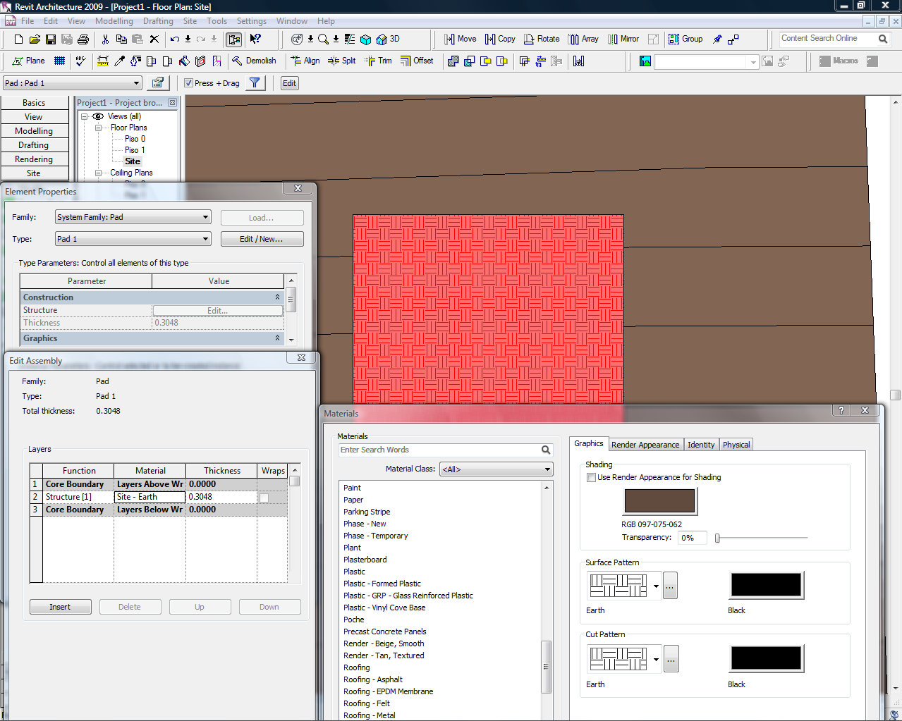

You must pick in the PAD and edit the properties and change the material and the cut and surface pattern equal like the topo site...

Can you see?

On this attachment, look at Level 1. At Level 1, below "pad A" and "pad B", I should get an earth hatch, just like on Level 2 below "pad B". In plan, if you do not cut through the center of the pad vertically, like Level 2 is here, you don't get a hatch.

I think the problem isn't in the "Hatch" in the plan but it's because the "View Range" in LEVEL 1, because in LEVEL 2 we can see the hatch (level 2 is more height than level1) so try to see VP>View Range....
