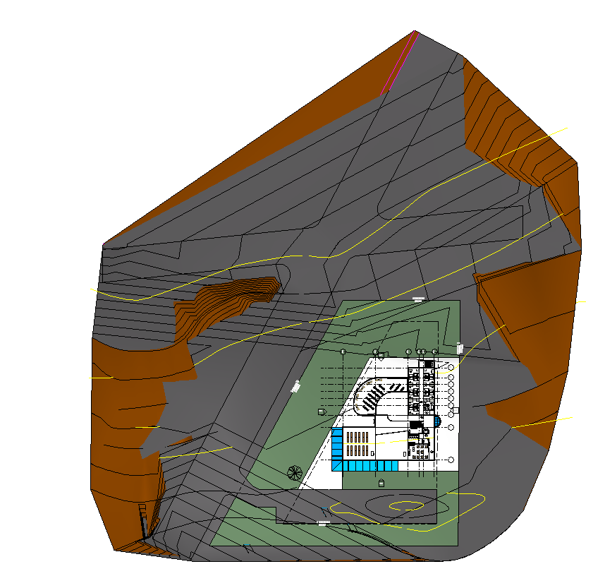

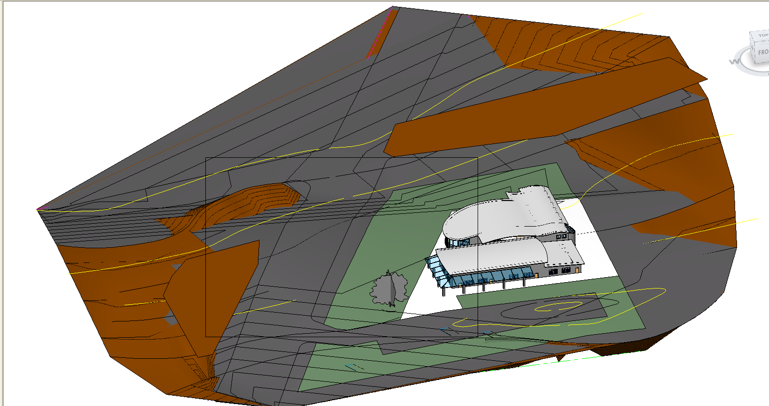

Tyhoon,
here are some pictures of what i have done after going throught the tutorial
createdtoposurface
created subregions for roads, walkways and grass areas
i've set my site plan at 0 level.the site highest contour line is 9500( mm ).
i think i will have to do the pad for the building, parking and walkways so they are cut into the earth..... is this right?
IMAC 3.06GHZ,MACOSX 10.5.6 with WINDOW XP PROF, REVIT ARCH 2009,AUTOCAD 2009,VECTORWORKS 11.0,ARCHICAD 7.0,LEED AP.
Fri, Mar 27, 2009 at 4:37:00 AM | Pad, slab, topo, LOST!!
#14
Joined: Tue, May 22, 2007
5921 Posts
4 Stars: 205 Votes
Hi,
"createdtoposurface" - Good
"created subregions for roads, walkways and grass areas" - Correct
"i've set my site plan at 0 level.the site highest contour line is 9500( mm )." - OK
"i think i will have to do the pad for the building, parking and walkways so they are cut into the earth..... is this right?" - BINGO.... If you don't use the Pad's in your buildings (i.e.) your surfate (topo) gonna appear into the rooms, kitchen and so one, don't put thickness in the pad if you use normal slabs between the floors, for the parking and walkways remember, the PAD it's similar to a FLOOR (SLAB) so you can assign inclinations tor your PAD's if you need... OR sometimes i just use Pad around my building and the rest i change the elevation points like i want and use Subregions and if i need I "Split" the surfaces in several parts to create my final toposurface.... You must see what do you need and how do you do it... You have the tools in Revit so USE IT...

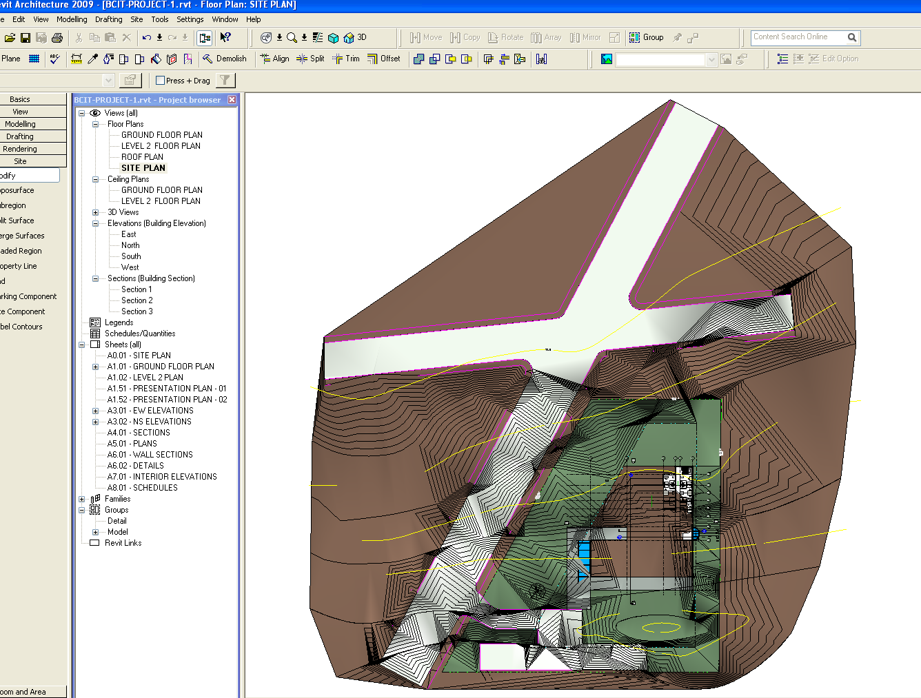

i messed up the toposurface...:-( now that the road gets into the earth. i used the grade region /toposurface/points/window delete the
contour points in the parking, walkway and grassland and this is what i finally got...looks like a mess. i don't know what to do next..i'm
just so tired now ..3 hours in trying to get the site level right .
