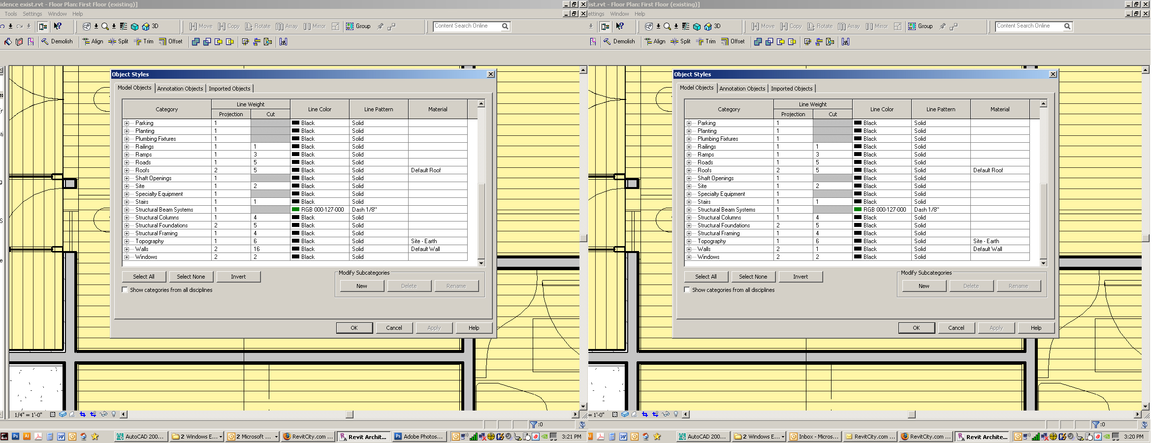

But How does one change the line weights of cut geometry like walls in the floor plan.Mine are really thick and clunky looking.  Ivve tried to use the object styles dialog box, but adjustments to the line weight yeilds no change. THe thin lines is off btw. Ive even tried messing with the line weights dialog. nothing. no change to the display.

go to settings - object styles - walls:
you can set line weights in projection or cut.   Jack it up, way up, to 10 or so at first to see if they are indeed changing.  Depending on what scale your drawing is in, small changes might not be visible.  In other words, once in a site plan that was 1:40, I had to juice up the lines to 7 and above to make them clearly bold and discern between them.

Didnt work, :-(
I can change from 1-16 thicknesses, and nothing changes. nothing.
I have taken two screen shots and you can see my display. and yes I said OK when I took the shot so the settings are in effect. take a look, please this is driving me nuts :-P
the image left side is 16 weight, image right side is 1 weight!
