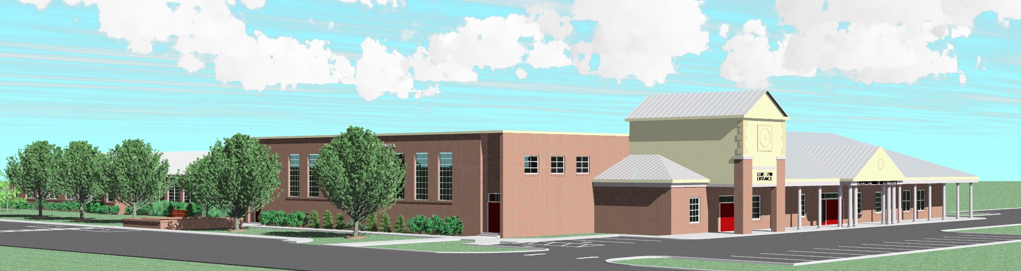

I have followed the steps in creating  standing seam metal roof by changing the roof type to sloped glazing and then adding the curtain grid lines and so on......
I now have a roof that i created as a flat roof and added points to pull the slope into the direction i needed to give it the slope that it calls for....But if i try to change this to a slope glazing roof to add a curtain grid system the roof just goes flat without any grips to grab and pull.
I am doing this for a company that I am interning for and I am the only one that uses Revit here for our model presentation purposes and everyone else is still stuck in ADT....so any help would be greatly appreciated!!!

When I do a standing seam roof, I model it as a flat object, then I hadd an array of a parametric "seam" family.  I think this works a lot easier.

I work for a metal building manufacturer. When i show our standing seam or rib panel roof, i just model a roof like normal and make the material the color i want. Then add 2 set of lines with colors one slightly darker and slightly lighter than the roof color. keeping these 2 lines fairly narrow and beside each other giving it a shadow effect of the ribs. plus that way any changes to the roof the lines follow along automatic.

I drew the lines and it looks great....but they dont show up when i go to render?

Make sure those lines are drawn on the material and not just detail lines drawn on the roof.

I actually ended up mking those lines into a family and extruding them up a 1/2" and it looks exactly how i want it to....Thanks everyone!!

To add linework as CYDER36 says, you must have a workplane so that you can have 3D lines.  A real pain to do if the roof is sloping and if you have more than one side.   I have also had problems with 3D lines actually showing in 3D rendered views.  They don't because there really is nothing there.  If I wanted something like a wire, I had to use a 3D sweep with a profile that had some size to it.
I would do as I suggested earlier ... but if you do get CYDER36's process to work, please let us know.

It did work.....I used the technique of turning my sloped roofs into a sloped glazing roof and then adding a curtain grid system and the mulions as needed
and for the sloped roofs that i created out of pulling grips on a flat roof....i used CDYER36's technique and drew lines on the roofs plane where necessary and then created those into a family and extruded them 1" to look like the mullions on the other roofs

if you look at the image i attached in the previous post you can't really tell a difference in which roofs i used which technique on
