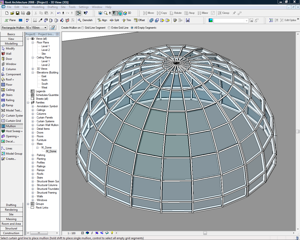

How can I create a dome of glass ( including curtain grid &  mullion )
Please help...
Similar to Attached Jpg..

Hi Bhobho, i can't see very well the image but create a dome like that it's very simple, first of all you must load the dome: "File - Load from Family - Load Family" go to folder "Mass" and choose " M-Dome", then insert the dome in to a floor for example, go to "Project Browser" "Families" "Mass" "M-Dome" pick and drag M-dome to your floor, and there it is the DOME, go to left menu and chose " Massing" then "Curtain System by Face" and select the two parts of dome and in Top menu pick "Create System", now you can delete the Mass and work in the curtain system...

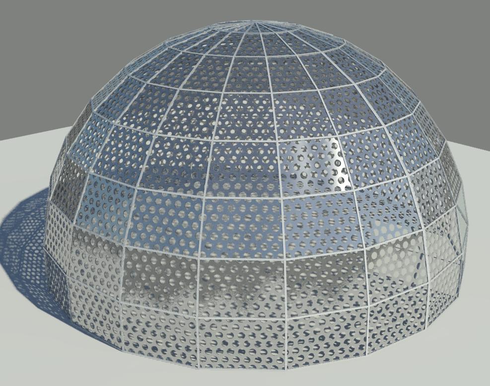

Look the images... the material panel you can put what do you want, glass, metal, etc...

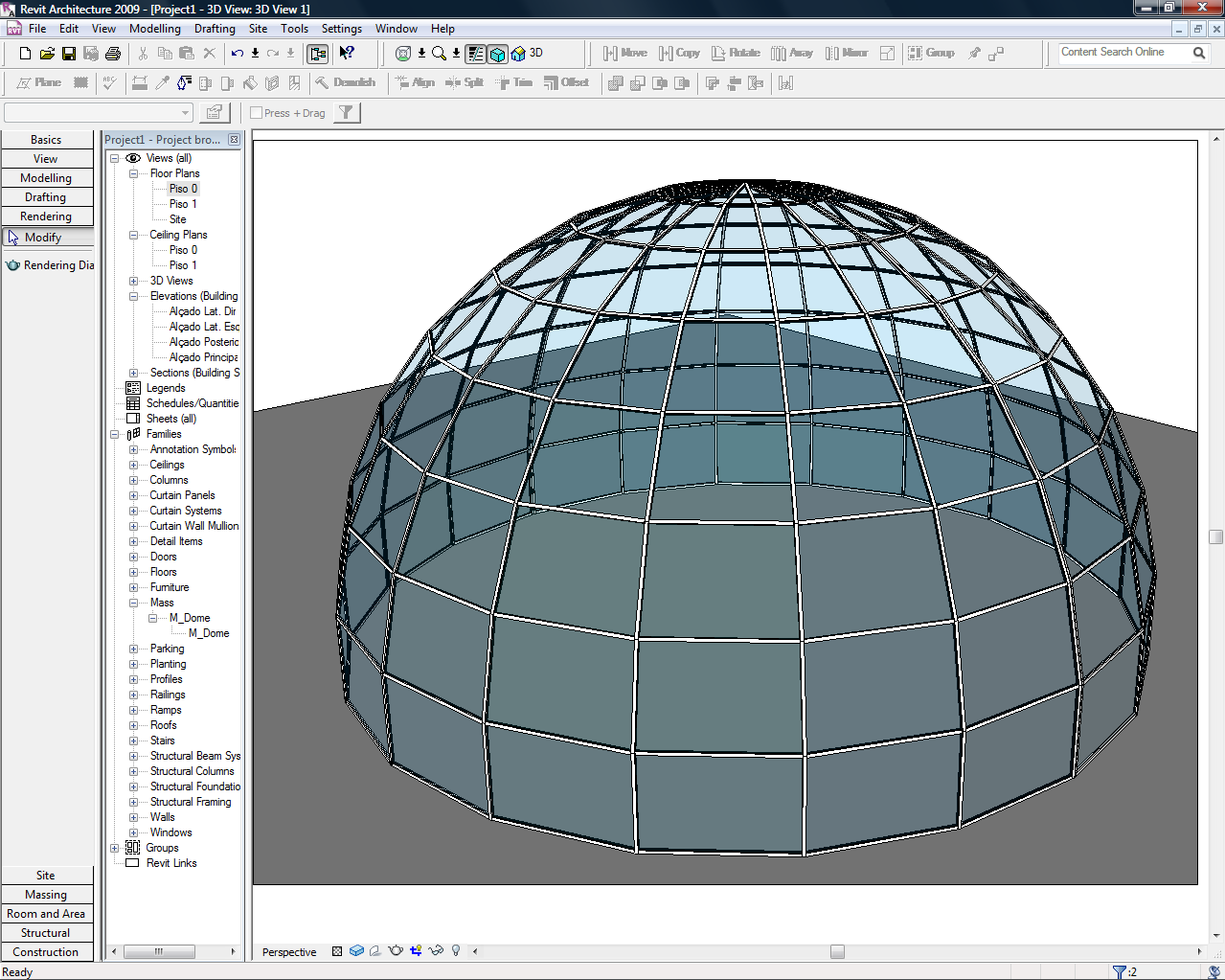

one more...
