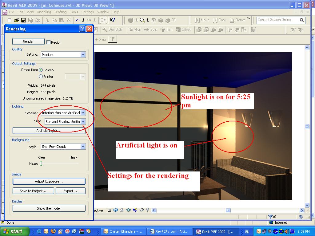

Hey guys do you mean sumthing like wht I have attached to this post please go through it & even the settings & do reply me whether i m right or not

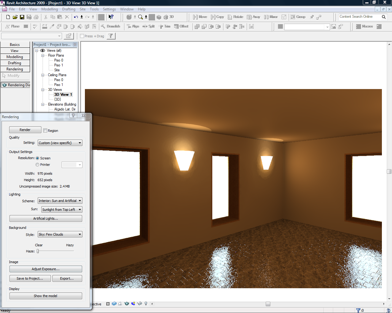

Hi Typhoon, do you mean by daylight is the sun & shadow setting? if it is, Yes, I think the option is only to use sun only, combine sun and artificial and artificial only, right?
Now, the problem is the combine option, that the thread starter (Jzaid84) and I'm facing... that the render result is too dark.. even the dim of all lights is 1. and if I use the artificial only, I can get the bright result of the artificial lighting. so much different from the combination option.
Chiragpklg, I never try interior perspective view to use this combination lighting option before, mabe I'll try later.. currently I'm still busy modelling, after this project done, I'll try to attach my render result about this lighting problem...

Hi VICOZZIO, did you upgrade your revit 2009 with (SP) Web Update..... 1900? with this kind of Service Pack they fix very issues in Revit and lights/render are one of them, so...
Tue, Aug 12, 2008 at 2:51:34 PM | Artificial Lights DO NOT turn on in rendered scene
#14
Joined: Tue, May 22, 2007
5921 Posts
4 Stars: 205 Votes
After Render i just change some values in "Adjust Exposure"...

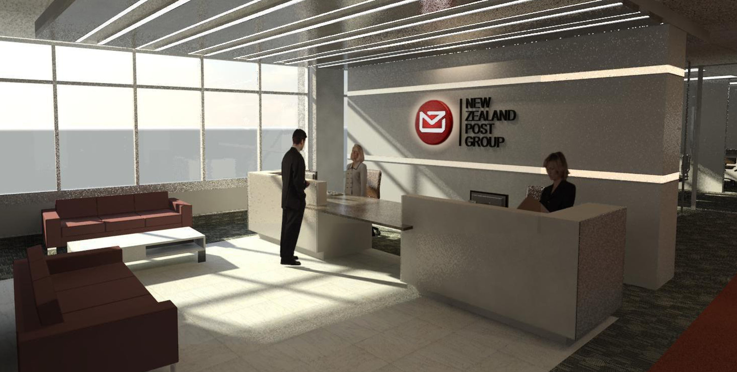

In my experience if you have to adjust exposure drastically you are doing something wrong. We have had pretty good results from increasing the artificial light levels to 250-350 watts and being careful about how many light sources are considered by revit in the model. We have also rebuilt our lights to better suit Revit 2009. There is all the advice you need right here in revitcity. There is one particularly good thread on file size and rendering but I sorry I cannot remeber where. See attached file.
Shaun
