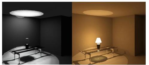

No sure what could be causing this... my scenes render fine.. but are there any surfaces that would be reflecting the tint back onto you white walls?
You could try opening up the actual light family and checking the colour of the light source as well... don't forget the new lights can actually emit coloured light now and depending on the the type of light source.... just a thought.

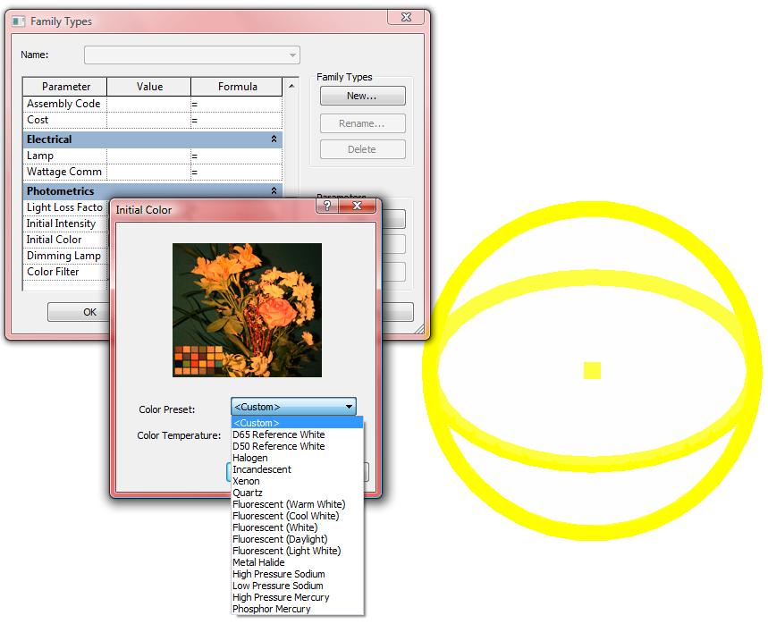

Regarding the warm yellow tint of the scene.  After you process the render, use the 'Adjust Exposure..' button to test white balance, levels, and exposure settings.  The settings in here all take affect without re-rendering.
You may want to change the 'initial color' parameter of your light source as well.  Edit the light families in your scene and change the temperature setting for the light.

What happens if you create a new file with just 4 walls, ceiling and floor.. make all the materials white and then place a single light source and render... do you get the same tinting? take the attached image.. the scene on the left was rendered in 2008 and the one on the right in 2009.. the difference is due to the actual light family, now the lights have more settings i.e. colour so that they give off a more realistic light i.e a lamp of low wattage has a more yellow light. Accurender only ever gave us white light.. I think it could be down to this.

Mmmm this colour issues... I'm not a 'lighting engineer' but different lights do throw out varous colour shades within the colour spectrum and now in Revit 2009 we have the same settings as we have had in Max and Viz for a while i.e. a light emits colour based on the type of unit i.e Xenon, Incandescent, Sodium etc.
In my previous post I didn't mean that the Colour Filter option be used (this allows you to output with pure colour to produce effect such as colour spots etc. which previousl required the modelling of a coloured buld around your light source - a real pain in the ..... now we can just set the colour which is much faster) what i was trying to point out was the type of light source which also alters the light colour:
If you look at a street light the glass is not coloured, it's the light unit i.e the gass etc that give the source it's colour range and warmth e.g. street lamps tend to be yellow / orange or a pinky red colour.
Halogen lights for security and those little spots we all love in bathrooms and kitchens are very intenses and white in colour.
I think that the new light sources in Revit 2009 do give a more realistic lighting than previously in accurender. But that's my opinion. If I model my own lounge up and place the new lights in, then to me it matches the room far better in the lighting, that if i use Revit 2008.
Take a look at the new settings, that lights can have in R 2009. try different colour presets and see what you think.
Finally if you download any of the IES files from companies such as Erco etc, then this also (I believe alters not only the lights web / falloff etc, but also the colour.

Great post. I adjusted the Inital Color in the lighting families then matched the White Balance in the Exposure Settings and it came out perfectly. Thanks again for the suggestions. I am now a believer in the Mental Ray Rendering in Revit 2009.
