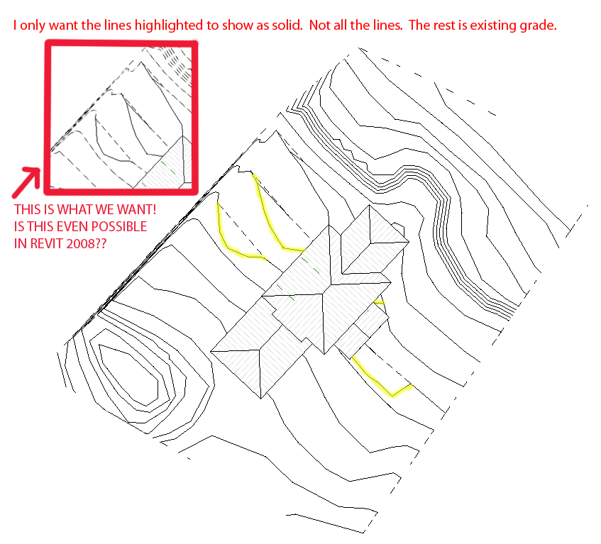

Hello there,
We have been messing with the graded region feature on our Topography.  We have successfully created two topos (one in existing phase and one in new construction phase).  However there is no differenct when you're in hidden line, and you have show all set in your view properties.  You can see both New and Exist. contours, but they are all the same line weights etc.  Is there a way to show the NEW contours as a solid line?  Thanks,

The Problem with overriding graphics in view.  Is when you use the grade region tool, Revit copies the existing grade and creates a new topo in the "New Construction" phase and if I override graphics in view of the new topo, all the contour lines become solid.  The contours are the same as existing where we didn't grade the new topo.
Does that make sense?  What I did in the mean time, was create a small topo without the grade region tool and just overrode those graphics to be solid.  But if you use the tools Revit provides to creat new vs existing topos it doesn't work the way it should be.

Does anyone know how to show the CHANGED contours as dashed??  when we use the graded region tool, it copies the existing topo and has the exact same contours, co then they are solid on top of existing.  I just want to show the changes in contours that changed around the house, not the entire topography.

If you did the graaded region as a phase, you should be able to override the linetype.
Select settings / phases - select the phase you have graded in and pick the graphic over-rides for the line type.

That is how we have been using the graded region tool.  We use the phase filter and add the new contours as solid, and existing as dashed.  But the problem is, say I have a topography of 5 acres.  Now I make that topo existing phase (dashed).  Then select the graded region tool & automatically it copies the 5 acres in place and allows me to change points and elevations and whatnot.  Let's say I change the points only in 1 acre of the topography.  Now when I finish the new changed topography the rest of the 4 acre contours are the same and there for are laying on top of the existing topo making all the lines solid (because the new phase is solid lines).  Does that make sense?  All we want to see is how the contours in that 1 acre I changed show up as solid. The rest we want dashed, because they're existing.
Take a look at the image.  I did the steps above, then made the new topography as transparent in order to show the dashed lines below.  But you can only see where I changed the lines, not the rest of them because the new contours are laying on top of the existing.
Am I making any sense?  Or just digging a deep hole?

Although I think REVIT is showing it right - finished grades are all solid (even if there is no change). Try splitting out the area you are grading first. REVIT seems to thik the split area as a seperate topo. Then grade that area.

If you use the phases, existing will automatically show as dashed and new as solid.
