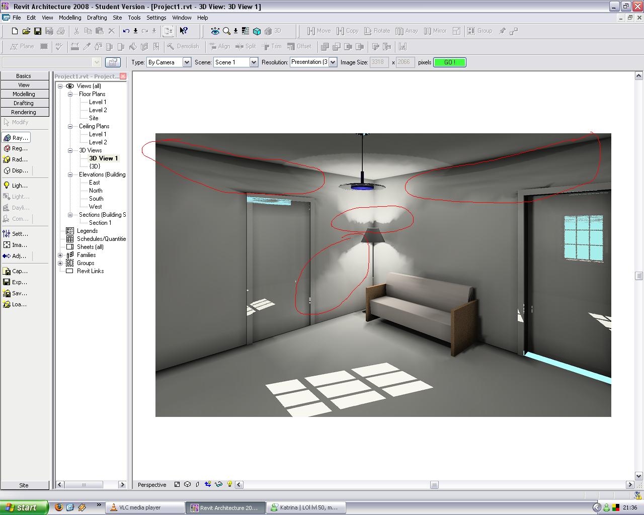

i have a problem with Radiate..
When i Radiate, the light looks wierd.. the light on the floor looks good, but on the walls and ciling it doesnt!
You can se the picture..
 Anyone know what to do?
 Rasmus

OK RASMUS, this problem appears several times when you don't follow some rules: 1º - you must join your walls each other and join with the floor and the celling, use "JOIN GEOMETRY and EDIT WALL JOINS".
2º - After this, you must radiate several times until your "Residual" goes to "0.10 or 0.15", it takes several hours (depend of your hardware) in Revit, if you use 3DS MAX or VIZ it's faster but in this case (Revit) you have to be patient...
Follow this simple rules and in the final you have a realistic Render... Enjoy.

i still have some problems with this... i joined the walls and floor and ceiling, but there are still some problems with the shadows from the Sofa, its very pixilated? i dont know how to improve the shadow quality

Attatch the image, what's the final residual radiate?

i look like the picture already atached, the residual was 0.07

I don't no man, are you working with SP3 installed? with 0.07 residual must be fine, are you render with 300 Dpi?

wierd.. sp3? i dont hink so.. i work with Revit 2008 Architectual.. well.. thx for trying, i will work with it for some time.. And MAKE it work..

Rasmus, Autodesk launch 3 Service pack for Autodesk products including Revit, so, you must install Revit SP3 and i think your problems are solved...
